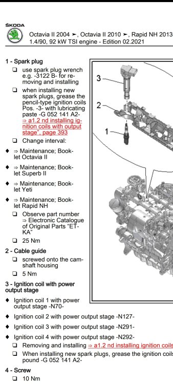

What’s setting for torque in this engine? 25nm??? Or depend of spark spec?

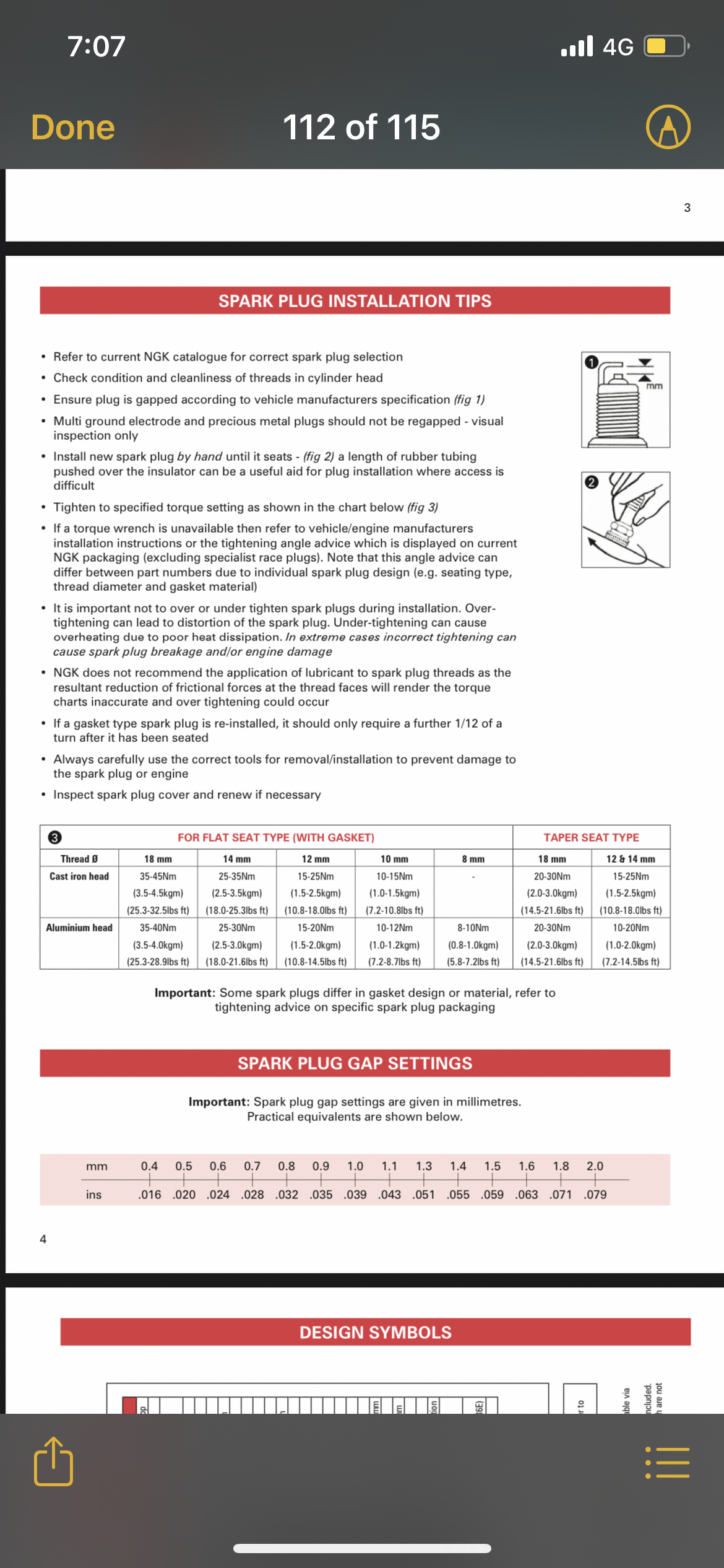

Usually bottom out and then 1/2: to 2/3 turn. Usually written on spark plug box.
25nm is correct for CAXA

Definitely not! You risk some major issues doing this.
Spark plugs have mostly done away with the crush washer and instead use a conical seat now. Torque settings can be as low as 10Nm on some cars now and the top end of the scale is 30Nm or near enough. Doing a half turn or 2/3 of a turn can completely overtighten them. Heads are getting even thinner now and I wouldnt want to be the one that pulls the plug out the head.
The second thing is, the spark gap is positioned on newer engines with millimeter precision to create the best burn with direct injection engines so over or under torquing will place it in the non optimal place (difference will be negligible i know)
The last thing I wanted to add is, had a new Volvo XC90 in the workshop that was serviced and the tech torqued all his plugs on all makes and models to 35Nm, the porcelain broke off the end of the plug as it stretched it too far and destroyed the engine. Torque setting should of been only 20 or so. That small difference cost a whole lot of cash.
Just my input that telling someone to just give it a good nip could cause massive issues and them issues wouldnt come back to you, it would be the poor forum user that has possibly caused massive issues by not following precision advice for that specific car/model/engine.
My first experience
All the ngk plugs I have replaced on vw and skoda over last 10 years are a flat washer gasket design. You can use the torque spec but equally on the plug packaging you will find the rule of thumb regards tightening after bottoming.  Look at the instructions on the plug packet. If you have the mfr service guide and a torque wrench by all means use that.
And when working on cars or any other me mechanical device you have to pay attention to the type of fastener you're dealing with.  A torque wrench for example doesn't stop you cross threading. If I am following a rule of thumb I'd also be judicious if it felt too tight.
