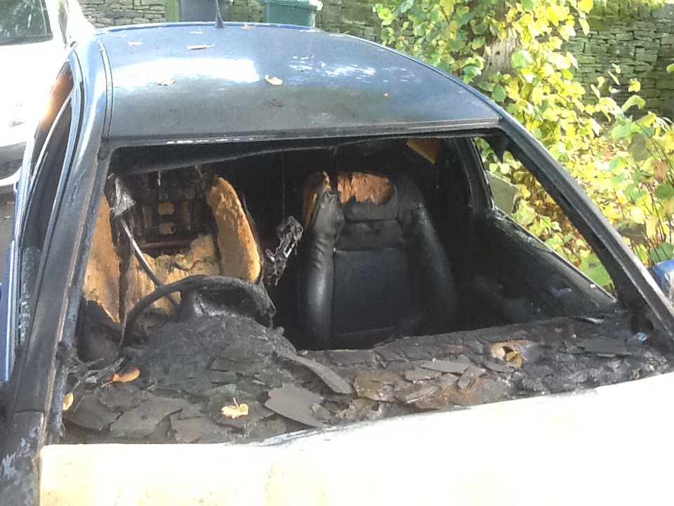

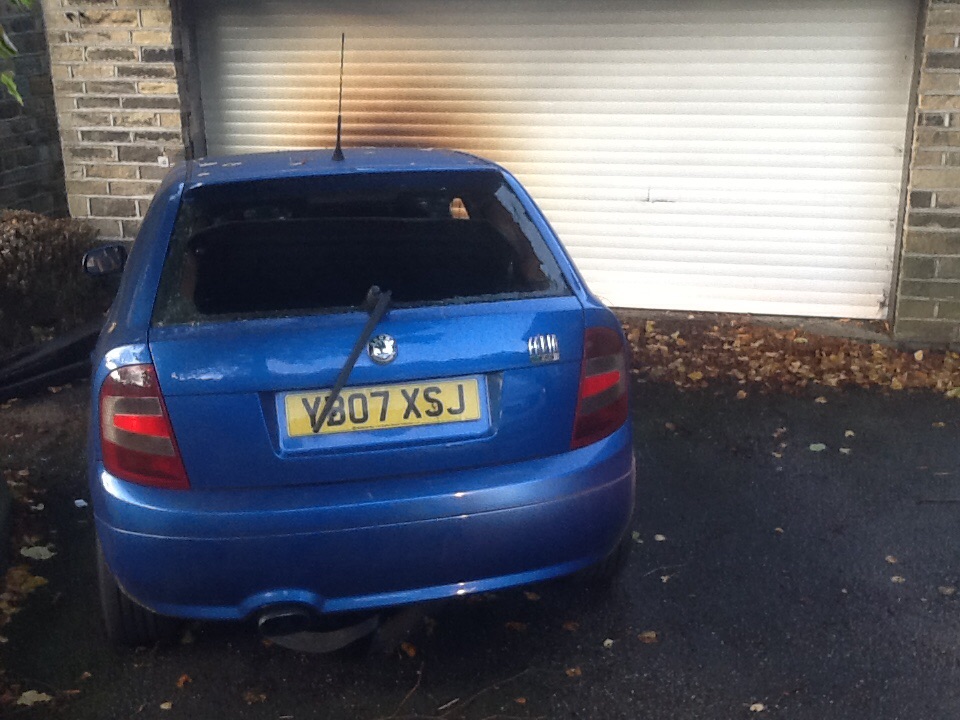

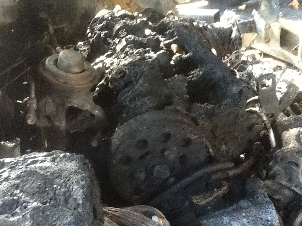

Here is a picture of aftermathpost-122520-0-97972200-1413667212_thumb.jpgpost-122520-0-83202900-1413667256_thumb.jpg
Wow, looks almost like someone tried to trash it with all the glass broken / bonnet folded up etc but assume the heat did that, or the fire service did.
Yikes.
How did the bonnet end up like that… it look like crash damage?
Thats awful - sorry to see. Hopefully the insurance cover it - but begs the question of what was the cause?

The fire service did break the windows the bonnet buckled no crash damage had been running well returning 65 mpg and performing well. My wife had used it that day to travel 3 miles to the supermarket parked it on drive 10 minutes later there was a loud bang the alarm went off and flames were coming out from under the bonnet .the car was a deisel vrs so any clues dealer and Skoda uk have not got any ideas at present

I am not sure how, but the only thing I can imagine is somehow a fuel pipe maybe popped off somewhere and sprayed diesel on to something red hot like the exhaust manifold?  Has it had any kind of recent repair work to fuelling, oil lines, or similar?

I owned the car from new ,no modifications ,I have nobody who would want to firebomb me to my knowledge the incident witnessed by neighbours after the bang I suppose it may be possible that the fire had started during the drive and continued smouldering but my wife who drove it that afternoon had not noticed anything when she took the shopping out of the car and came into the house. I was not present till 8 pm that day as I was returning from London so the car was burnt out when I got home but I normally drive the car and it had been fine on Friday ,the car exploded on Sunday. I suspect some sort of electromechanical failure myself but what?
Being a Derv I really can't see anything that could catch fire in the engine bay.
No evidence of fuel leaks eg oil on drive or at parking spaces at work no increased fuel consumption no strange noises. Could the fuel pump compress the fuel so that the pressure was high enough to explode?
It's got to be something electrical that started smouldering and then eventually caught fire.
Hmm must've been a pretty bad wiring issue as I drove mine back 6 hours of driving with a half melted loom
I wonder if a lose loom fell onto the engine causing a short that started the fire
The fuel pump is mechanical and runs off the camshaft, so not unless the engine was running no. My guess is someone started the fire on purpose. Could have also been a wiring fault or the battery giving up. Stranger things have happend.
