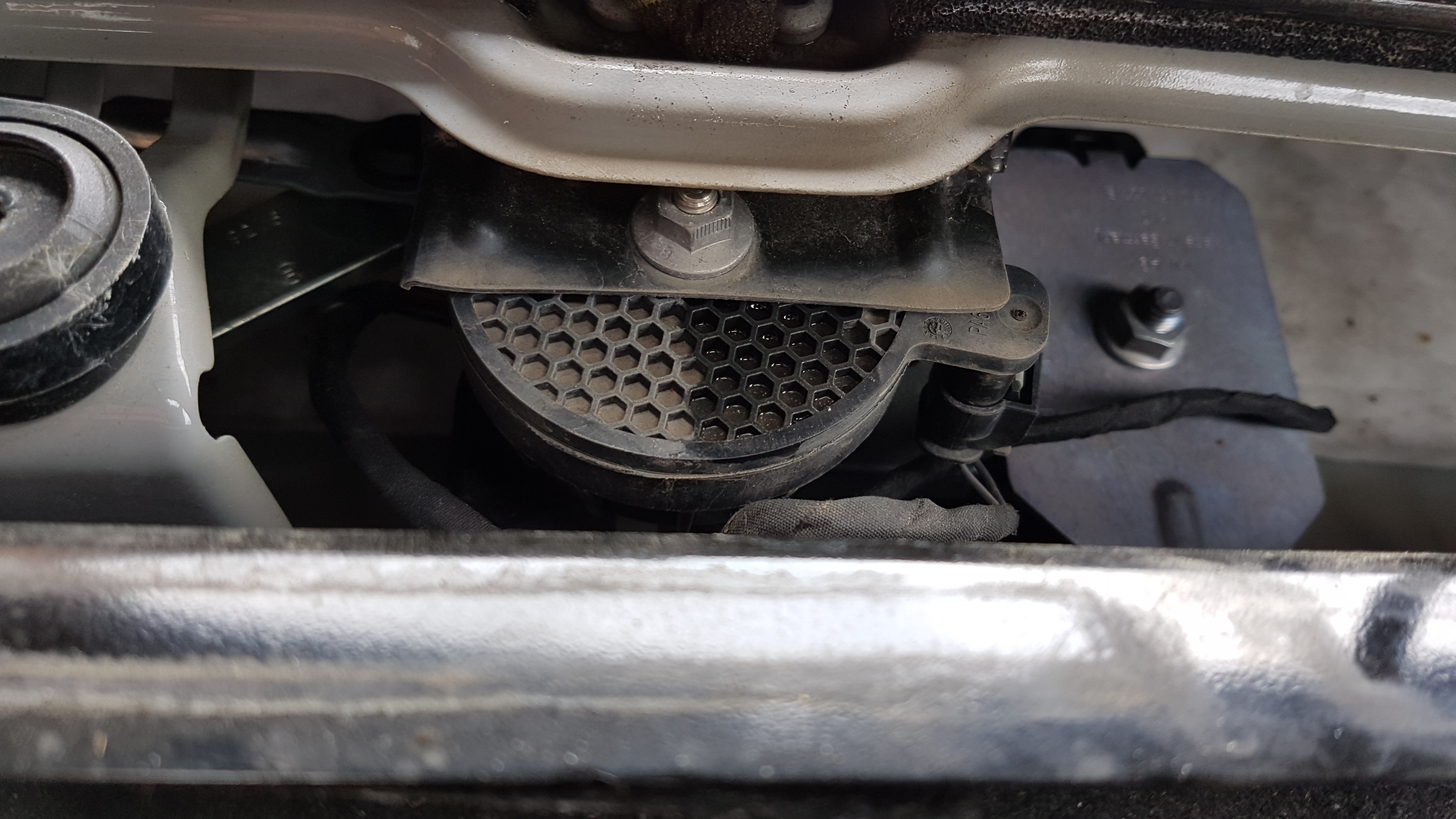

What is a noise generator???
This:
Under the scuttle panel, in the centre of the windscreen.
