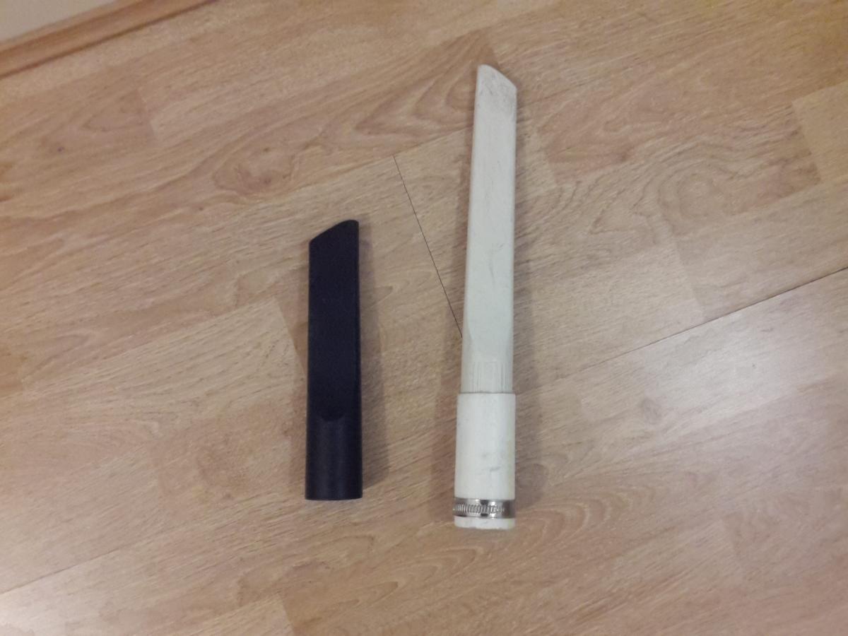

If you only want a super clean, it would be cheaper and quicker to buy a long, thin crevice tool for your vacuum cleaner......

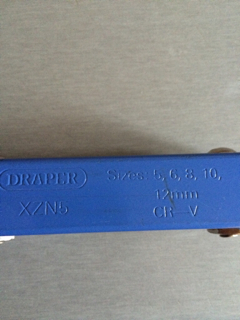

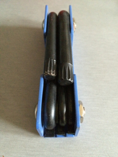

I use this from draper cost me £6 from local hardware shop I've used it on both Mk 1 & 2 Fabia's
These are my crevice tools for vacuum cleaner, I too have used them on my sons' mk1 Fabias as well as my mk2.!
