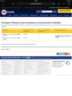

Hope you don't take e fuel through the tunnel, as that's not allowed!
As in this tunnel?
It's allowed
