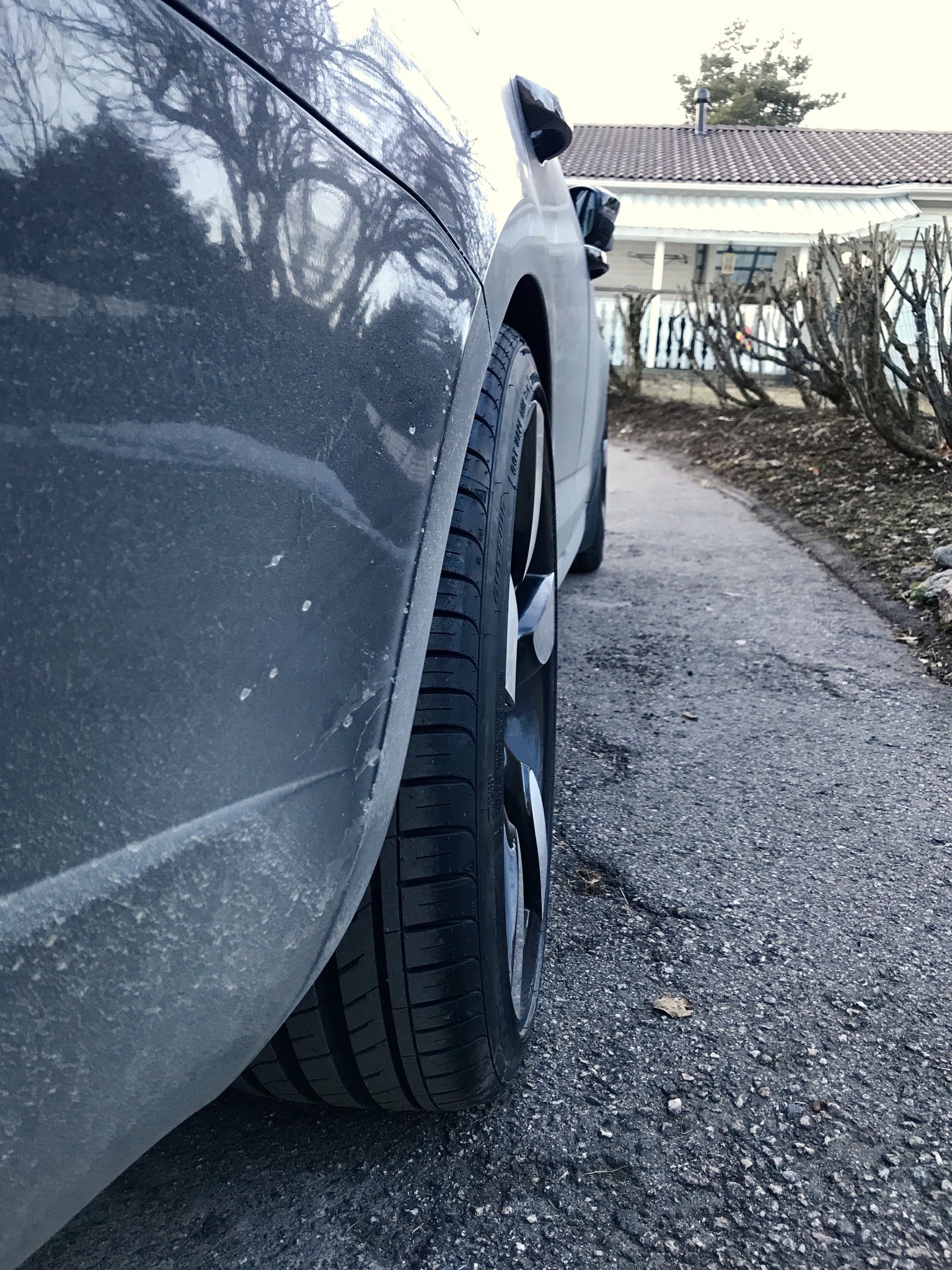

Has anyone fitted 19x9 wheels on octavia? It should fit on back just fine, but how about front?
19x9 et33 audi oem rotors would look good.
On 26/02/2019 at 08:36, Vilho said:
i!
I got 19x8.5 with ET37 all around on 235/35 tires and it is the max I would go.
Your setup will be 2.4mm wider so your might get into trouble then again it really depends on tire profile and ride height.

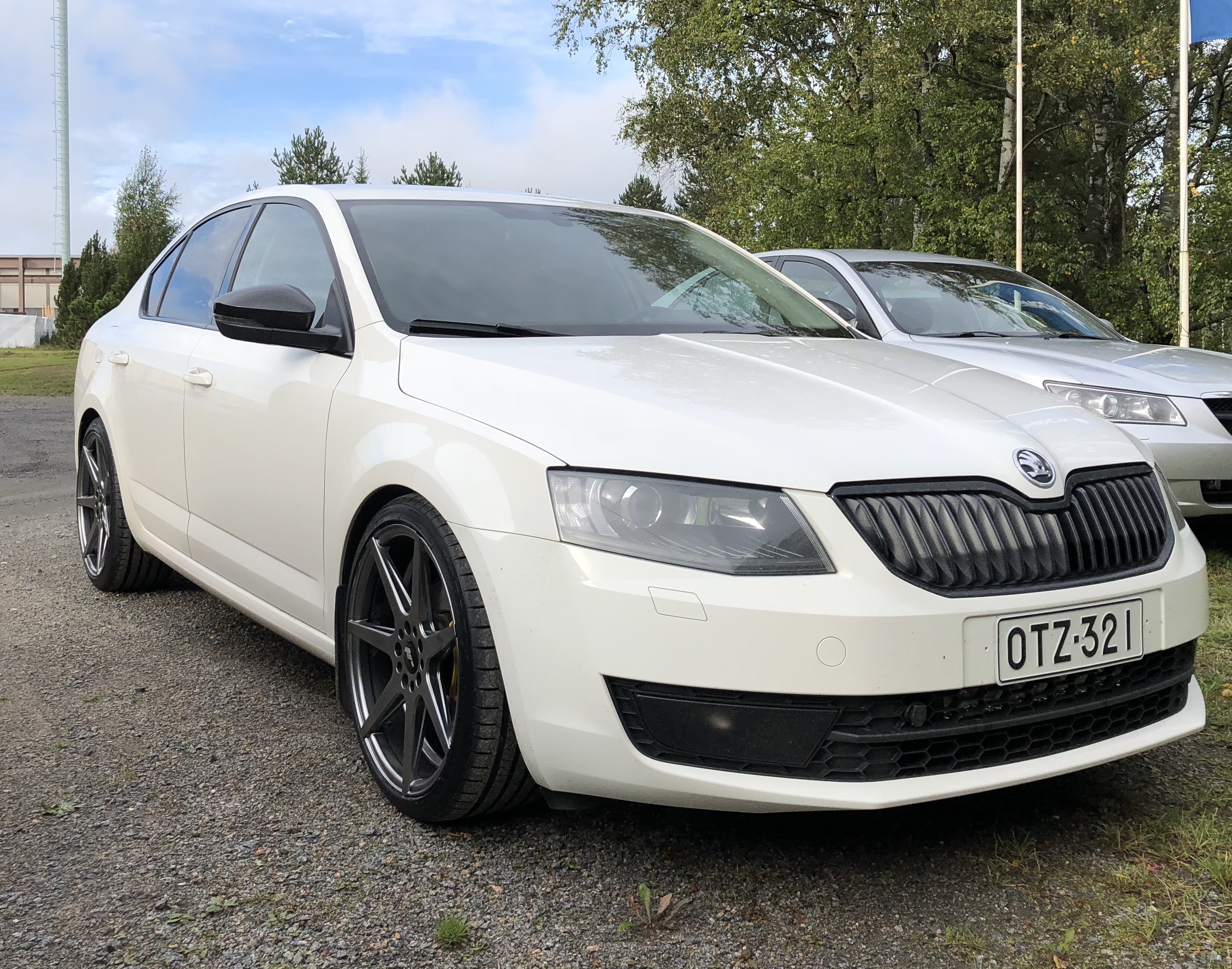

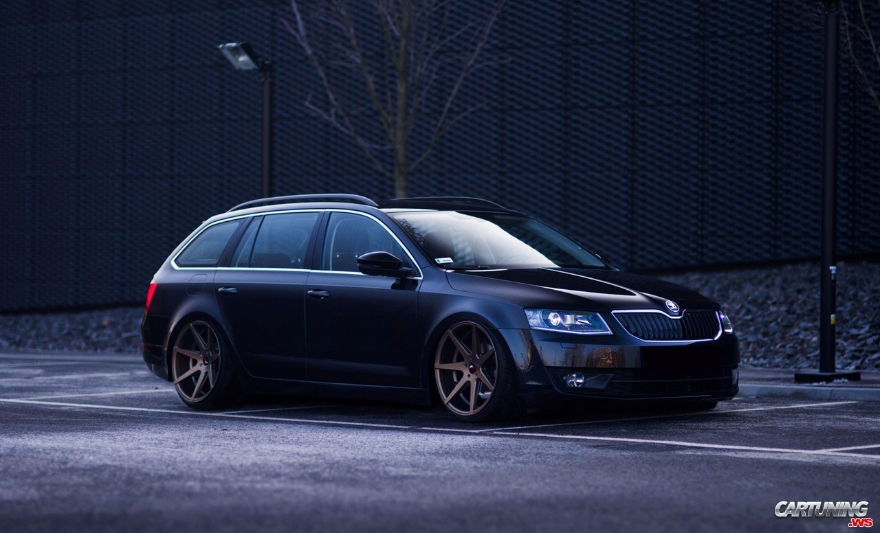

Anyone got any pics of a Octavia 3 on 19" or 20" Audi Rotors?
and does someone know which wheels are under this one
i saw a meteor vRS sedan with deep concave 20" rotiforms today but i wasnt quick enough to get a pic. i was quite impressed.
Edited by JohnnyType2
Looks like Japan Racing JR20.

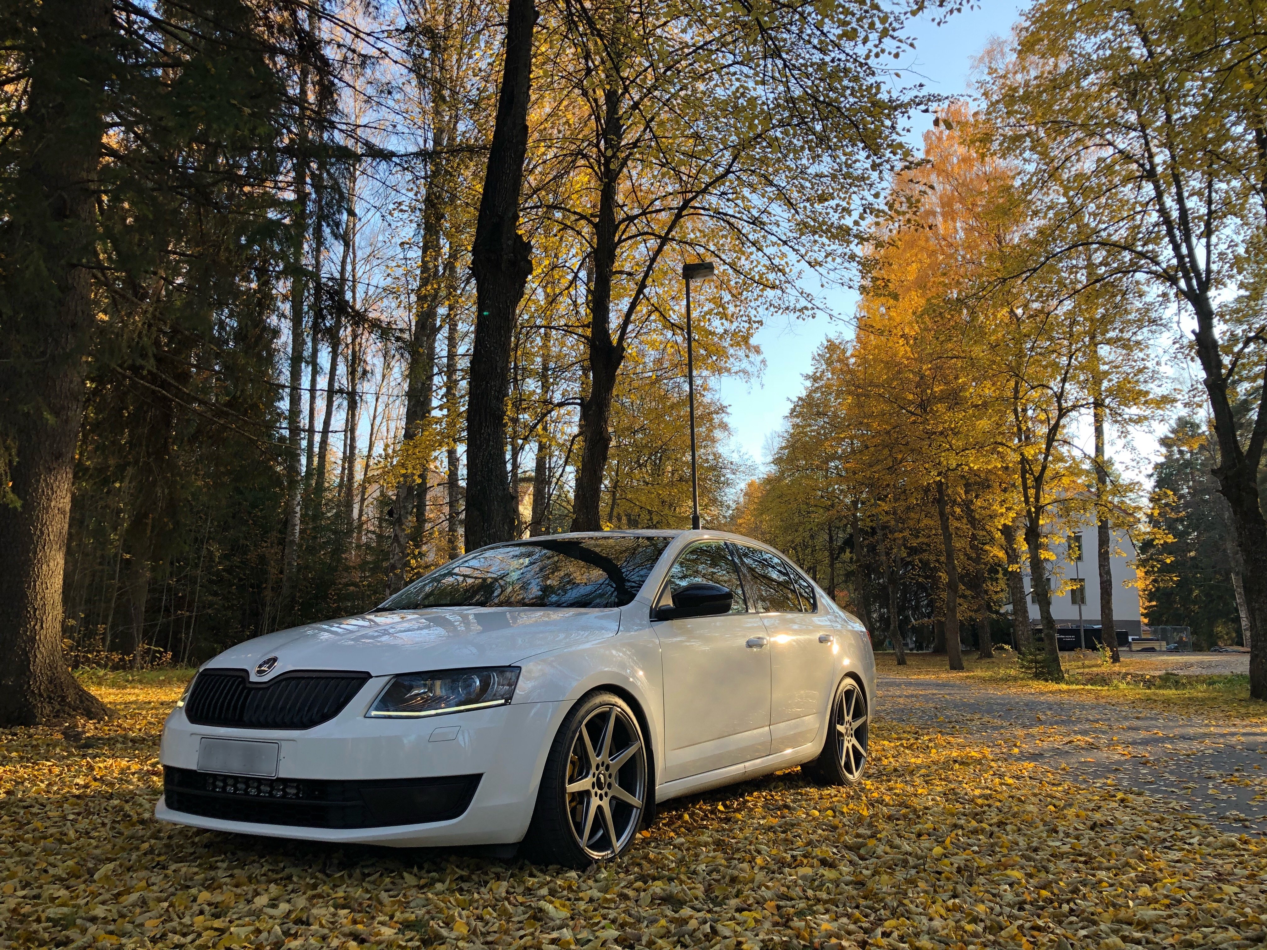

I have pre-FL liftback vRS with Eibach springs. Current setup is Japan Racing JR21 18x8,5 ET40 with 225/40 tyres. Been thinking about updating to 19 inch instead. I'm guessing 19" would fill the arch gap a little better? Of course it depends on tyre sizing vs rim width, but in general.
Edit: here's a picture... (couldn't find a better one now sorry). As you can see there's quite a bit of arch gap still. Maybe those Eibachs didn't bring the car lower enough to look clean. Idk if it would just get worse with 19" or look better...
Edited by hypo

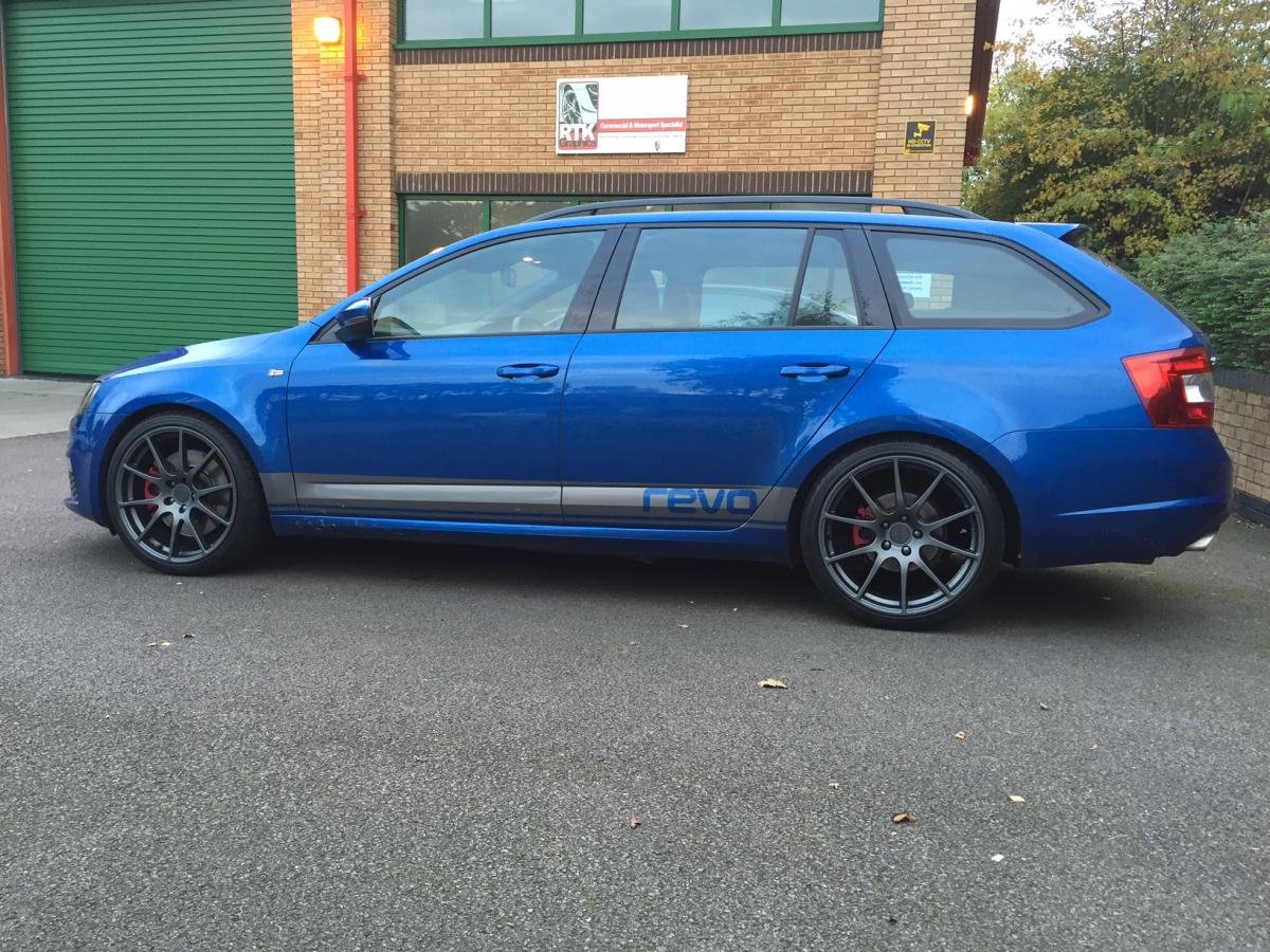

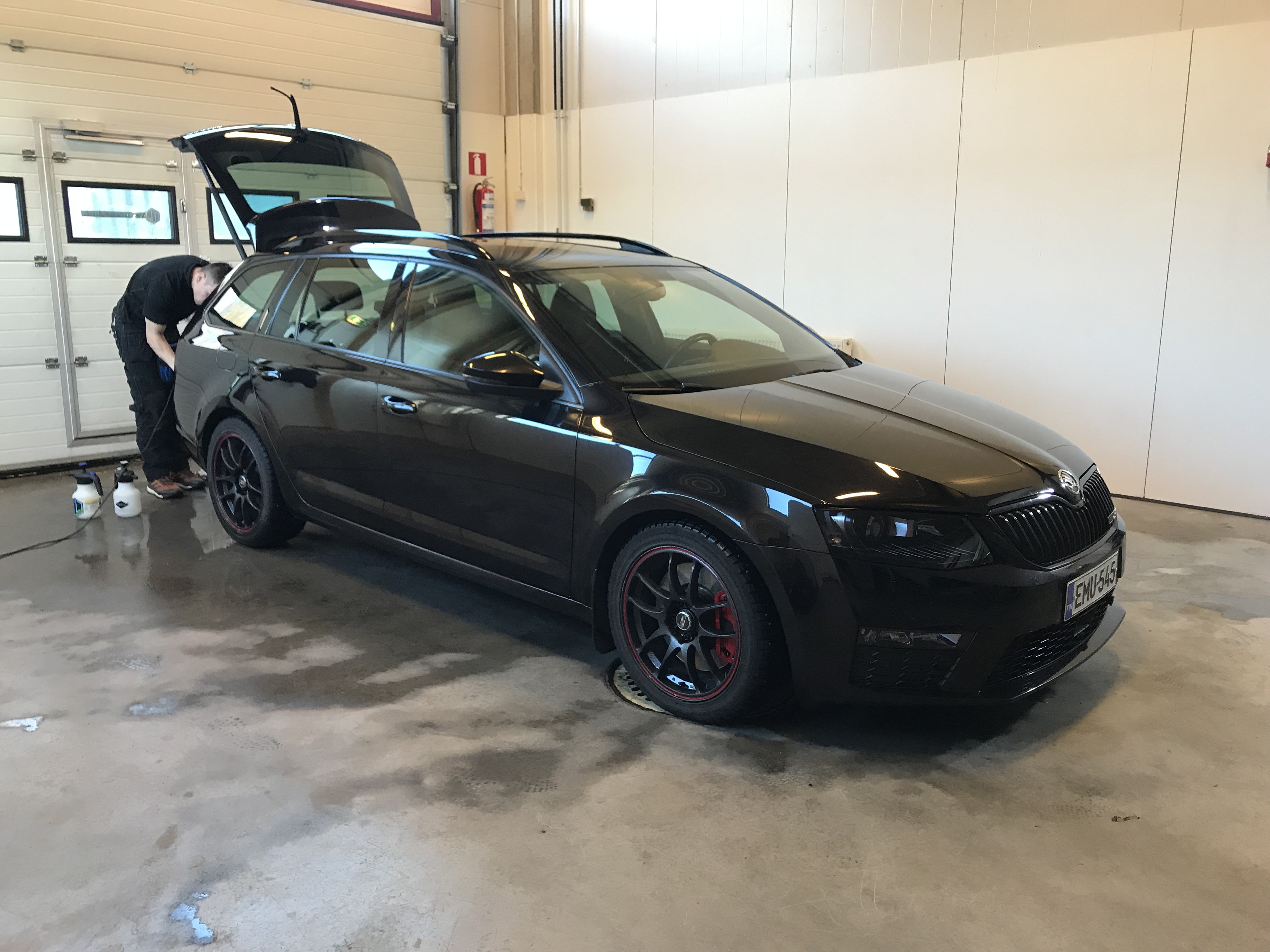

Heres my black vrs on 17x7.5 with 225/45 tyres ET37.
And another members blue vrs on 19x8.5 with 245/35, Et45 I remember. Eibach prokit springs, fits fine.
@maxxxi and @Vilho
Yeah actually saw Vilho's picture through google earlier :D Looks good. From what I have seen/read it seems like Eibach pro-kit drops estate well (as can be seen on @maxxis pictures) but maybe that's not so much the case with LB... Eibach Pro-Kit drops vRS only 20mm front 10mm back. Guess I made a mistake and should've gone with Eibach Sportline or H&R instead. If I remember correctly though H&R is 20mm front and back for vRS so front should be same with Eibach Pro-Kits.
Btw 245 tyre sounds pretty wide on 8,5" rim. Usually it's 225 or 235. Did you mean 235 or is it really 245? :)
I played a bit with willtheyfit.com. If you change 8,5x18 with 225/40 --> 8,5x19 with 235/35 it would fill the arch gap about 5mm. But naturally also ride height will be 5mm more :D With 225/35 tyres the difference would be less than 2mm... Buf ofc 19" in general looks better in a pretty big car like Octavia.

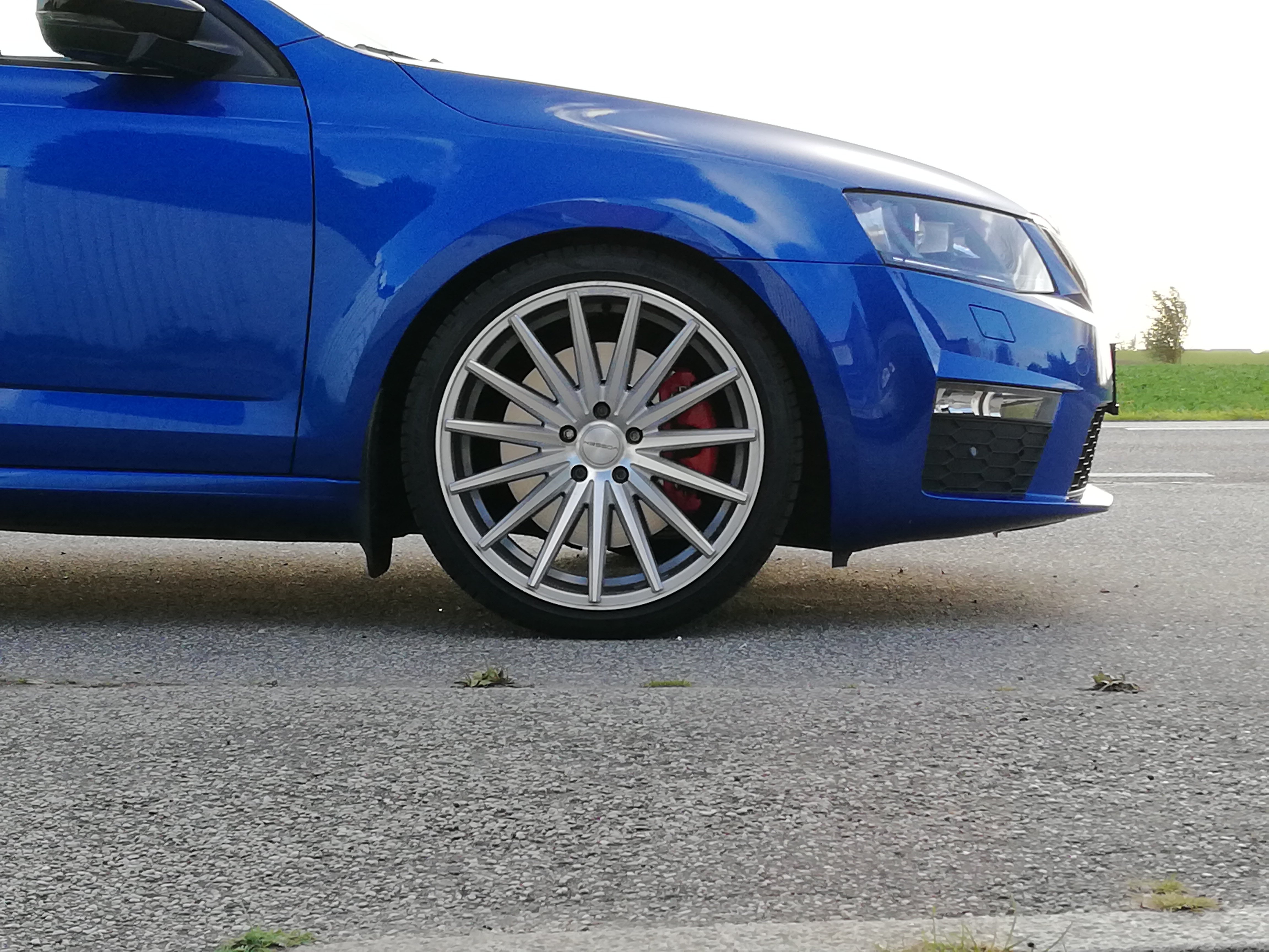

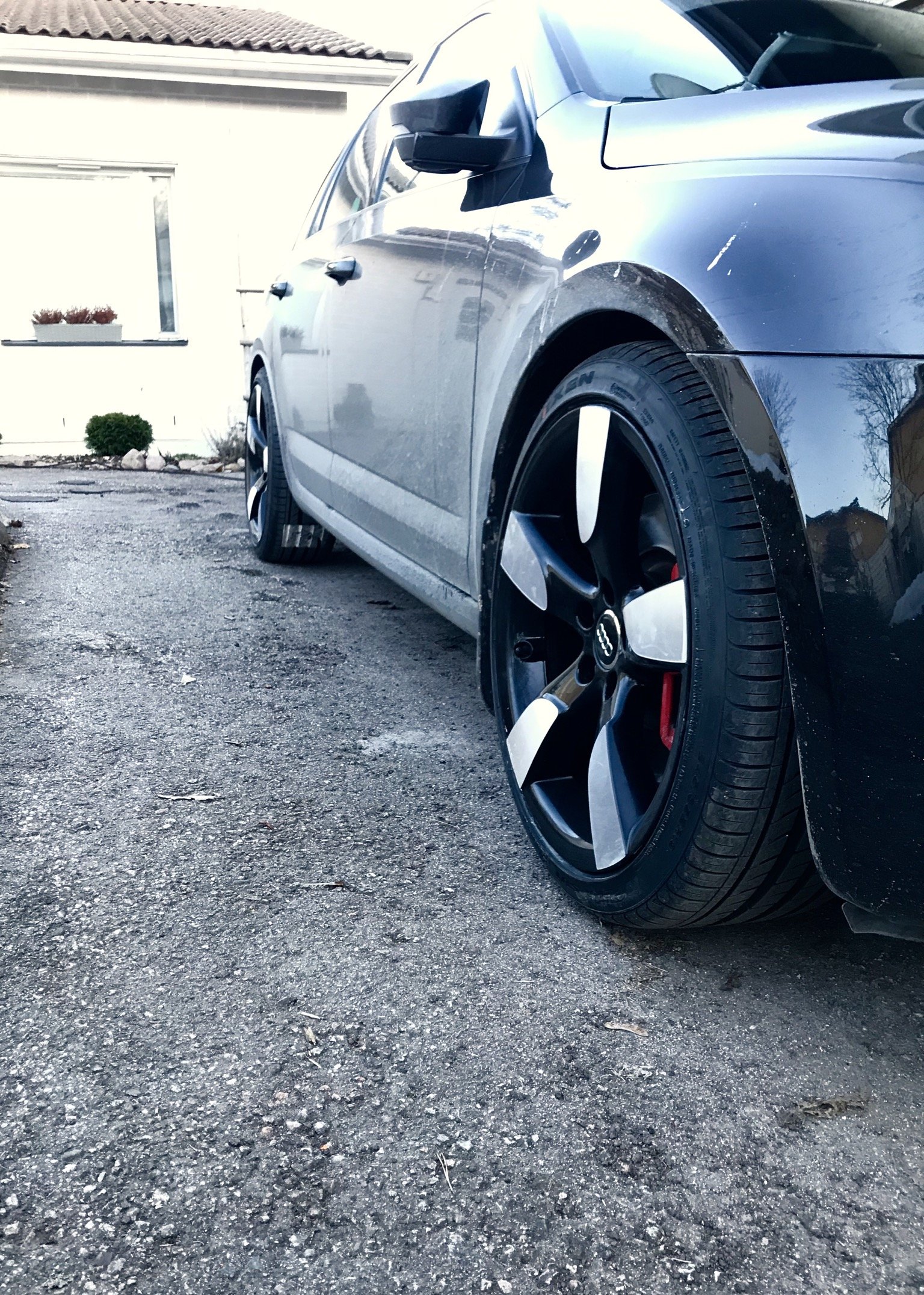

245/35 Is actually what Audi recommends on the 8.5 rims. I like a little sidewall and extra protection for the rims, and It looks great, the 235’s will be slightly stretched.
The dude I bought them from had an S5 which had them stock from the  factory with 255/35, but that looks a bit too fat imo.
Heres 245/35 on 19x8.5:
@hypo @maxxxi

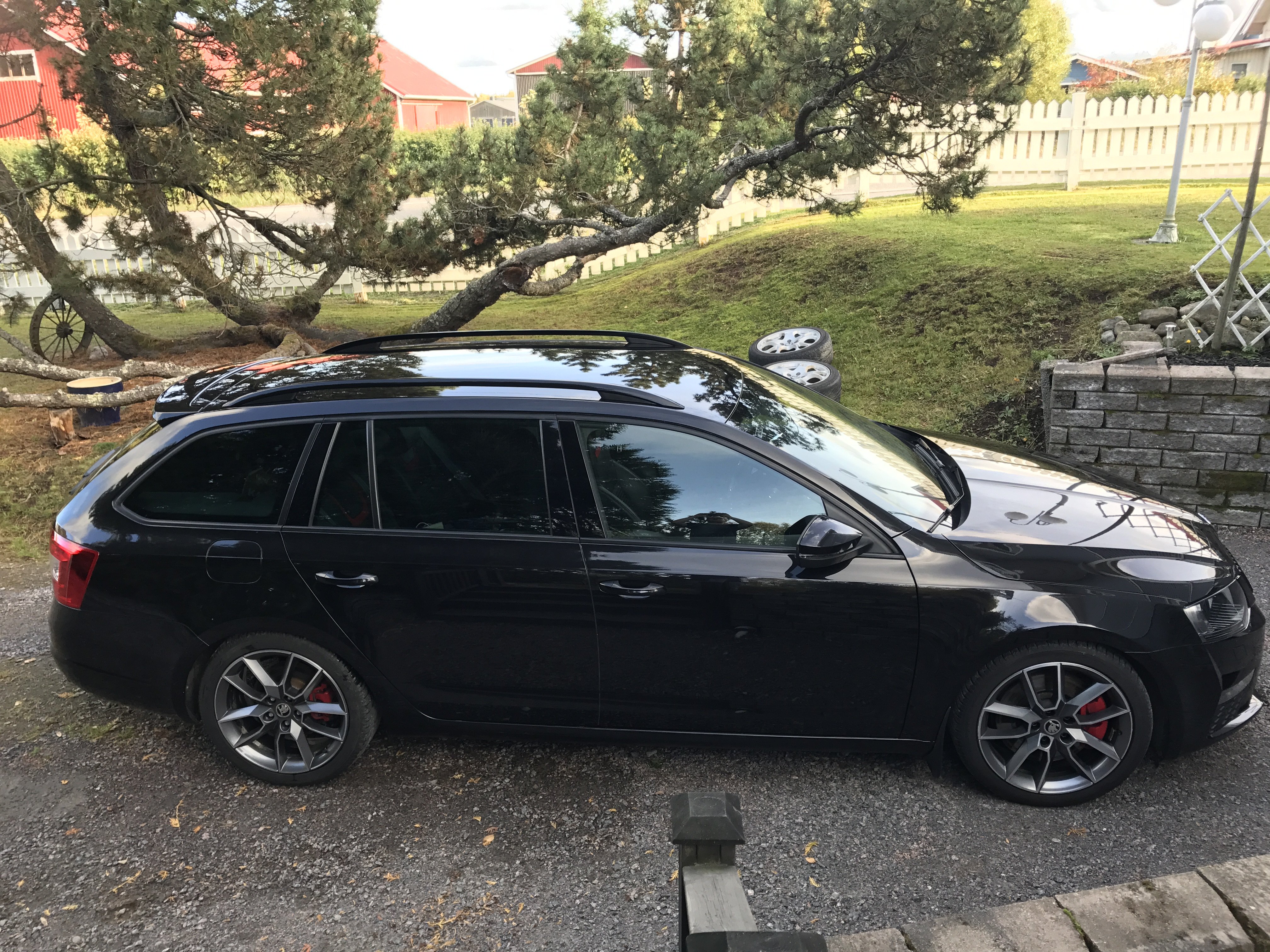

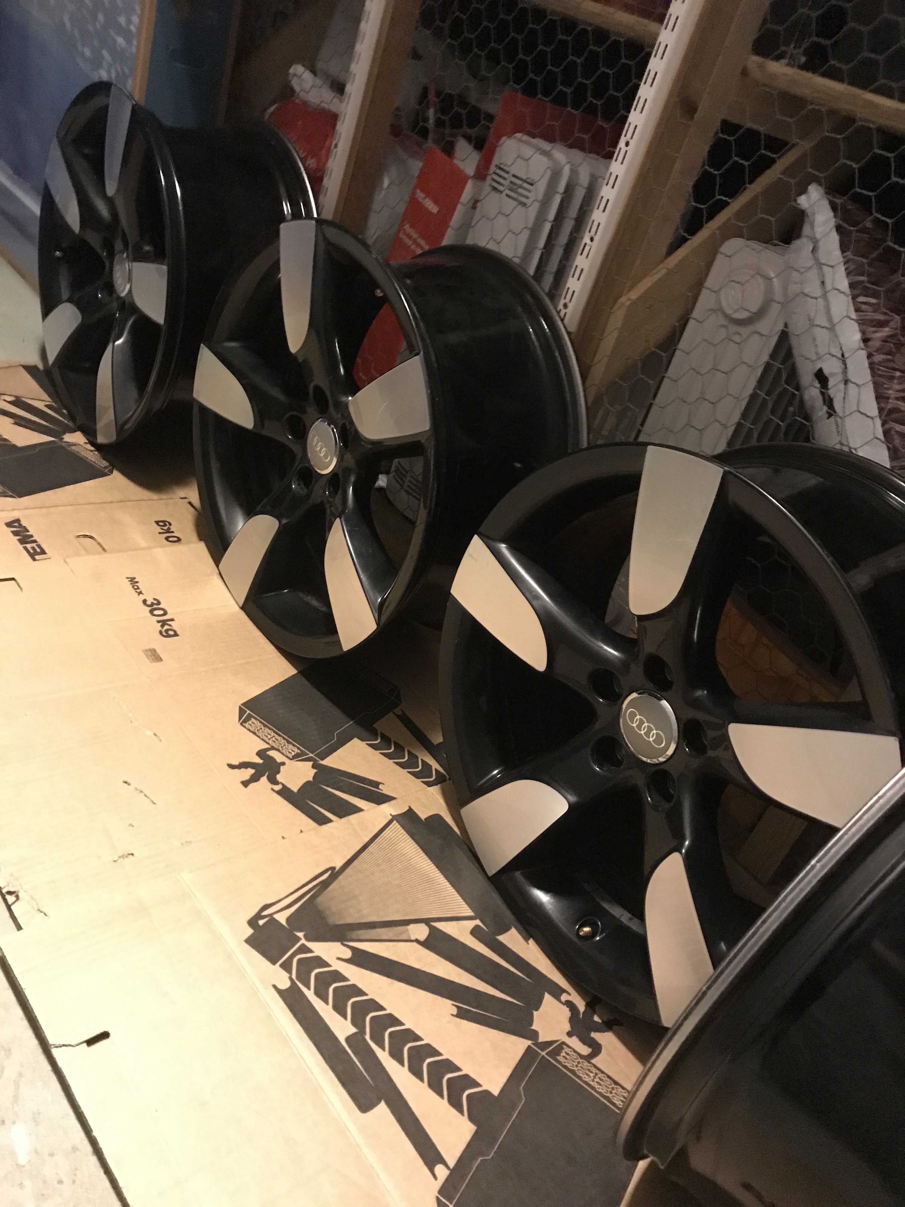

Here is more pictures of my old wheels. 235/35r19 tyre setup worked well in 8.5 wide rim.
@Vilho @hypo

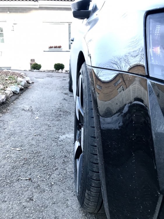

I got the wheels fitted today, 245/35 R19 all-around ET43 with 12mm spacers In the back, fitment is perfect imo. B)
Really happy!
heres a sneak-peak, excuse the dirty car :giggle:
Back:
Front:4E4A1D29-E1D8-4C32-9553-7CBD7C8B5D46.thumb.jpeg.6fdb4db9d9c504f59300f58d7de6c4bd.jpeg
FA092439-12E7-4CDC-AF33-FDD21CE9F0A8.thumb.jpeg.789d03fe98af54ac36eac41dda3fc2a1.jpeg4469F4EF-4ECF-4F5A-9A50-AED96973F647.thumb.jpeg.bad0b06eb3d0b0118c8974149d020c6a.jpeg
@maxxxi@Vilho

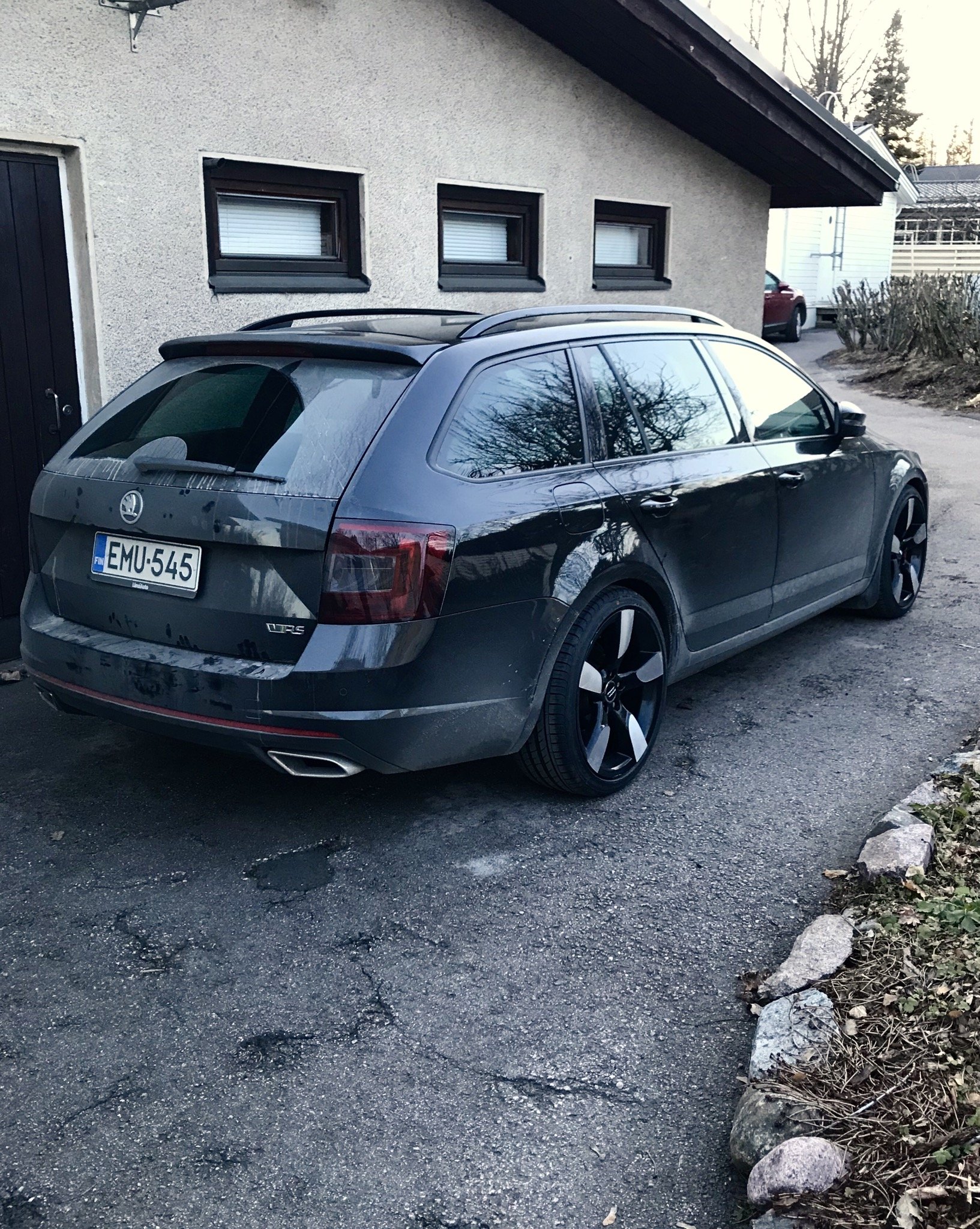

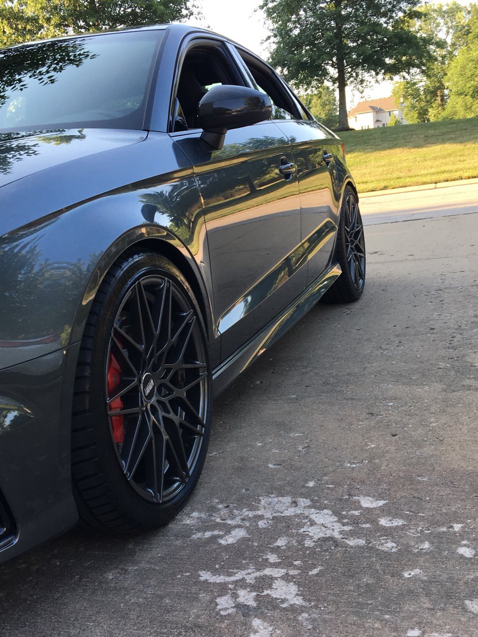

Both looks fine and flush fit B) With 8,5" wide wheels it seems that lookswise ET around 30-35 in back and ET around 40 in front is bang on. Do you know btw if ET35 in front fits ok or not?
Maxxxi are those some kind of Audi rotors? I've thought about some 5-spoke 19" wheels next.

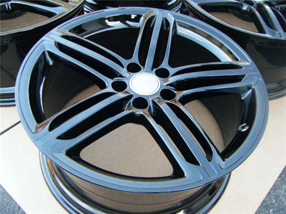

Maybe something like this (it's RS6 style I guess):
Or what would you think about Peelers style on Octavia? :nerd:
