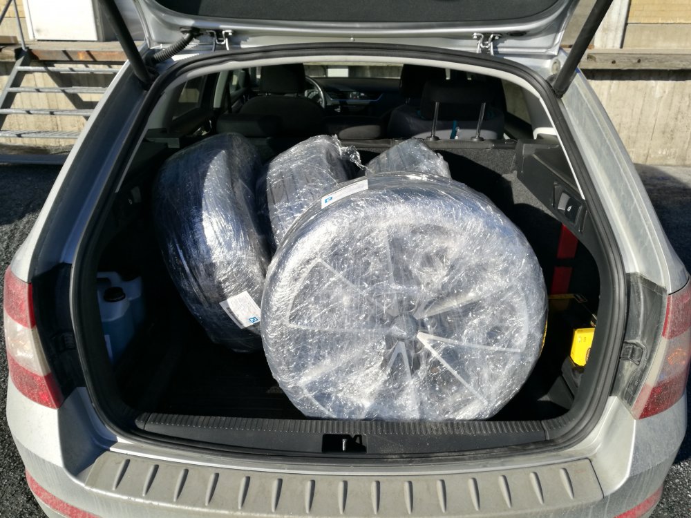

Thanks for your quick answers and helps.. After all I decided to buy those wheels. That set was on audi S3 and 3000km rolled. Price for that set was so ridicilous and that's why I was in a kind of hurry. I'll give some teaser pics as soon I get those in my hands =)

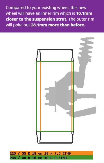

Ok I was slightly wrong, according to www.willtheyfit.com
Thanks for website but, the rims are only 8" so, I think I'll go with the R18/40/245 on this data

Compared to your existing wheel, this new wheel will have an inner rim which is 1.7mm further away from the suspension strut. The outer rim will poke out 14.4mm more than before.
Wheel Fitment Guide
The strut shown in the diagram is for show only. Don't worry if the wheel looks like it fouls!
Bear in mind most tyre manufacturers vary slighty from the specs, and that it could be dangerous to run tyres on wheels they aren't designed to fit.

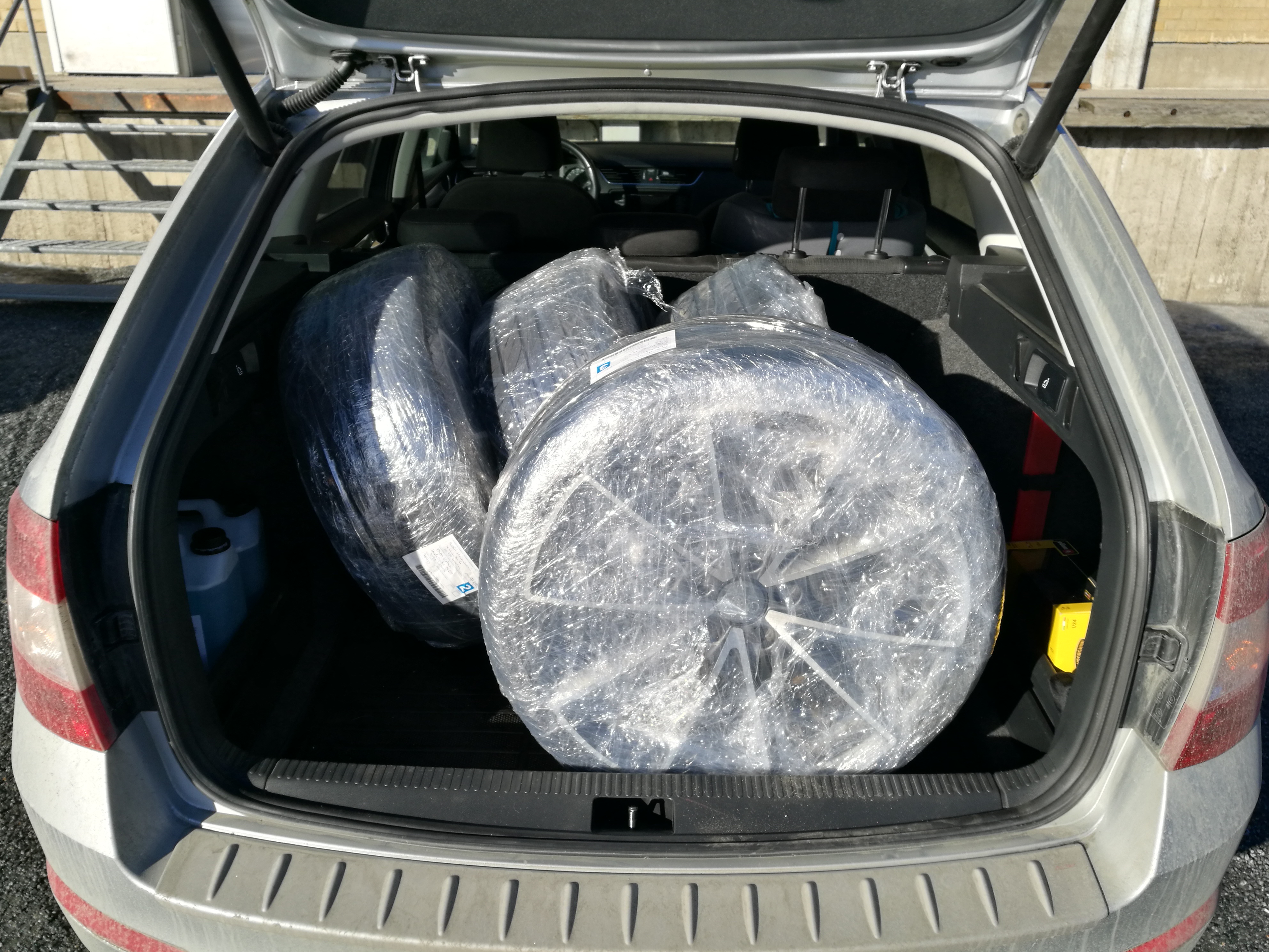

Here's a little peek for summer :)
@anttihotari remember to put some pics up when you get them under the car ;)

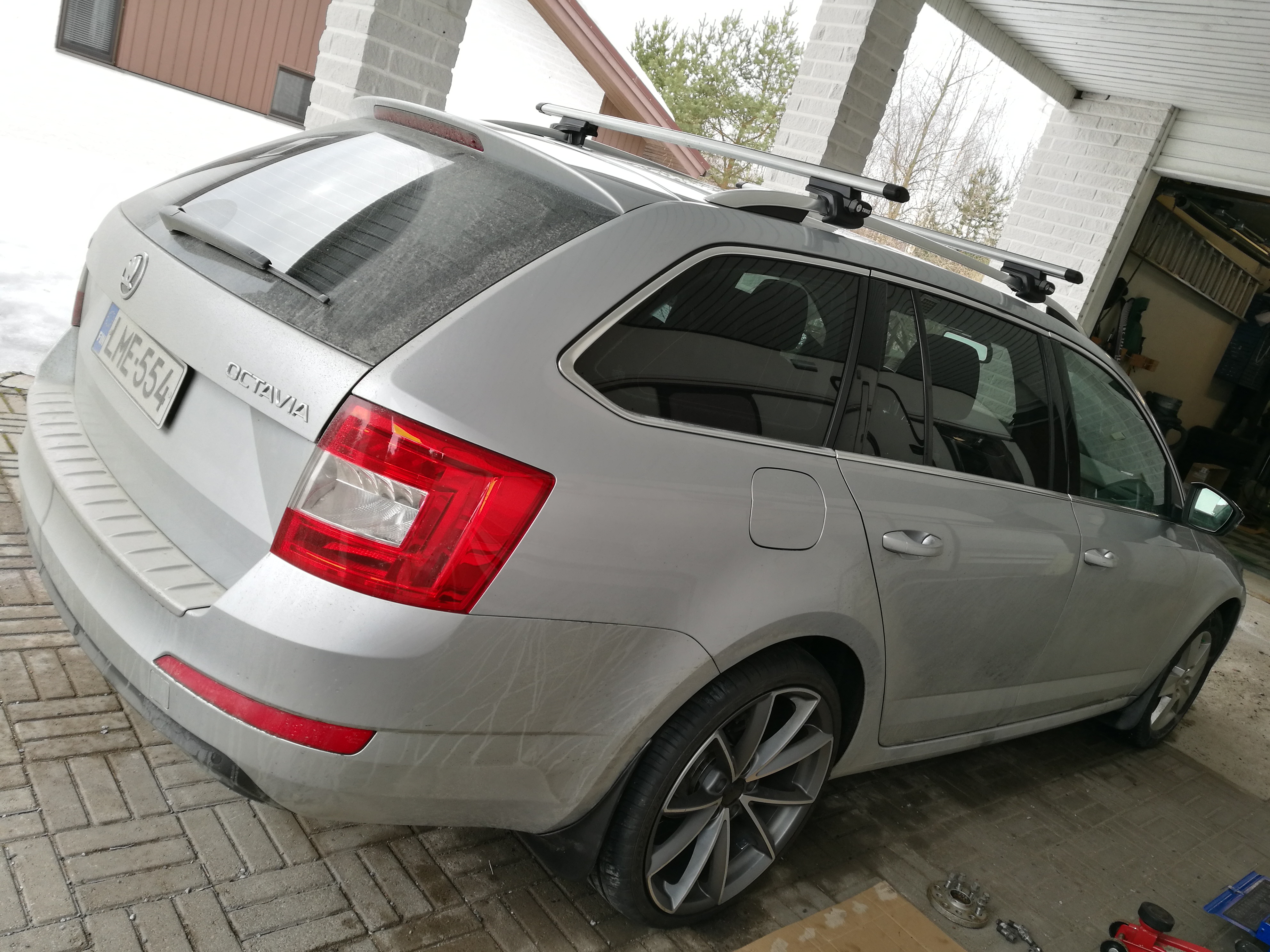

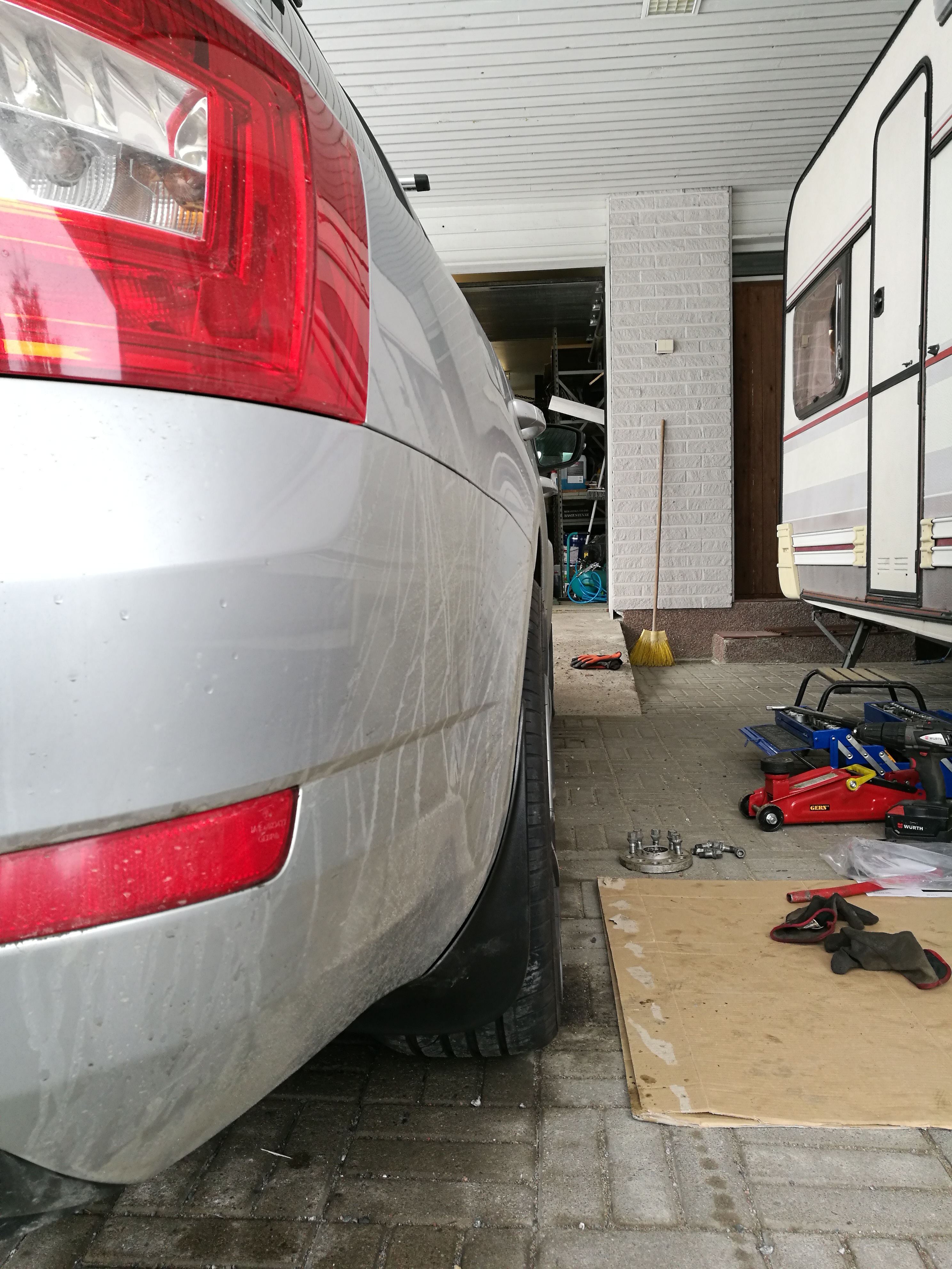

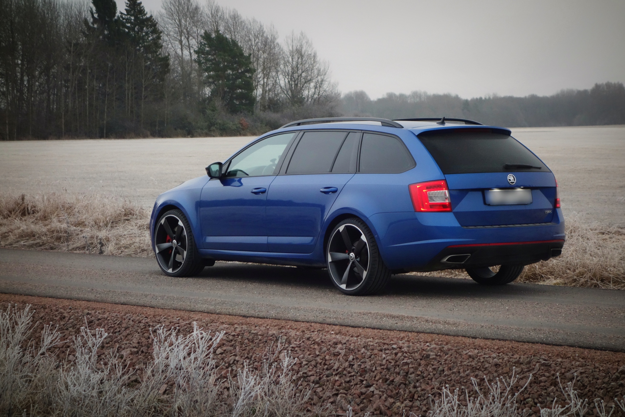

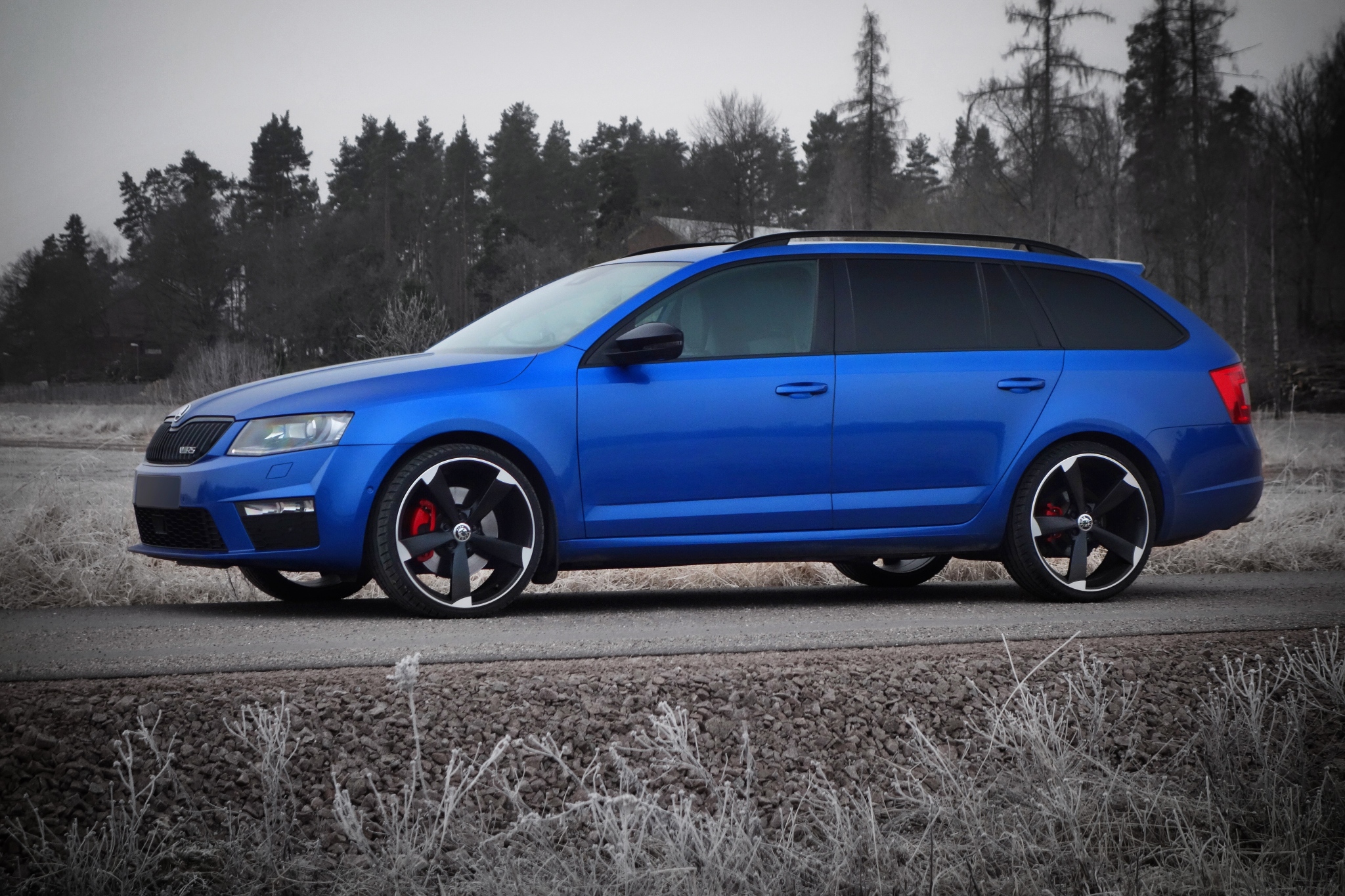

Just tried those 19" on my car. The real size was 8,5Jx19 et40. That wasn't so bad thing after all.. It sat guite nicely and on those pictures there is even 10mm spacer. With a little drop I think it works nicely with the arch.. Also installed hood dampers, rear mudflaps, black mirror covers and those sexy thule roof racks for Easter ski trip in Lapland :)
Looks good, did you test fit the front?
No I didn't. Because the fitment was so "easy" on rear I think the front will go as well. I'm gonna put the whole set of those next week to see how it goes.

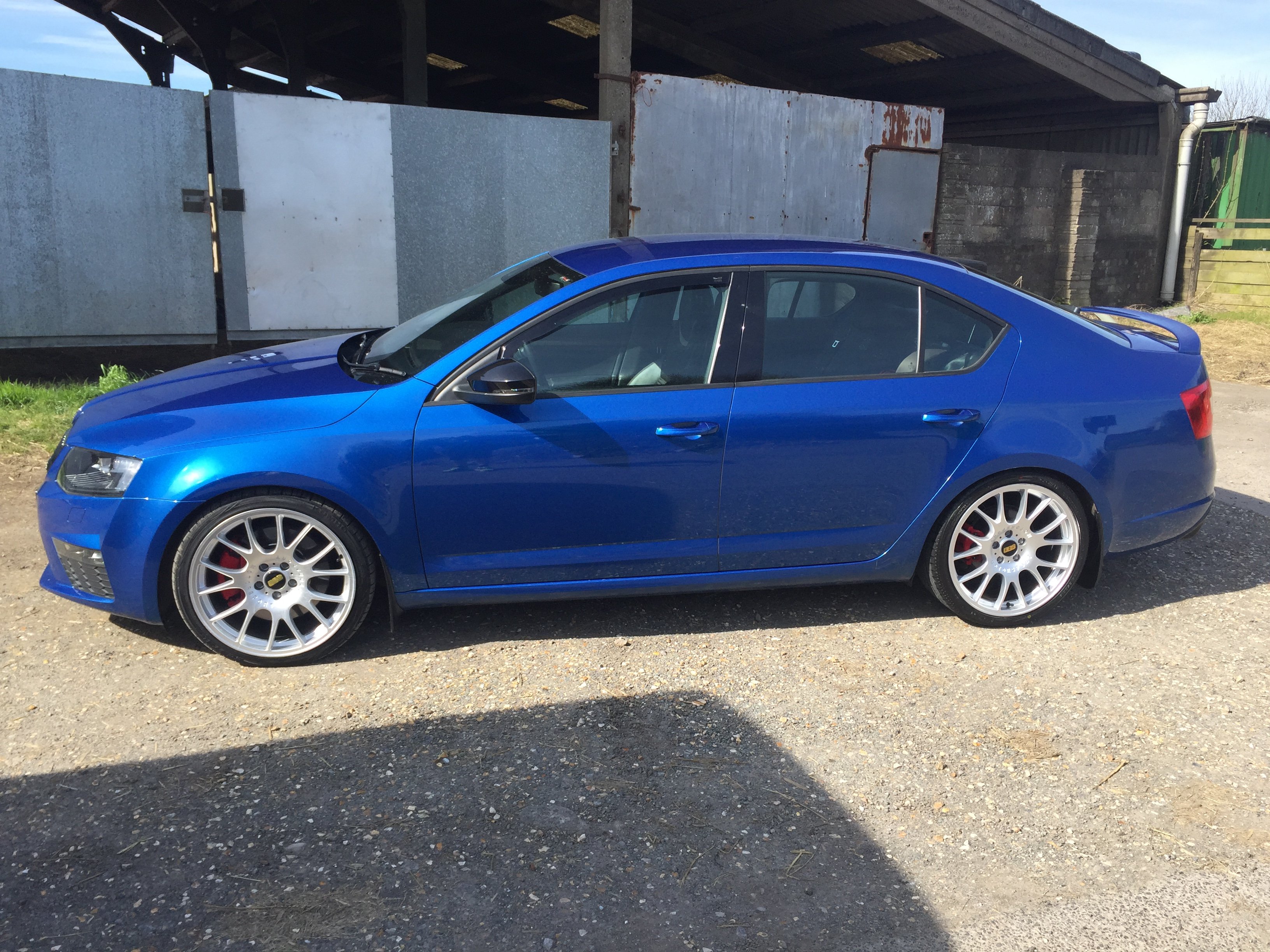

bbs ch reps. 19x8.5 et 42
235/35/19
no spacers

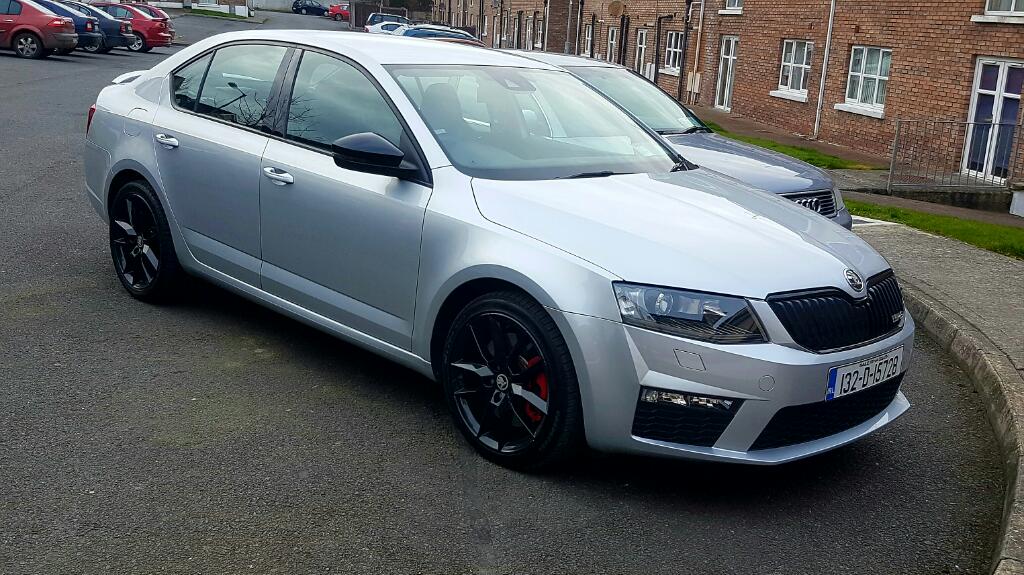

On 1/3/2017 at 22:11, Smoloney87 said:
Got the Geminis refurbished and finished in metallic black..

Hey yea im in Ireland.. Got them don't in rim solutions in dublin I think it was 400 and yea I'd recommend them they gave me a spare set and all.. My wheels were pretty bad came back pristine.. I can find them on Facebook
