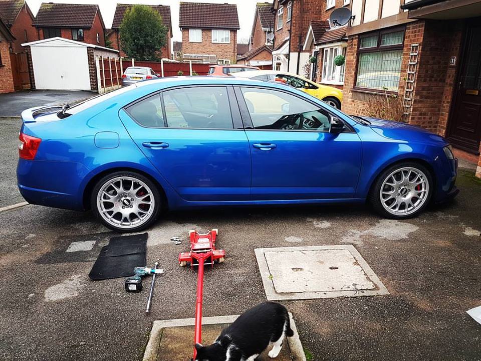

I bought some new wheels that I've always wanted and they came up for a good price!
Set of Genuine BBS CH 18x8 ET50 wheels with 225/40/18 tyres... I'm going to get some 235/40/18's and I've already ordered some spacers! Will get some more photos once tyres and spacers on!

BBS CH 18x8 don't need much spacer. My BBS 19x8,5 need no spacers at all in the front and 10mm at each side in the back at the most. And these wheels are just half an inch wider.
I found with my BBS CH copies I didn't need spacers on the front but put 7mm per side on the rear.
Depends what your offset is, My current wheels are 19x8 et41 so sit 9mm further out that the BBS's and they could do with a small spacer at the rear so i've gone for a 15mm spacer for the rear and an 8mm at the front for the BBS's and will see how they look.
Mine are 42 and the fronts are pretty close to being illegal.
The rears sit inboard quite a bit so you can get some pretty fat spacers on them.
Correct. Mine is ET47, his is ET 50, so not a lot more to the inside, apart from the difference in width of the rim.

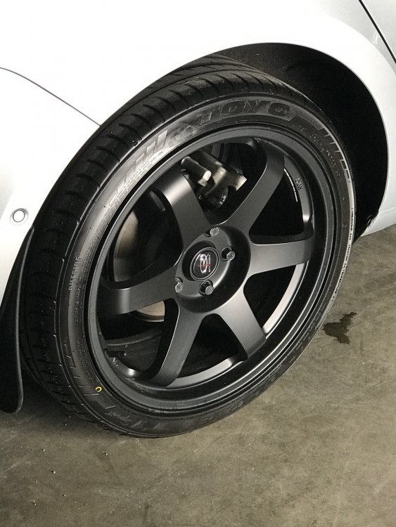

Wheel brand/name: Rota Grids
ET:44
Tyre: Toyo Proxies T1 sport 225/40/18
Any other mods, e.g. springs, coilovers etc: Window tints, Glass black Maxton Front splitter, black grille, rear spoiler, Waiting on KW coilovers, Booked into milltek for a custom twin exit system as they dont make one for a non vRS
ET:44
Very nice.  I looked at some of those for my winters.  Bought the ATS instead in the end as they were cheaper, but those are a good looking wheel IMO.
