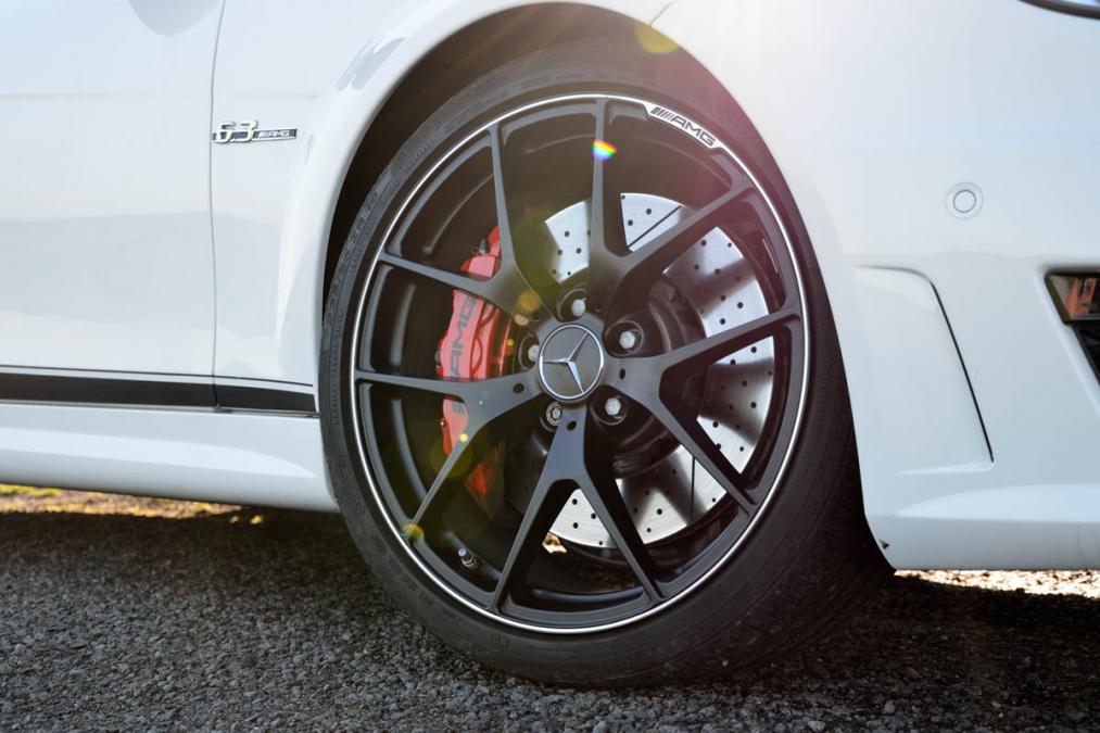

Anyone know if these alloys will fit the vRS :thumbup: Think they will suit the vRS estate pretty well B)
Mercedes AMG C63
But prefer them in this colour, just don't know what they are actually called or if the offset etc will be correct to go straight on without hub adaptors as for me I like a alloy wheel to go straight on to the hub.

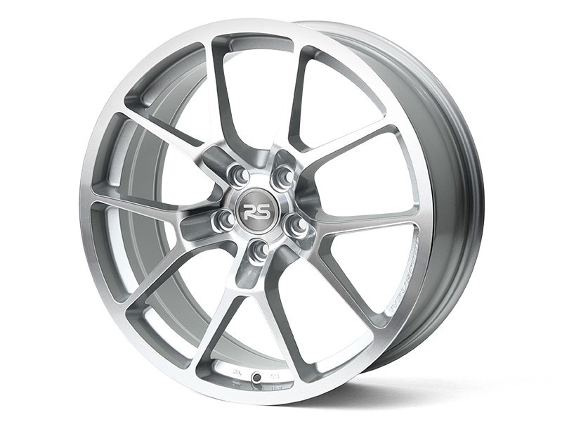

Those neuspeed wheels do look nice. I've my eye on the rse102 wheels in the gunmetal colour. 19x8.0 ones, can't see the need for any wider alloys.

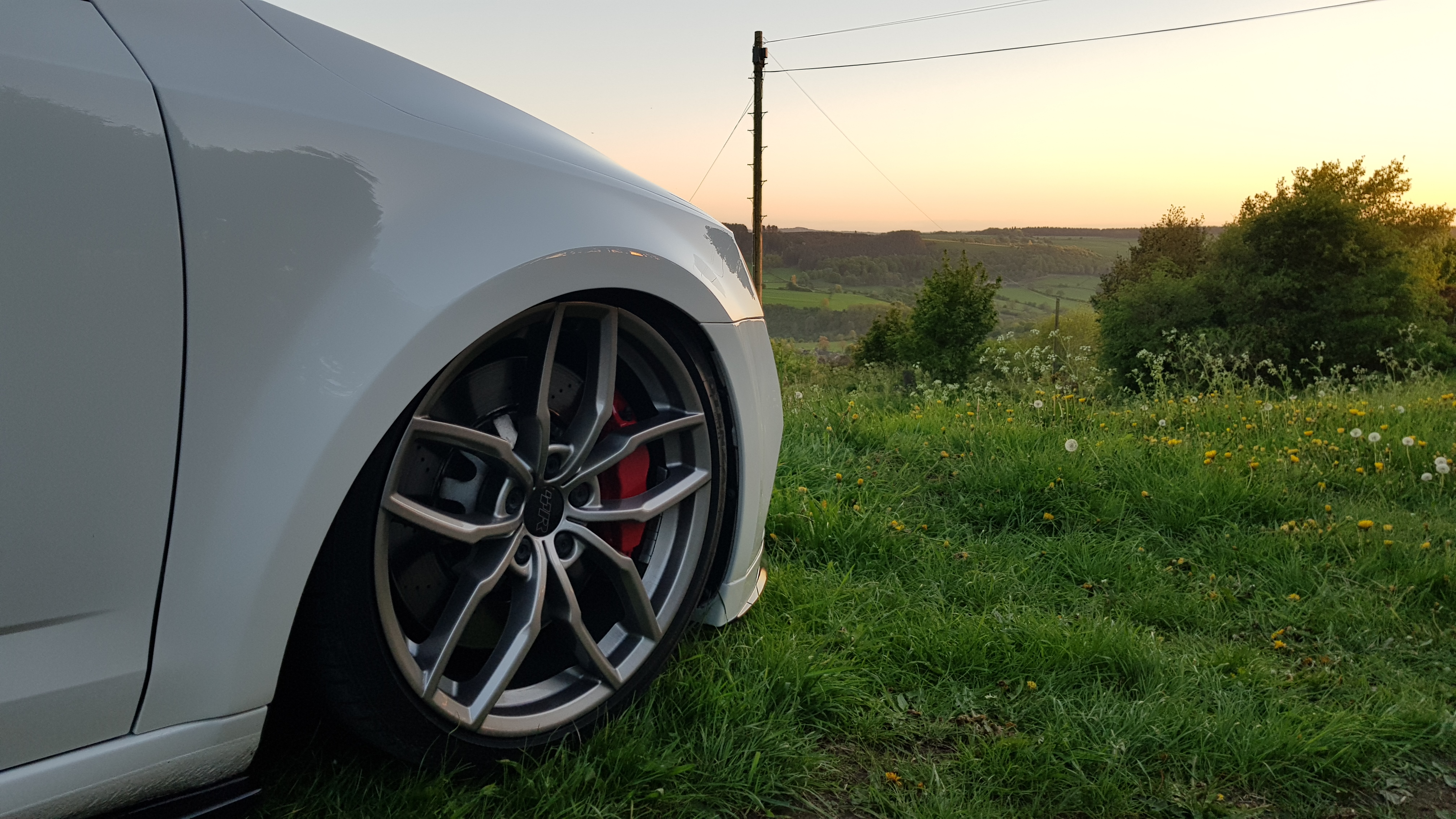

From APR
  (21 LBS / 9.5 KG @ 19x8.5” ET4@ 19x8.5” ET4

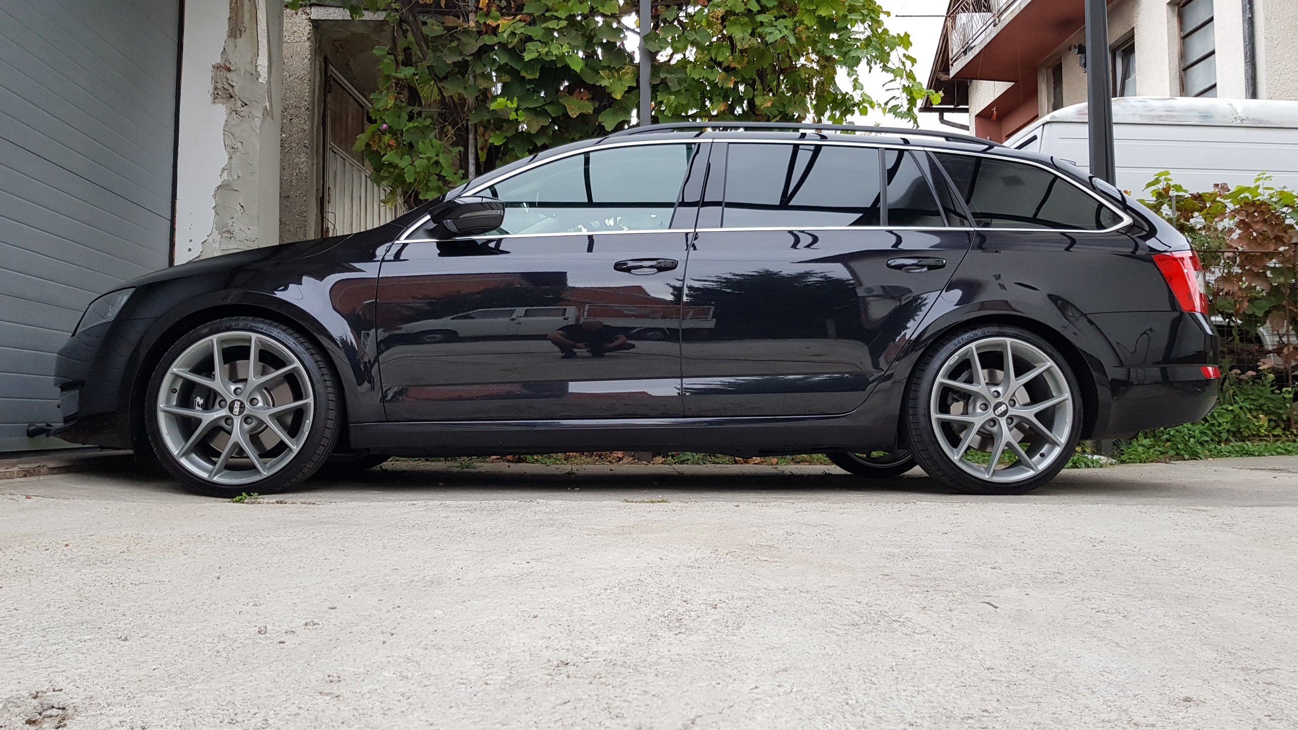

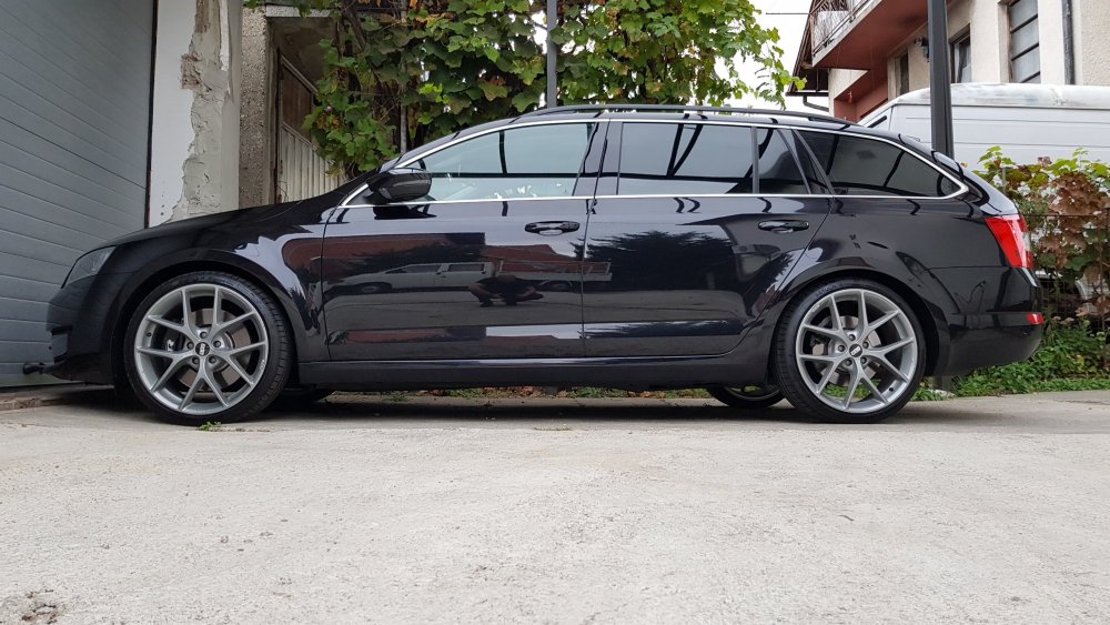

BBS SR 19x8,5 et 46 with 225/35 tires
Mk7 R 340mm front break discs and mk5 R32 310mm rears.
very nice.
How is the fender clearance? any chance of more photos?

Thanx mate! There's plenty of room with this setup. Front is flush and rear end could use 1cm spacers though. Wheel gap is down to 3,5cm roughly with Eibach ProKit. If you need, I can take more closeup photos. Just say the angle you want.

@BATVANVRS Not sure if you're still interested or not but the Black Wheels above are the optional wheel fitted on the Edition 507 C63. I had one before the current VRS and it had a set of those originally and I then swapped onto a set of the Diamond cut ones instead. They're forged and are made by AppTech who make a lot of OEM high end alloys. The Silver ones on the Golf are replicas as they just have a gap instead of the AMG Logo and are less than a quarter of the price of the proper ones.
They're 5 x112 PCD and a staggered fit Fronts 19 x 8 ET 45 & Rears 19 x 9 ET 54 - The replicas tend to be ET45 front and rear... So I think the Fronts would be a good fit but the rears may not fit. The centre bore is bigger too so I guess you'd need to run spigot rings.
They are a great looking and light wheel so if you could get hold of 2 sets of fronts I think it would work... They do come up on ebay occasionally but you may wait a while to get 4 of the fronts unless you want to give Mercedes £700 a wheel....
