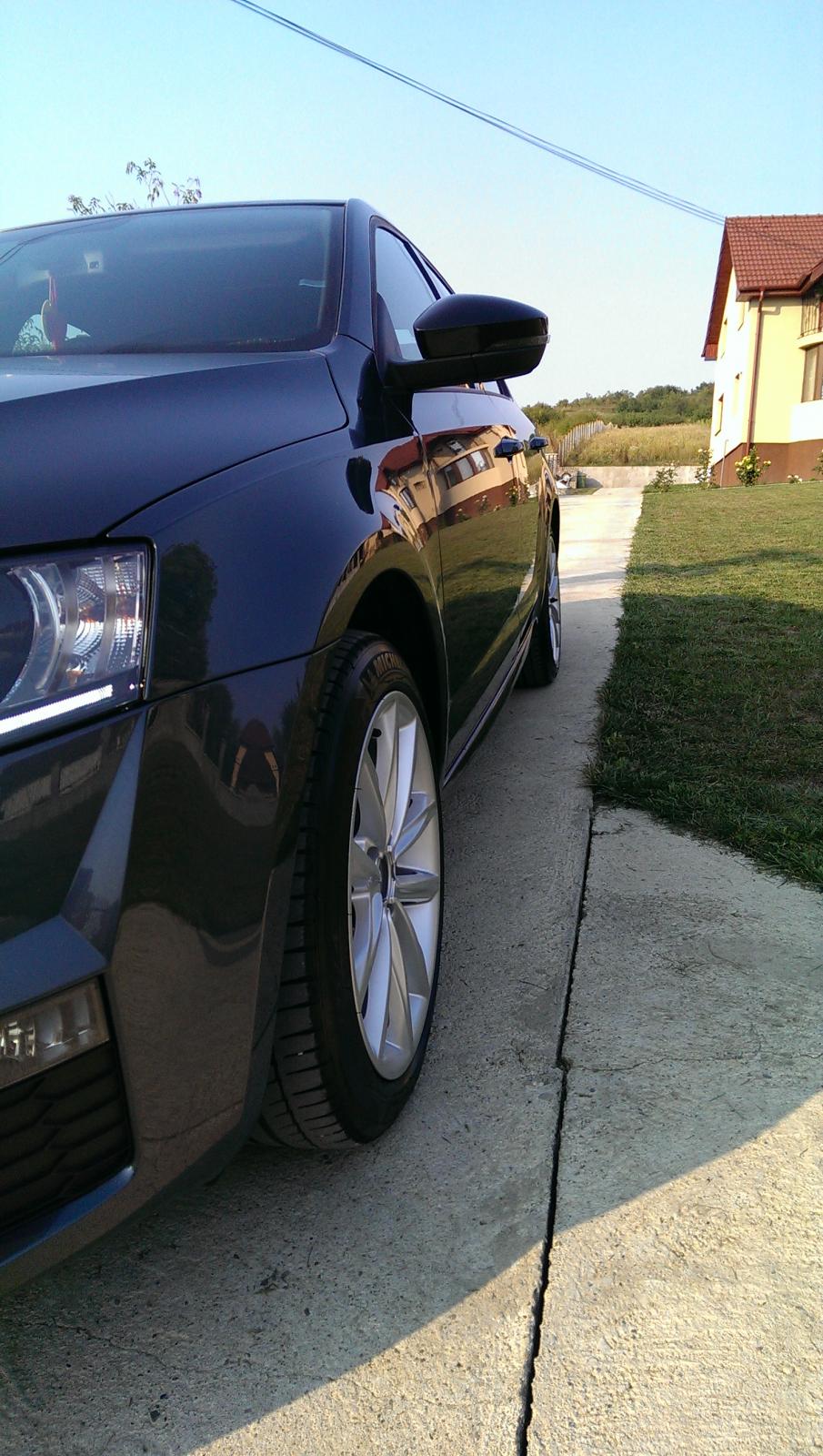

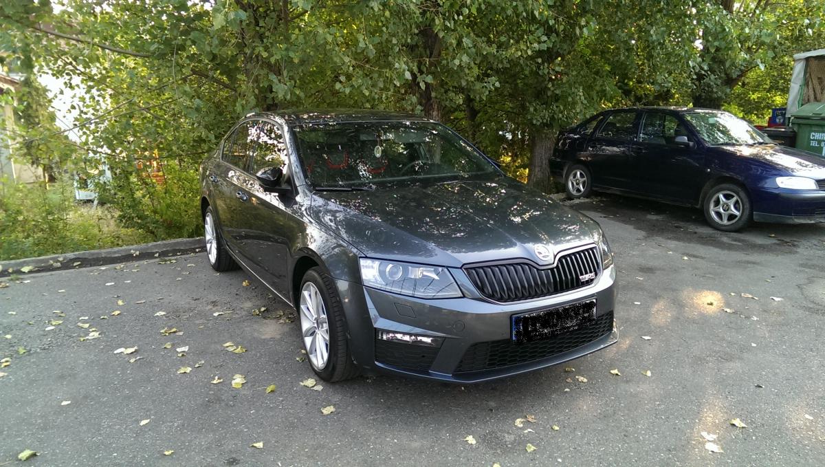

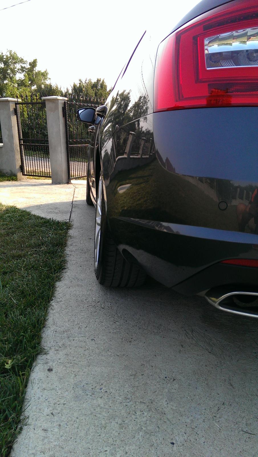

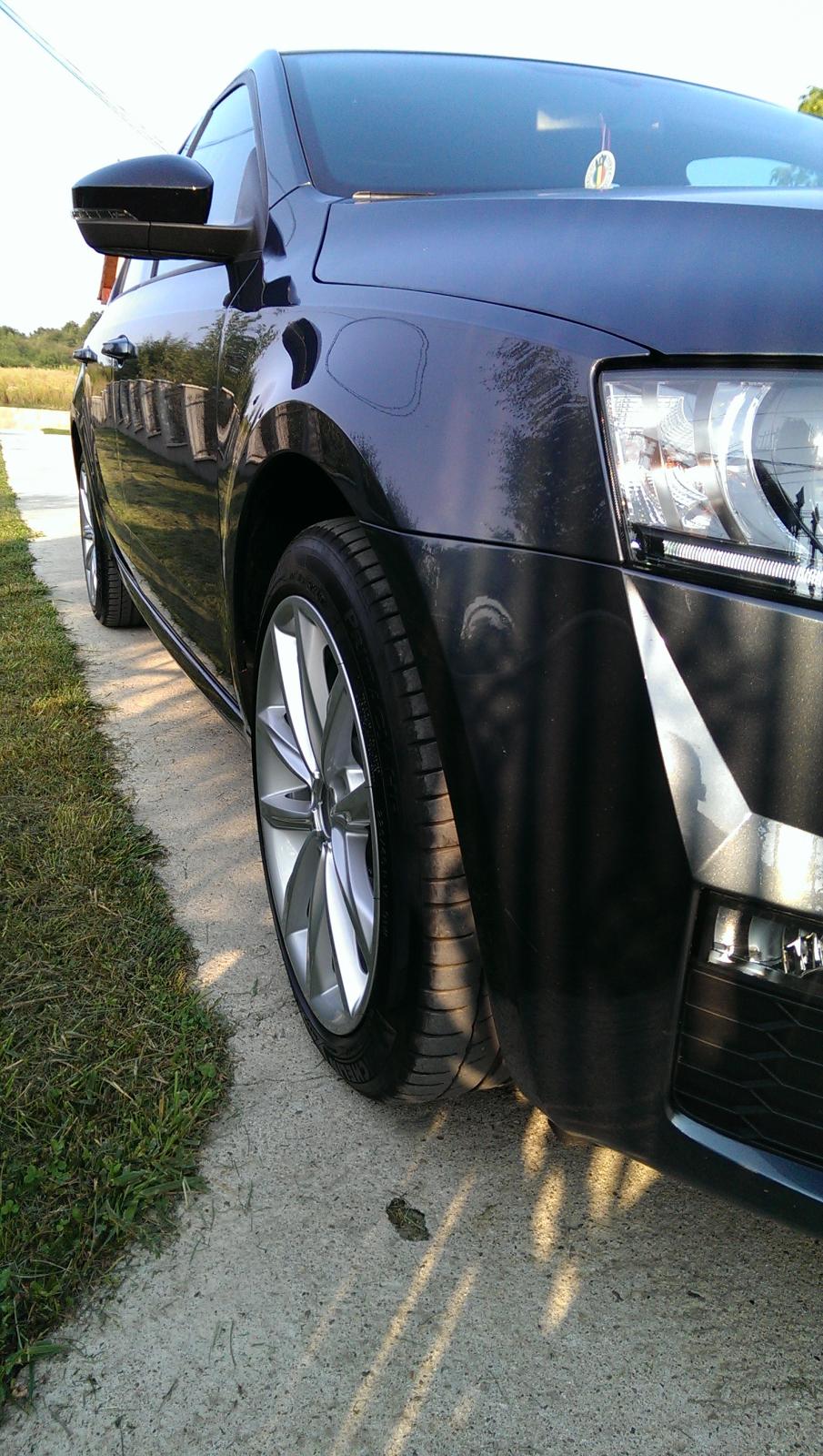

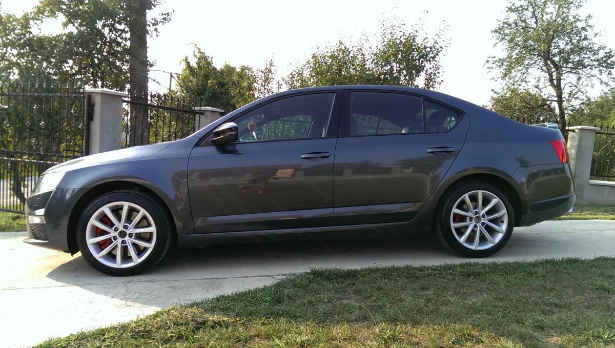

... and this is how it looks like.
They fit somehow ok... I say somehow ok because the inside of the wheel is pretty close to the suspension, but still ok.
In the front, there is something rubbing against the inside edge of the rim, only when the steering is at the maximum left or right and I go forward. In reverse, curiously there is no problem.
I couldn't identify what it is, even I asked a friend of mine to steer and I looked under the car (with the car standing still :p ).
I hope that I will be able to find and fix this, if not I will have set of Audi TT rims for sale... :)
Edited by cip
Two more pictures.
Edited by cip

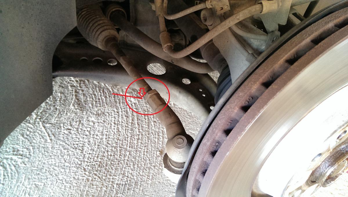

I managed to find out what's the problem with the rubbing.
It's this nut.
I don't know if I can do something to it, except spacers...  but I wanted to avoid spacers...
Any ideas, anyone?
Edited by cip
Looks like that's the end of the steering arm/track rod that the inside edge of the rim is just fouling, damn. Can't see how you can alter that.   Unless..... Is it definitely the alloy that is fouling, or could it be a balance weight?   I'm grasping at straws but if it's a balance weight then thinner weights might be an answer?  If you can find them.
Nope. Unfortunately it is the rim not the weights... :(
I am afraid that there is no other solution. I have to put spacers or buy other wheels. Damn, I like these wheels so much.
So, be careful if you want 8,5 x 17 inch, ET50 rims on your Octavia MK3. :)

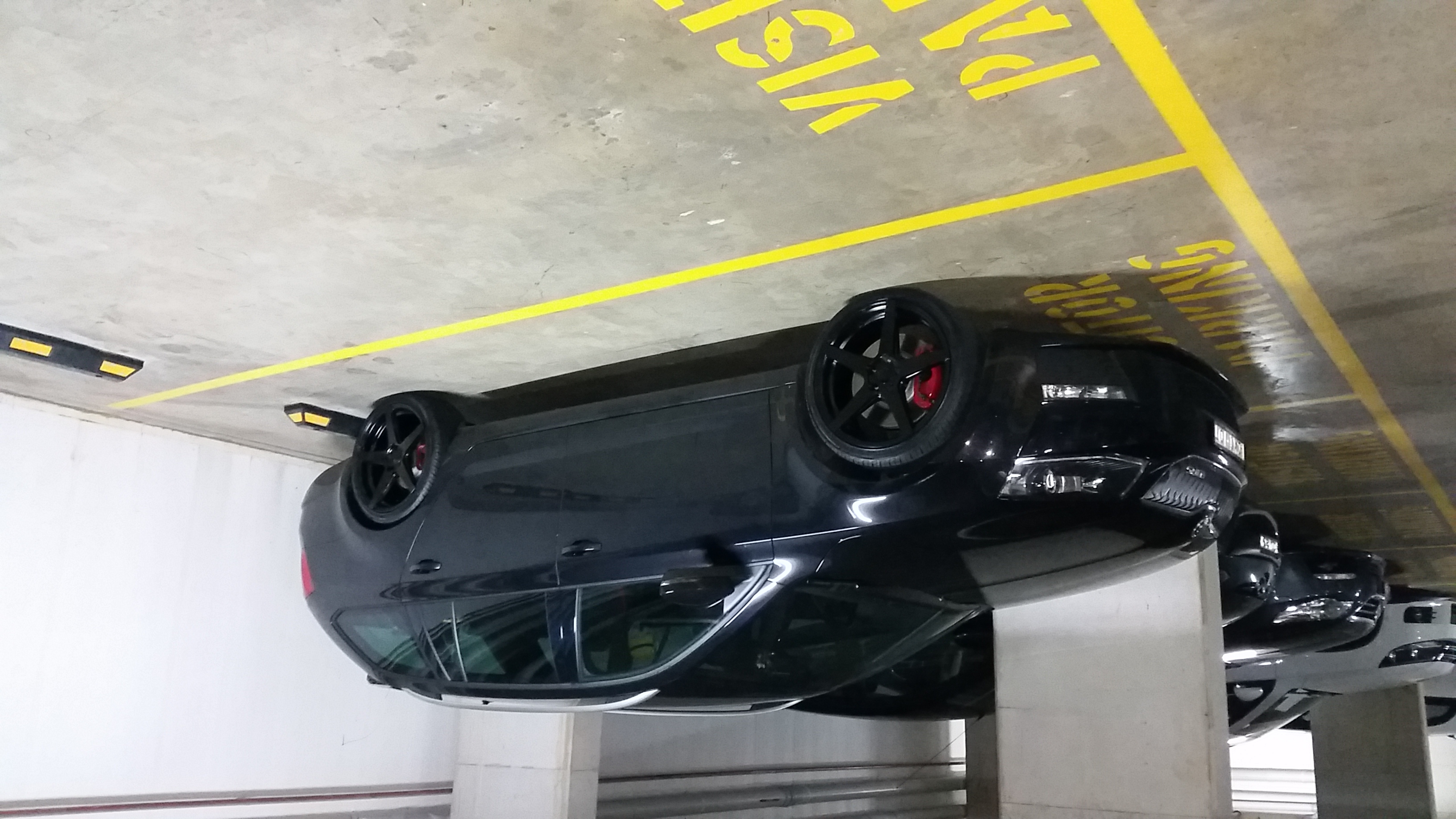

Bloody android... Don't know why it's upside down!!!
What's the measurement for the wheels and tires? Any plan for suspension?
Yeah. Definitely getting a drop. 236 40 19s et 40
235 40 I think... It's the standard 19 tyre for rs
Probably cos you`re in Australia lol!  :D  :sun:
Touche!!!

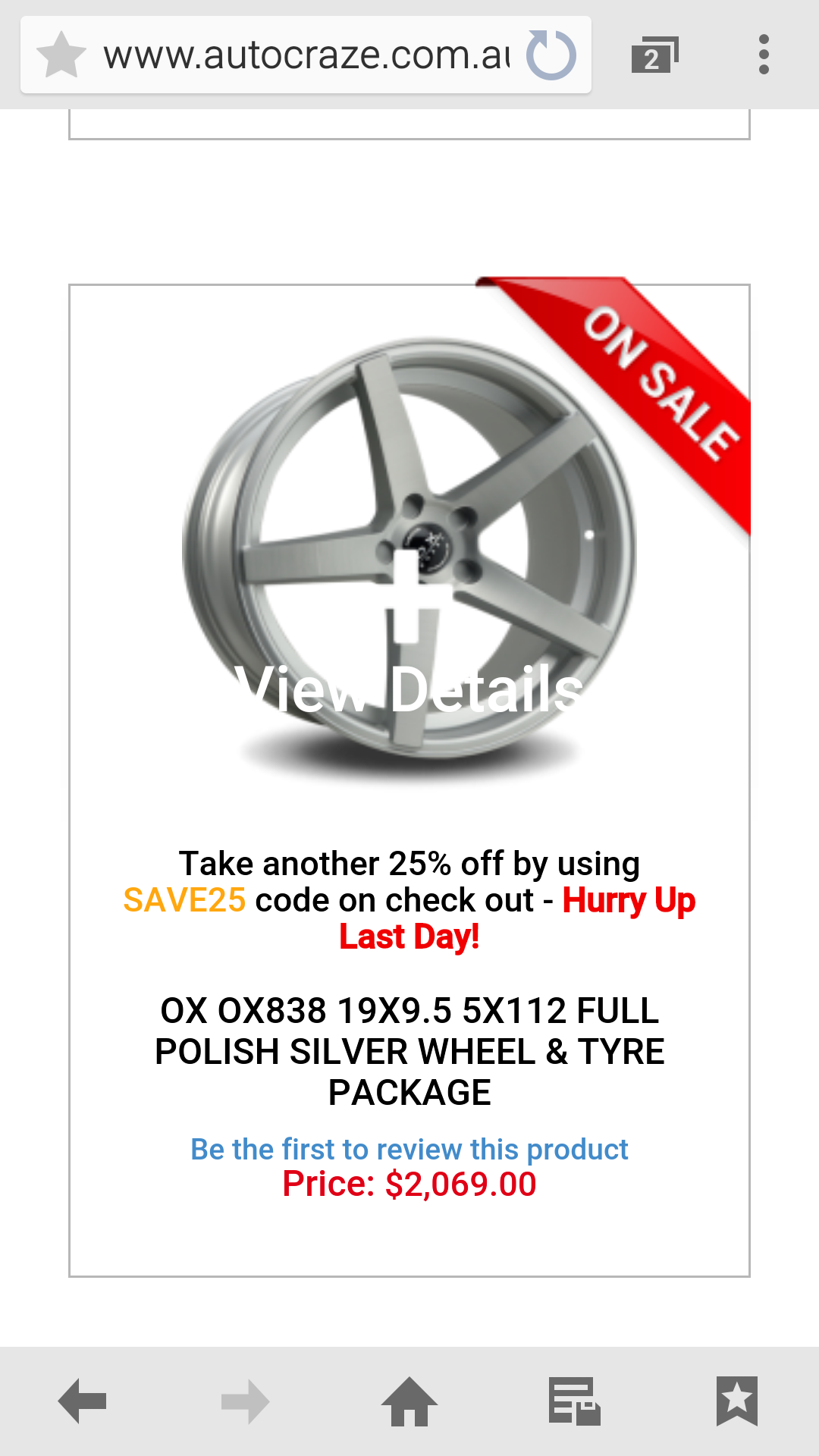

Oze30 - what are those?
post-129178-14416367537896_thumb.png these bug I sprayed them gloss black. Was a few hundred extra for black. Going to get them done properly when the funds allow. And mine are 8.5, not 9.5!
