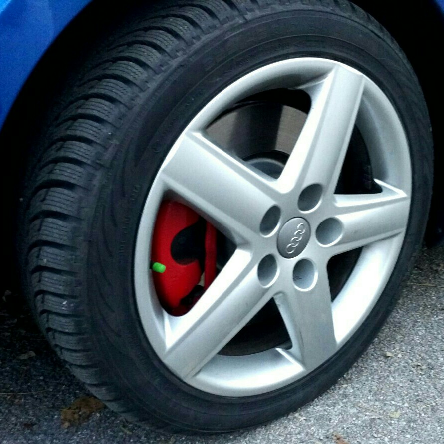

Waiting for RS arrival... did maybe anybody try to fit thoose to vRS mk3 ?
www.original-felgen.com/4f0601025afz17.html
Thoose are 7.5 x 17 ET45, but You Skoda is recommending 7.5 x 17 with ET51 as I found in some documents.
It's a leftover from just sold Audi A4 Avant (V6 and also had a huge discs and calipers), would like to use them on Octavia in winter period. Wondering about the caliper clearance...
Reply to myself :-) :
Lookin good, much more than expected. Compared to 18" black Gemini's, a nice refreshed winter look. Caliper clearance is more than enough, no problem with fitment.
I just cant find a decent centre wheel caps that fit, so will stock to Audi's this winter :-)
May be useful for someone as I saw them on eBay occasionaly with a very good price.
