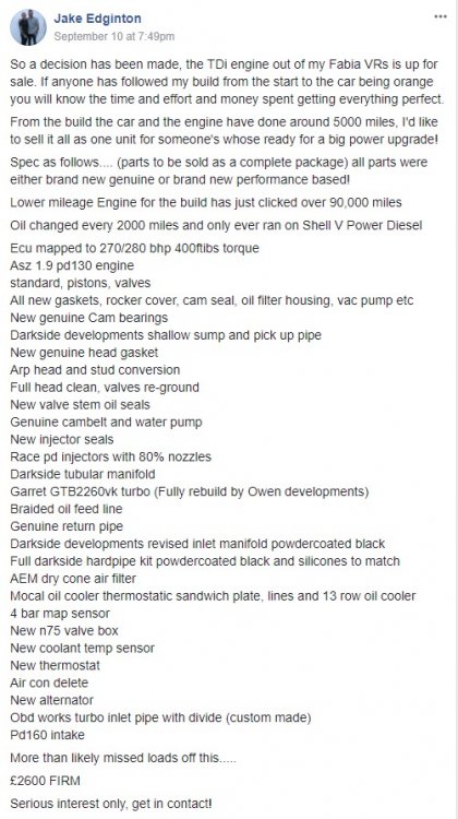

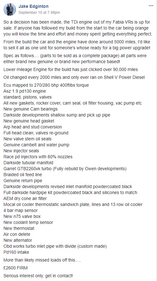

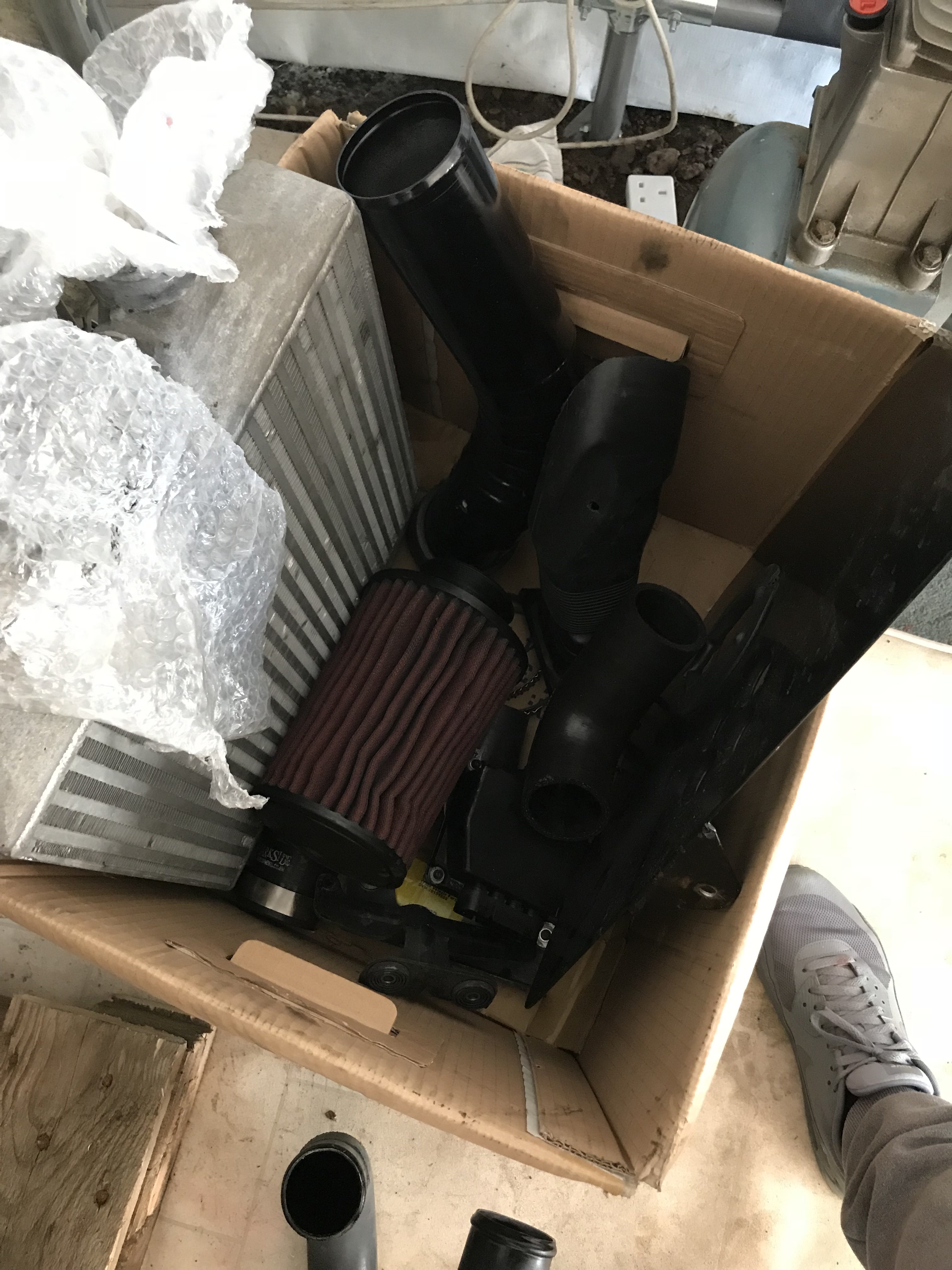

So took a trip to see Jake and his lovely Orange Fabia, left with some goodies :D I’ve attached his description to save time explains what’s there.

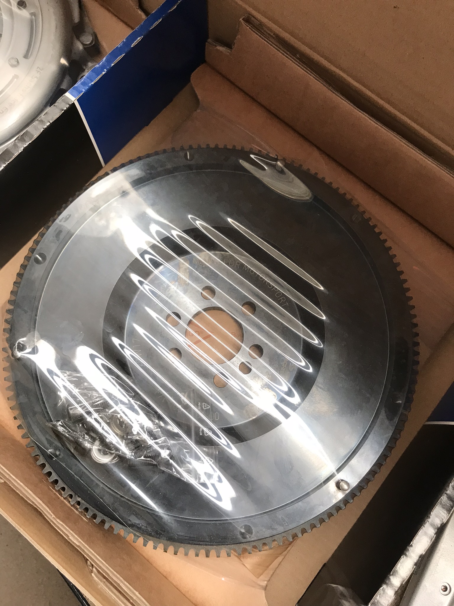

Also picking up a cam from a friend and Sachs SRE clutch is due any day now ready for mapping once it’s all in and running smooth

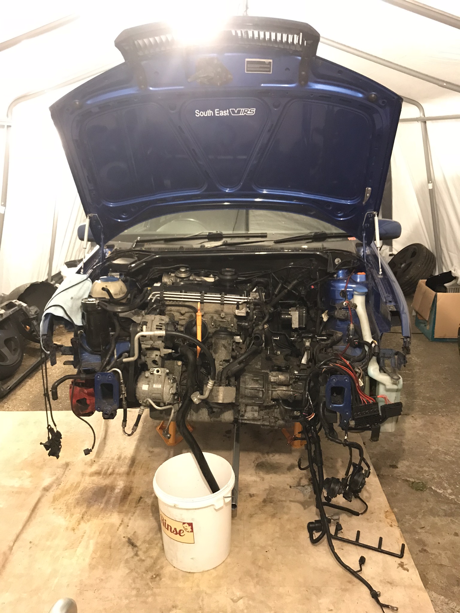

Few hours spent stripping it down last night on my own, think all that's left is driveshafts and EGR cooler and it'll be out :)
Great work, watching with interest!
Box is on a pallet going to darkside today, Quaife diff and steel selector forks being put in :D Not actually a bad price either considering people say that they normally charge the earth

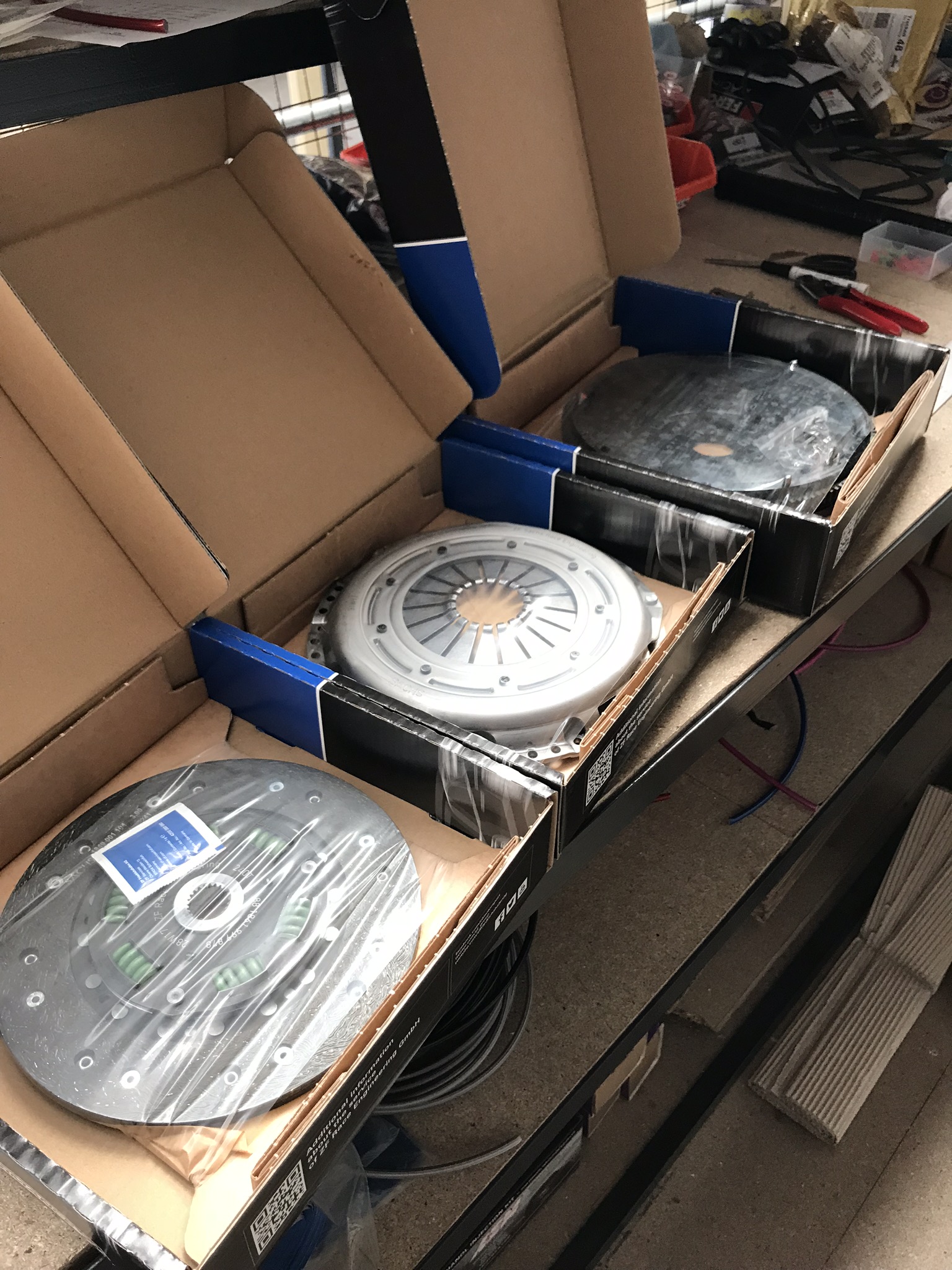

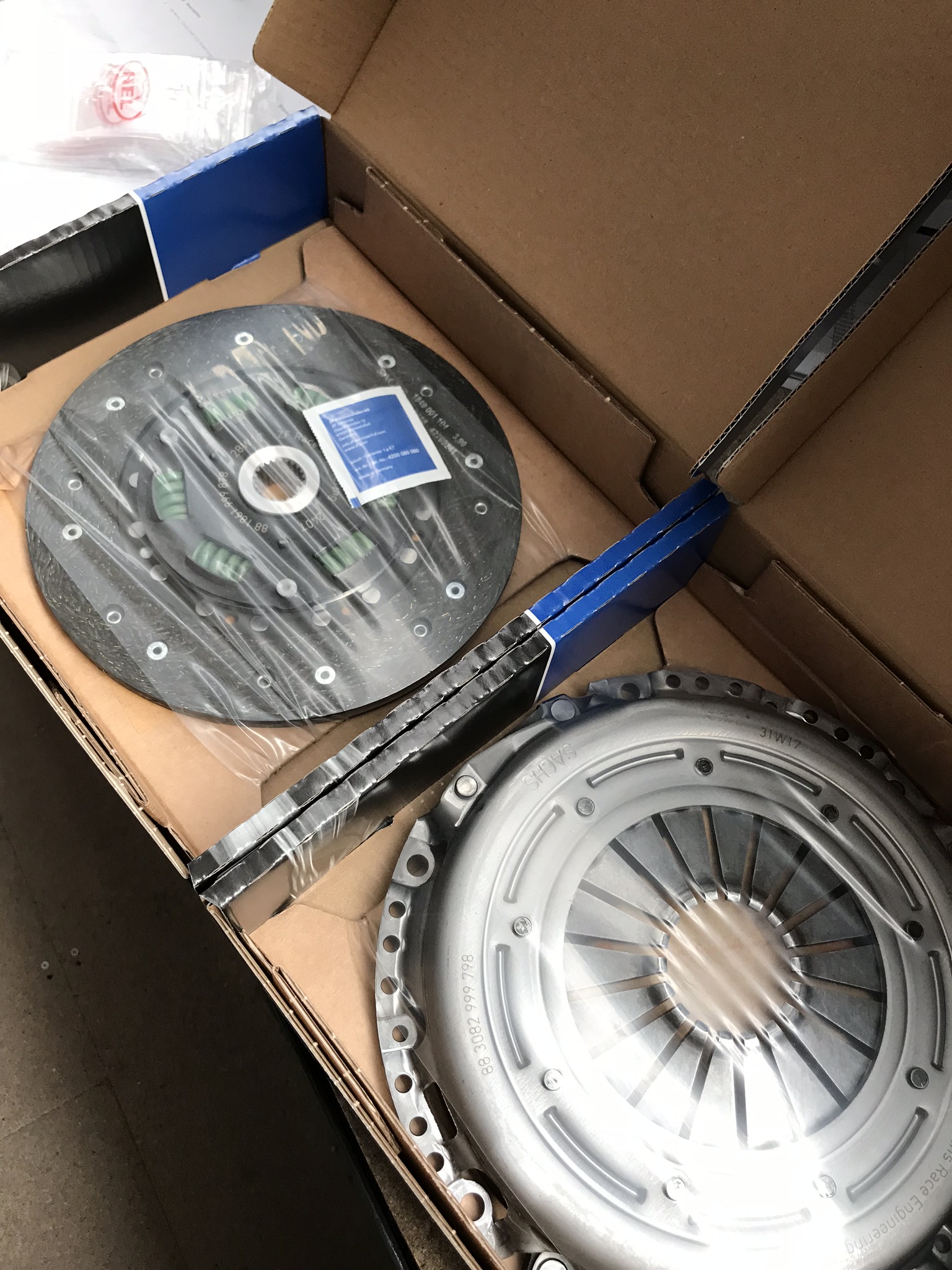

Clutch was delivered today :D Just waiting on the gearbox to come back from Darkside and things can get moving properly.
