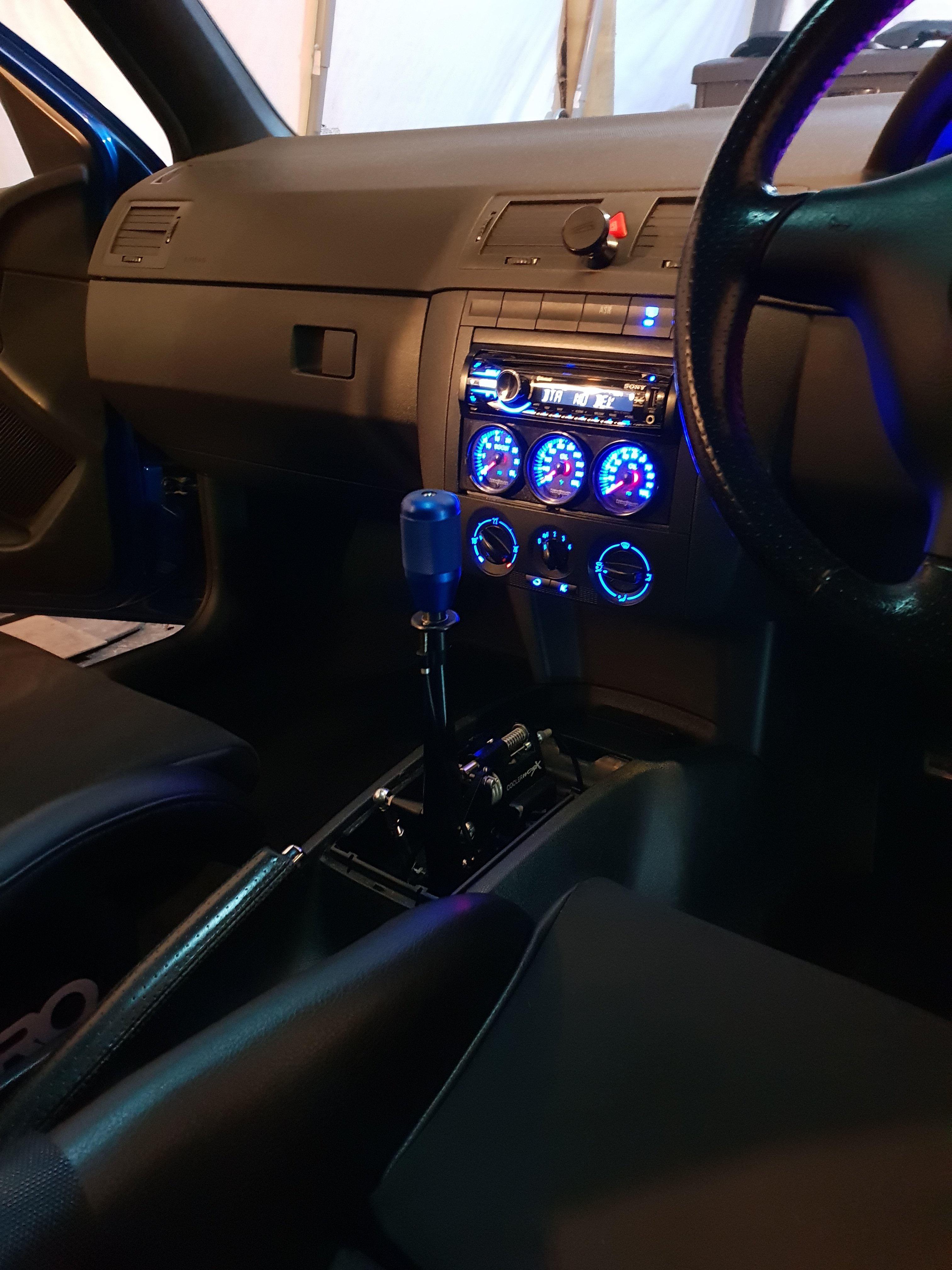

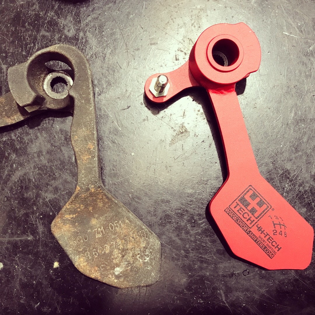

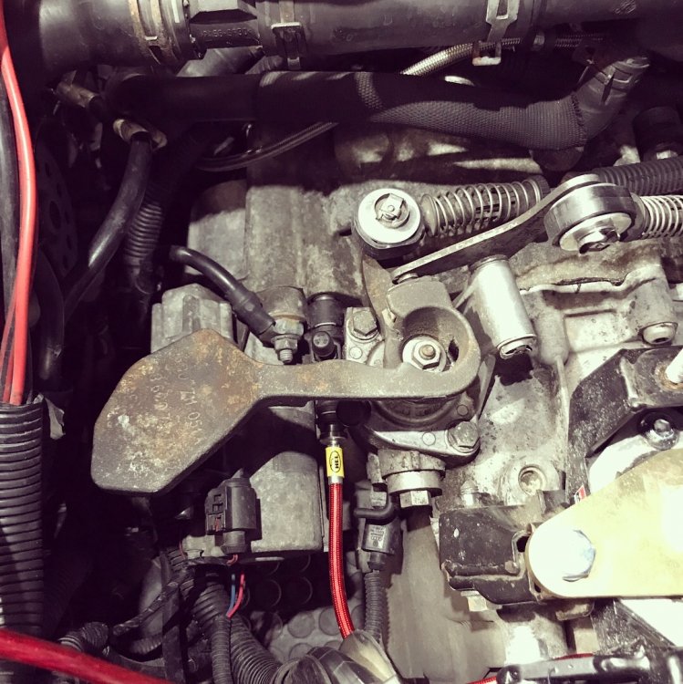

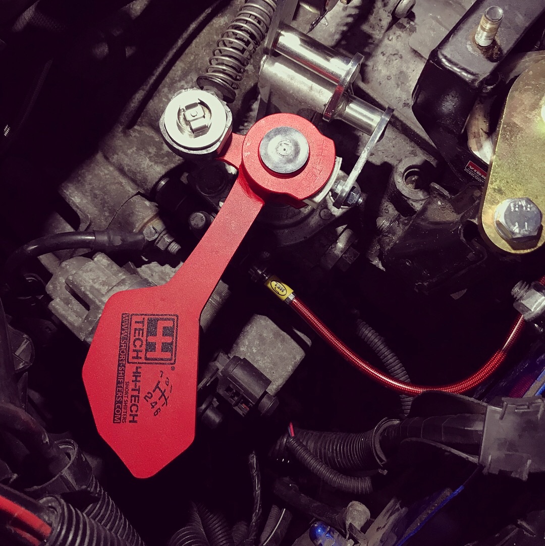

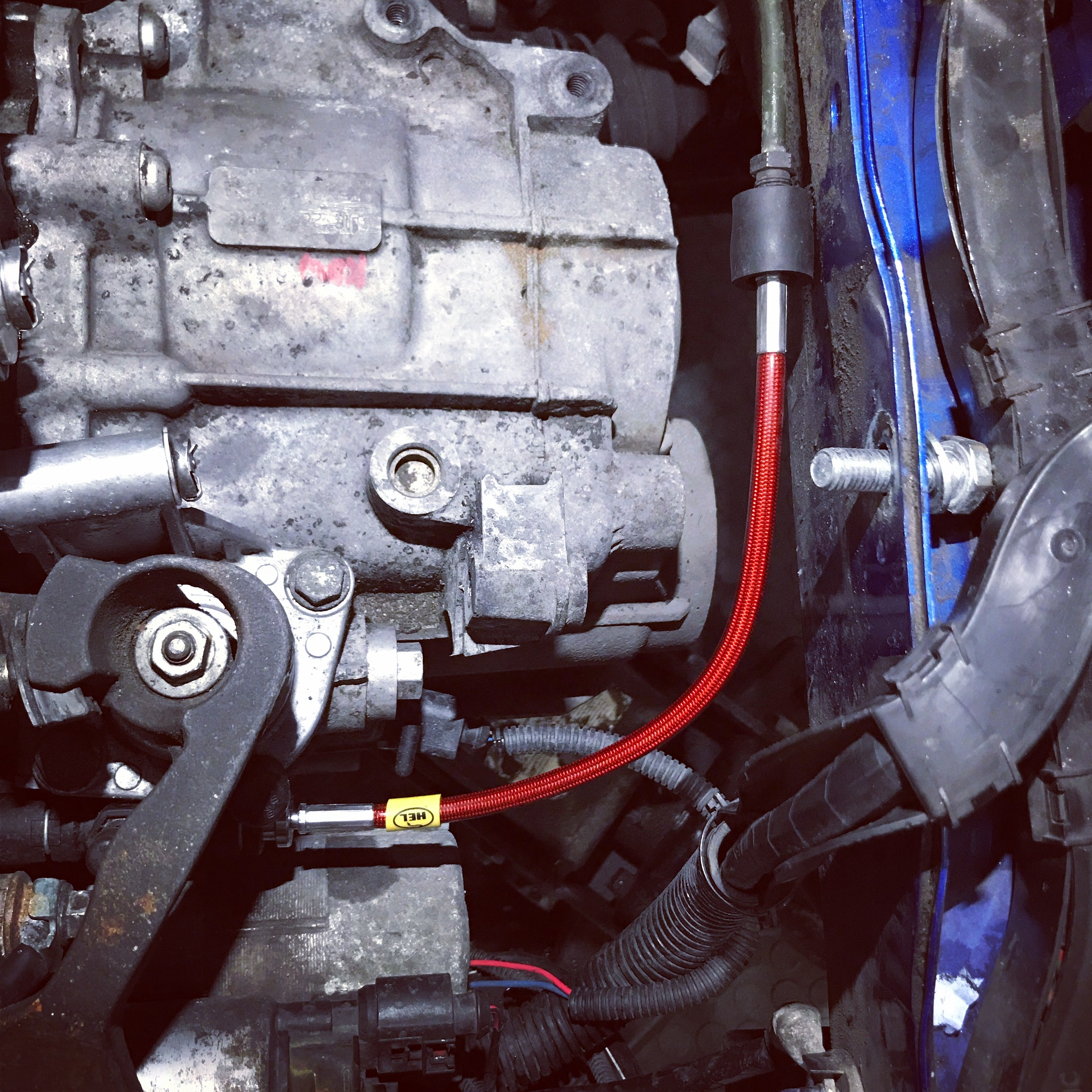

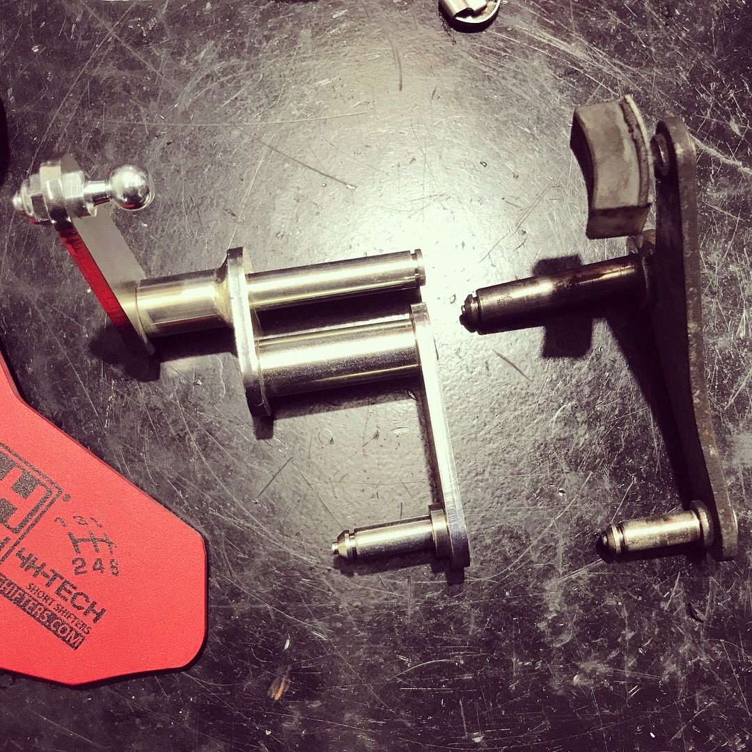

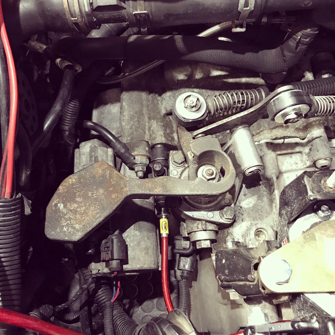

So braided brake lines, braided clutch line and 4H-Tech shortshifter went on recently.
Also fitted the purple powerflex dogbone bush and the car feels awesome now. Much tighter and willing to go after changing the bush. The shifter also feels brilliant, third is definitely shortened the most, almost feels like it's not even in gear haha

Ooh very nice. Interested in the braided clutch line and shifter. Nothings been available for the Fabia before
Shifter was developed for the fabia with my work as i knew there aren't any available as well as the clutch line. Let me know if you're after either of them :)
Excellent. Interested in both, but not on a position to buy just yet. Got engaged this month, so a little skint haha

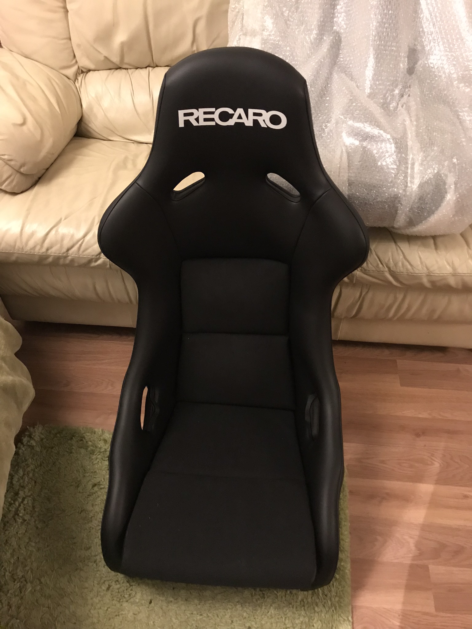

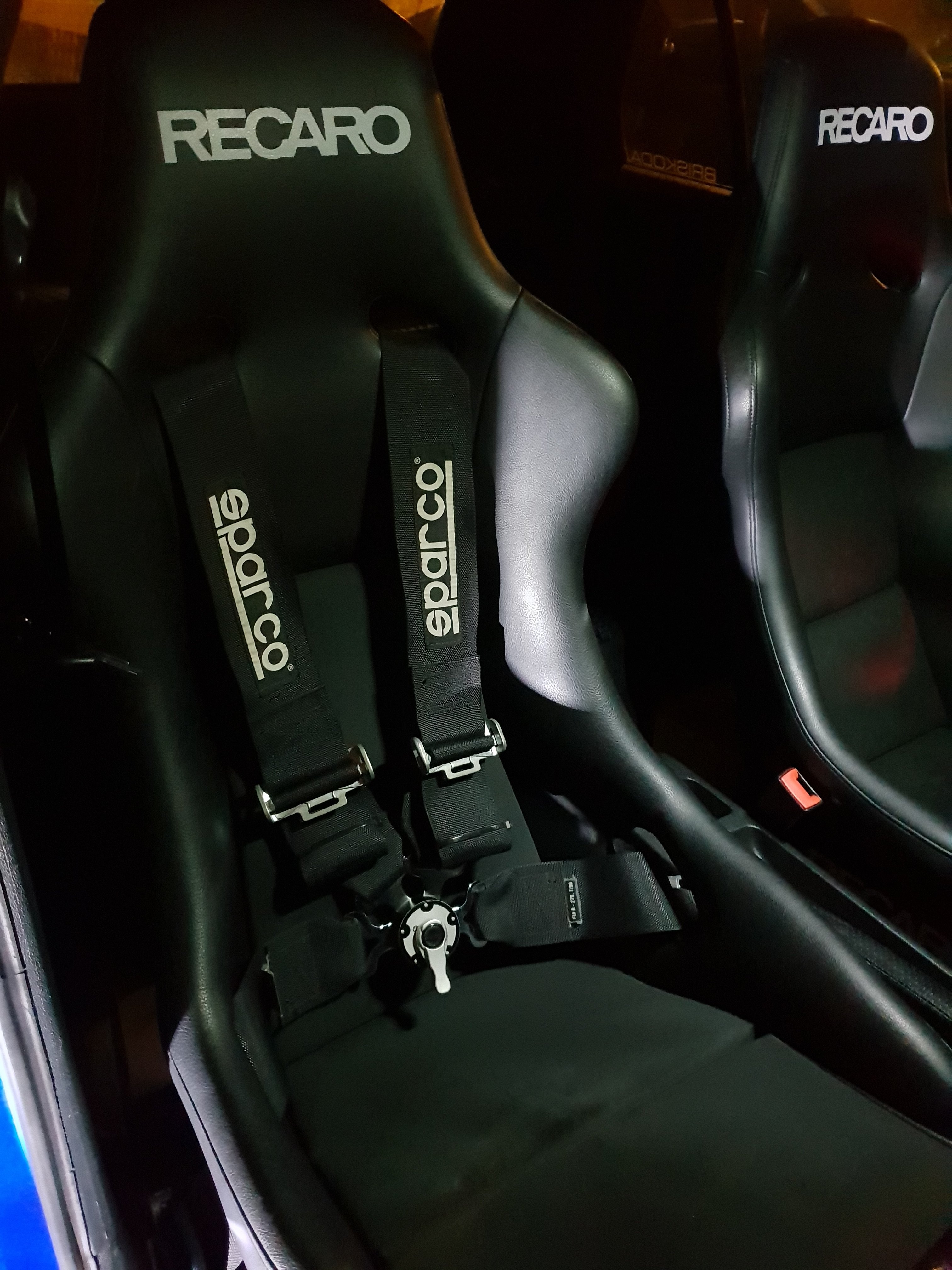

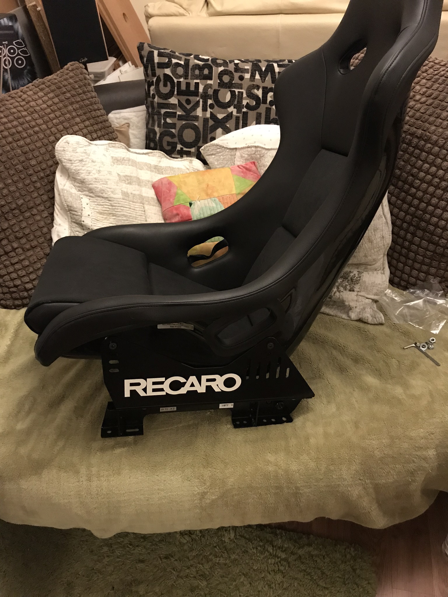

Still haven't had the car back yet but the Recaros turned up :D Really impressed with the quality of these and how light they are, sat in them a few times before but i can appreciate why they are so expensive now. Just waiting for the car now, I've booked Brands Hatch for April 30th so that'll be a good test before the Ring trip :)
