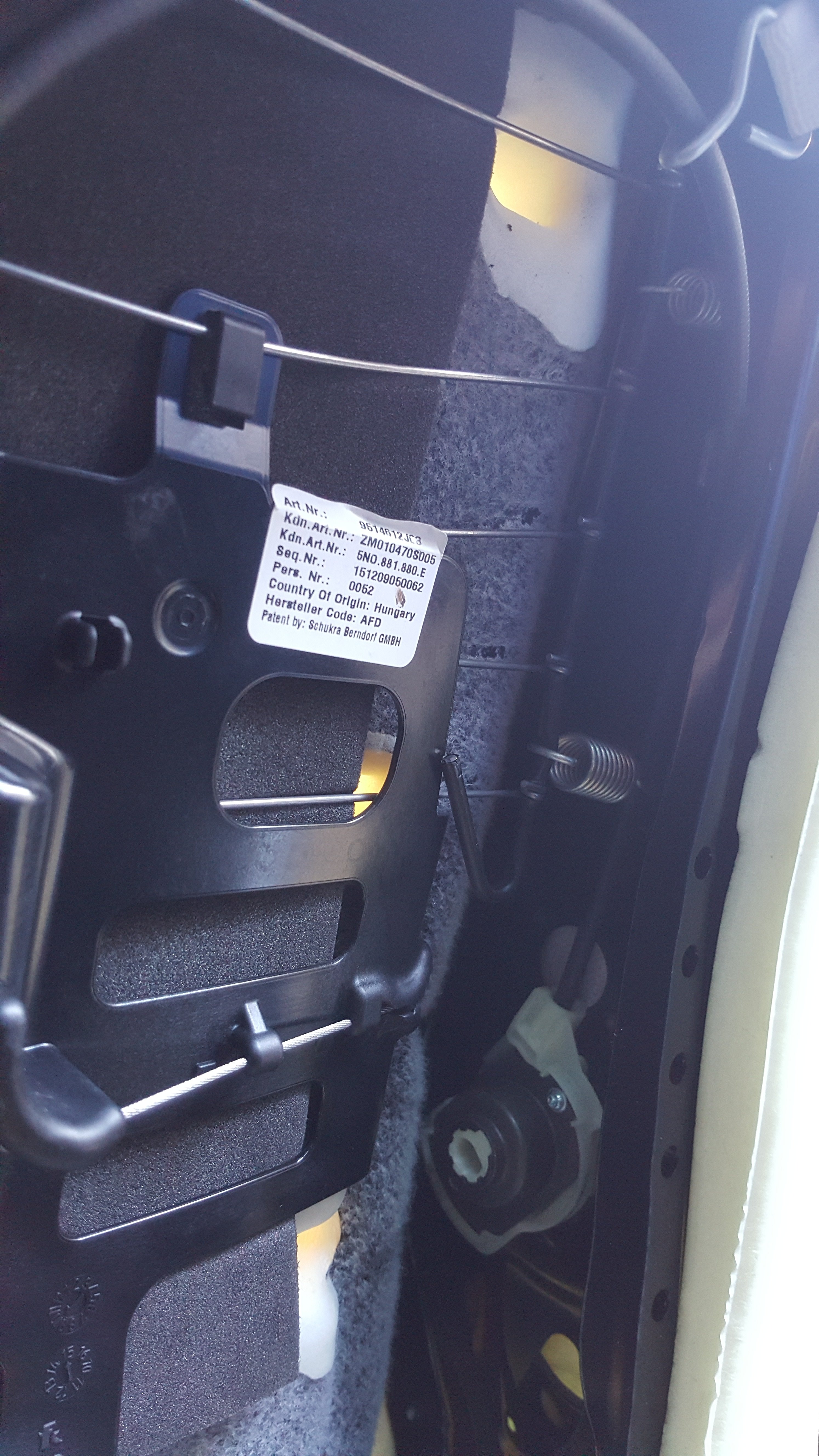

I resorted to modding my current seat, took of the seat back cover and raised the lumbar support mechanism and its much better now :). Took about 30 minutes, just need a strong side cutter and small cable ties.

Lumbar support mechanism in case you want to have a go at raising or lowering it. There's only 2 tabs on top which hooks on to the metal seat wires.20170505_074546.thumb.jpg.be5b66e99fa9141b86703b807f92ef24.jpg
So you can adjust the height? Hmm..
@lickspeed50 how do you take the covering off the seat to access that..!?
