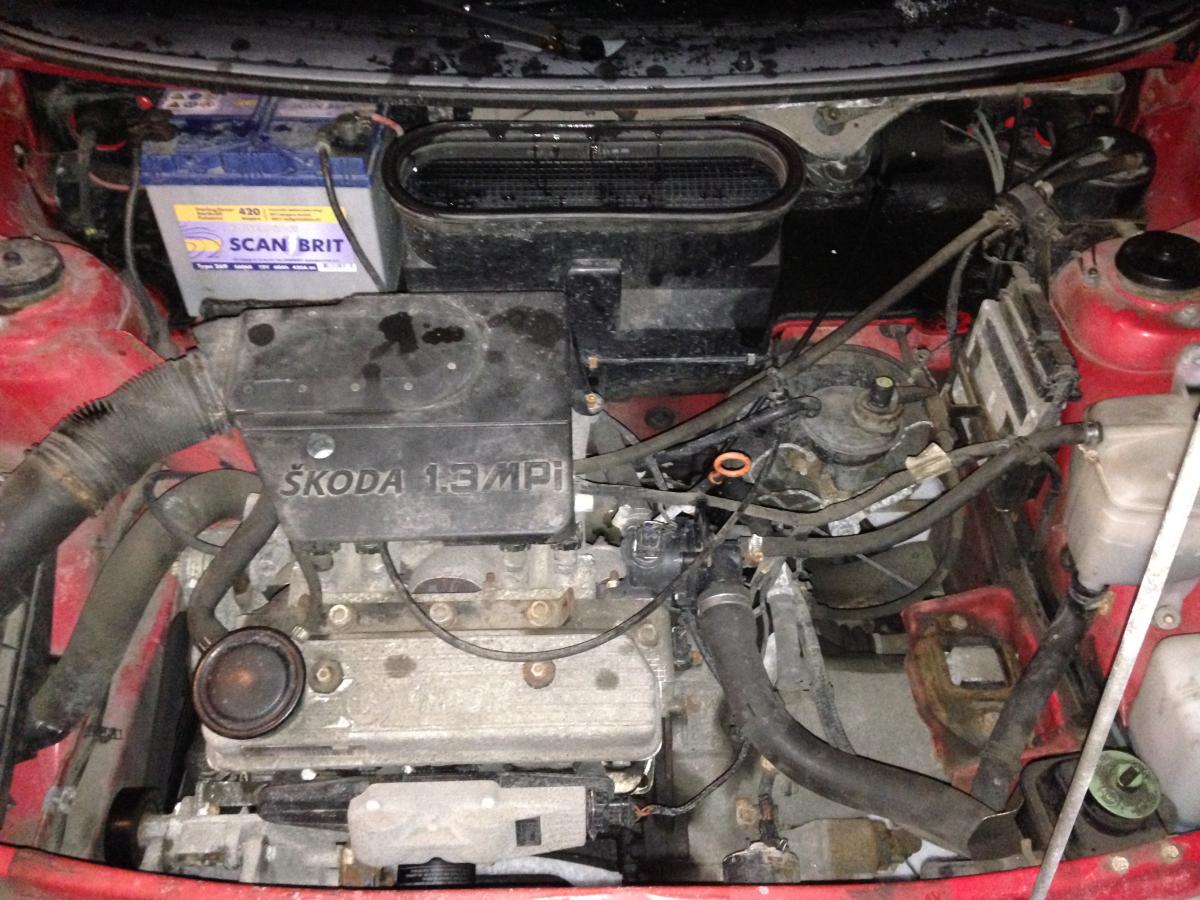

Thank you so much for all the information. I will have a better look tomorrow and post a photo of the engine and such. More thorough answers from me tomorrow, thank you again!

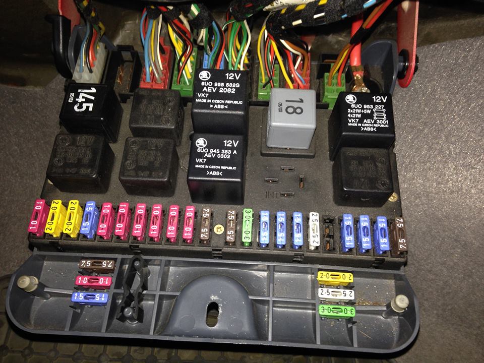

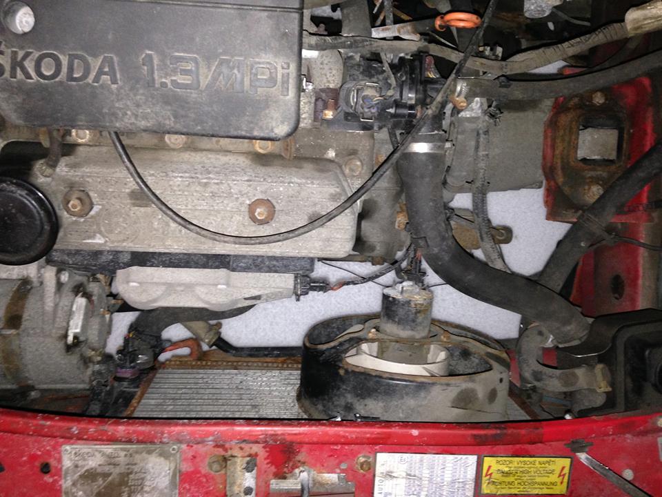

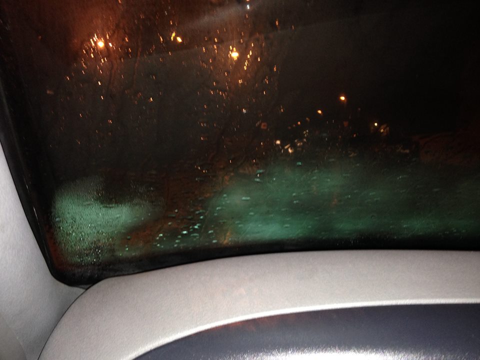

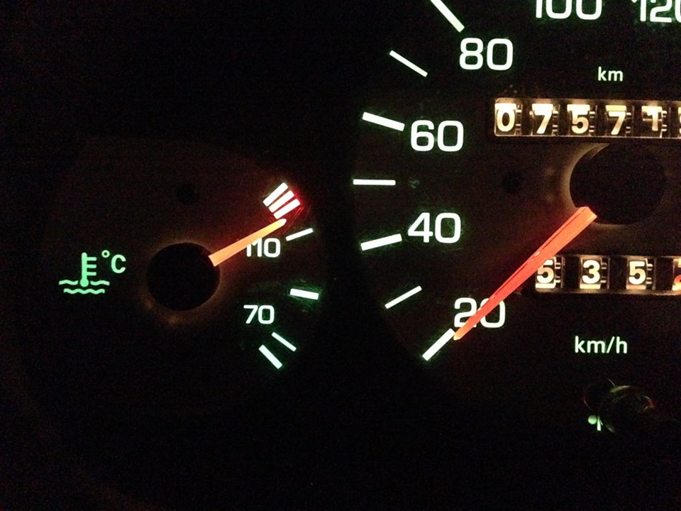

Here are some photos however of the engine, fusebox and the mist that formed so much that it was actually just wet, not fogged anymore.

The fusebox seems relatively clean and dry to me, so I'm guessing that there is nothing at fault there?
The photo of the temp gauge is from when it was sitting for some time and the needle went all the way up there, I turned off the engine upon noticing this.
As expected, it is a 1.3 MPi engine, not carburettor, LHD.

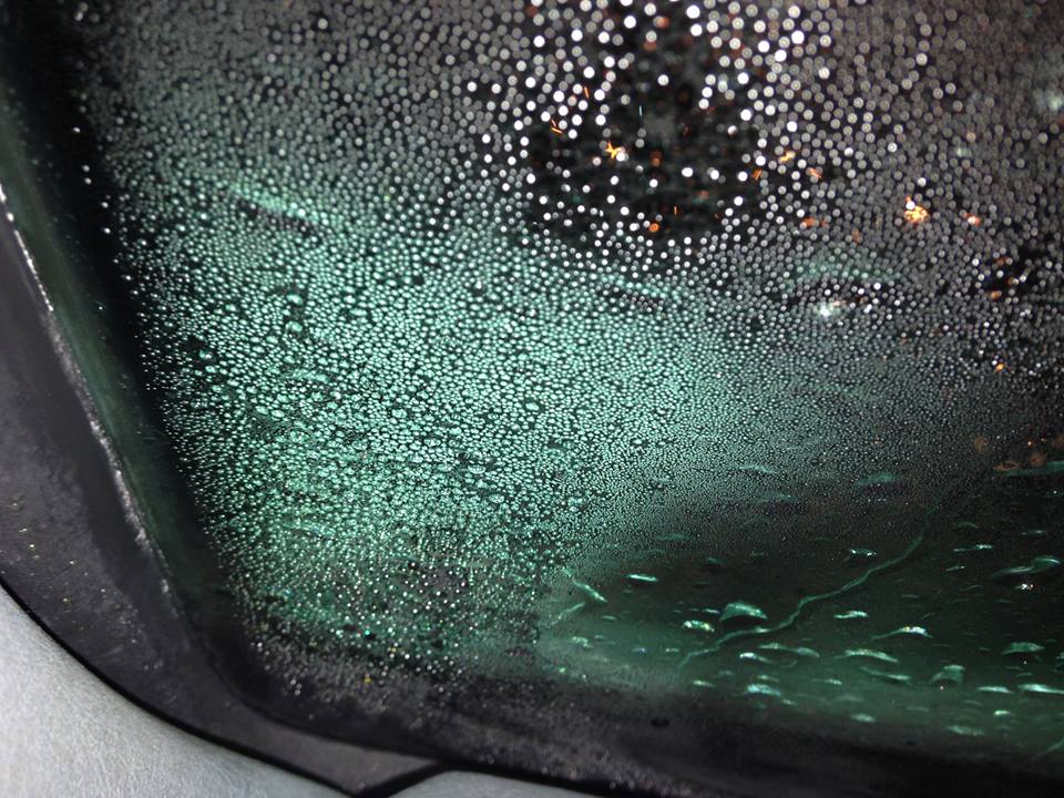

Fogging - it is something very annoying and very frequent for Felicia with no A/C during colder seasons. I would like to know too why there is so much condensation and humidity inside after the engine is stopped and the car is parked in cold air. Tens of other cars parked around me, none is fogged, mine is :wall: Same for my friends that own a Skoda Felicia.
The overheating - very dangerous, good thing that you noticed it. By the way, very nice zoom photo on temperature gauge. What digital camera are you using?

1)Check the fuses indicated below. Replace if bad.
2)Check the radiator fan switch (see location below) Unplug the two wire connector, clean all corrosion.

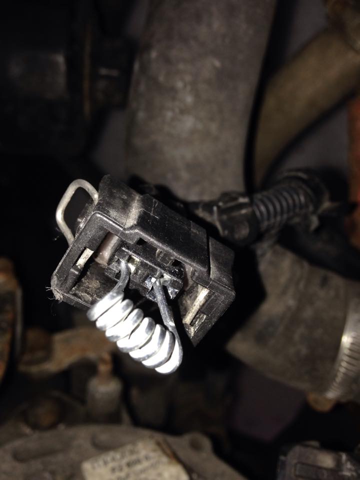

3)Jump the connector terminals with a wire (see photo). Careful not to touch car body with the jumper. Turn ignition switch on. Radiator fan should start. Switch ignition off, remove jumper, plug back the connector to radiator fan switch.

Ok, so I checked the fusebox again and swapped out the yellow fuse for a white fuse in the blower fan and checked the radiator fan fuse and all looked good.
Then I jumped the connector terminals, first with the wire from an old auxiliary cord and when that did not work I used the metal part from a laundry clip (See photo). It didn't work, neither the radiator fan nor the blower fan came on.
What do I do now?

Thank you so much, this helped a lot with jumping the connector terminals. I'm one of those where a picture helps, so much!
Regarding the photo of the temp gauge, I used my iPhone and put the camera close to the gauge and focused and snapped a picture :) Thank you.
