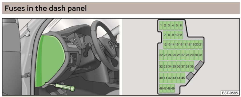

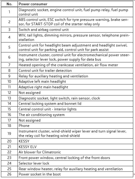

Looks fine to me. Must be wiring related. Looking at the fuse layout there is nothing obvious that indicates it's on its own circuit: http://www.briskoda.net/forums/index.php?/topic/319178-Abeo-Dash-Cam/page__view__findpost__p__3921027

All the fuses are listed in the owners manual in the glovebox.
I can't see any of the fuse descriptions that relate directly to the boot light / torch.
Does the 12V power socket in the boot work?
I wonder if the boot torch is connected to this system i.e fuse number 26, its the nearest fuse in terms of relevance in the manual...
