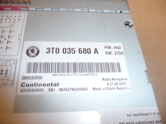

Hi,
The unit which I purchased secondhand is a Columbus with numbers 3T0 035 680 A      HW:H42    SW:2724  if this means anything to anyone.
Glad for any info regarding age etc.

Its older revision A units that that applies to, not part numbers with A at the end (confusing I know). Your unit is much newer, and can go to 4020 safely (or to 4120 with an updated gateway). In fact I have a revision A and took it 4020 with little trouble anyway.

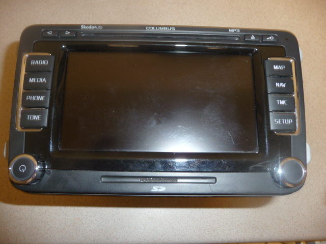

Thanks for reply I was beginning to think I'd been sold an old model .I connected power to the unit today and was asked to insert the navigation disc I never had a disc with it what do you suggest I do? Is this normal I thought the maps were on the internal hard drive or is this a different disc?
KenB.
If it's asking you to insert a nav disc then it's possible that the unit is faulty. Someone else bought a nearly new one on here a couple of weeks ago (from Ebay, not here) and it was doing the same thing. He's just sent it back for a replacement. Who or where did you get the unit from?

Managed to post pics on herepost-125733-0-30479100-1420919116_thumb.jpgpost-125733-0-78035600-1420919144_thumb.jpg
