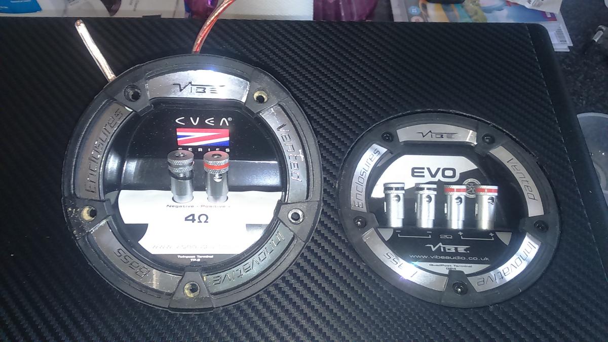

Sub arrived this morning, however before they mount it in the enclosure they wire it in parallel so there's only one Pos and one Neg post  :wall: .
Would anybody know if it would be ok to join both the negative and both the positive cables together, then attach to their respective posts on the sub enclosure?

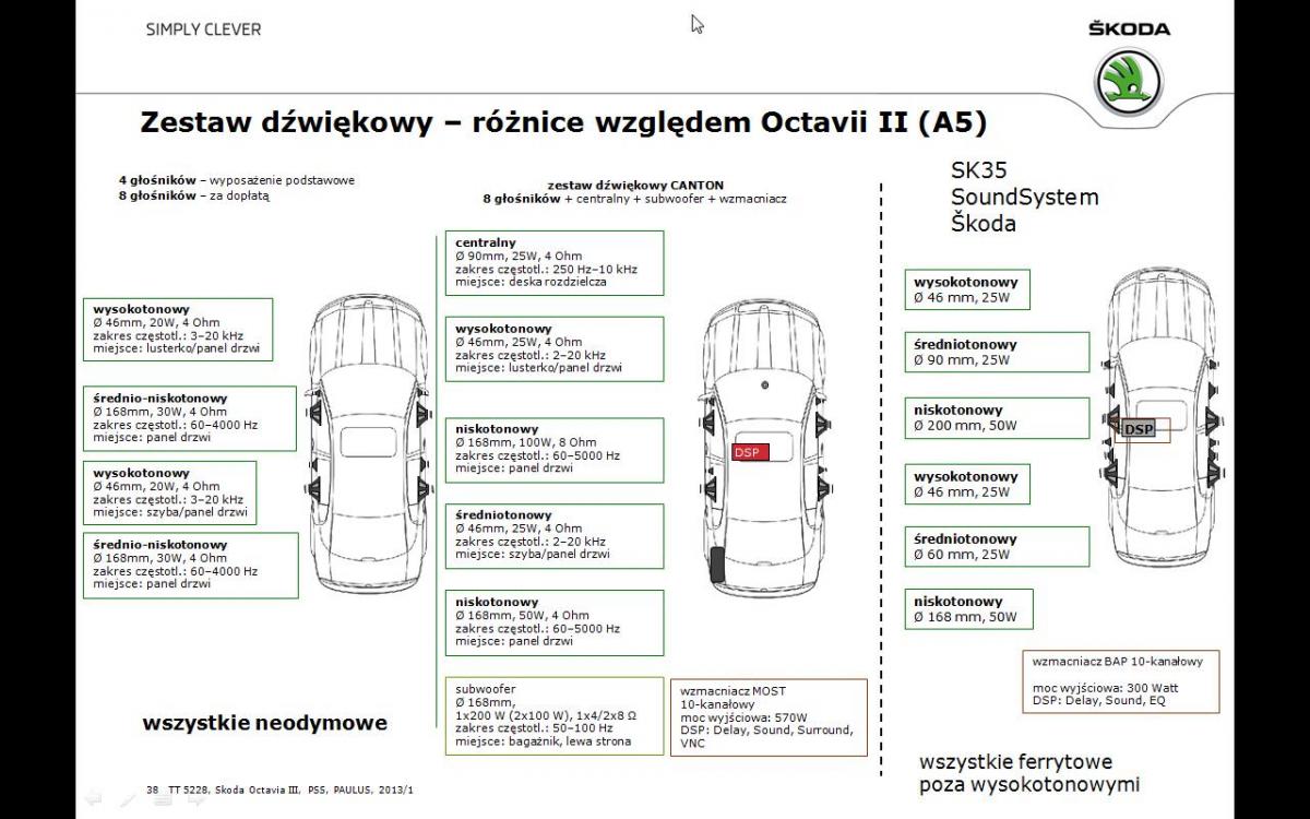

Looking at the link to the Skoda speaker sizes and wattage, it says that the sub is 2x100 Watt so my thinking is by joining them will give the 200 watts total.

Alan at Vibe had tried to ring me on the Friday but as previously said my land line is u/s, so he took it upon himself to send out a replacement four terminal sub connection unit for the enclosure, with a covering letter saying that I have permission to change them and it won't void the warranty.
They haven't even asked for the two terminal unit to be returned!

I posted a picture a while back of the differences, but its mostly the Sub, additional speakers throughout the car and a digital DSP and separate amps to send only the required frequencies to those speakers.
Post 8 in this thread, the image shows the standard audio to the left, and the Canton in the centre.
http://www.briskoda.net/forums/topic/310206-canton-sub-pics/
Replacing the factory amp is not possible, because it receives a fibre optic input containing digital data, so in addition to the amp, its also the DAC to get the audio out to the speakers. The speaker outputs are also frequency limited and each is driven separately by the amp.

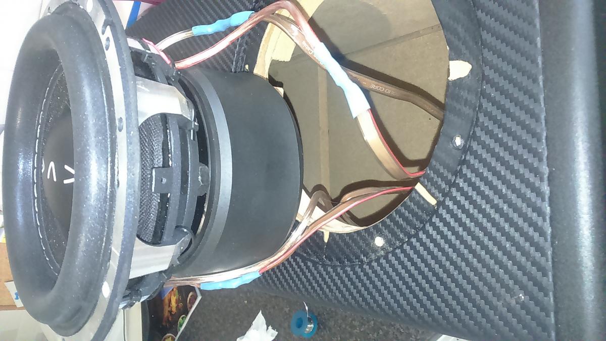

In and running, however wasn't as easy as I thought it would be.
The speaker was wired in series inside, so it wasn't just a case of changing the terminal connection but I had to remove the sub and separate the cable joining one pos that was joined to the neg on the opposite voice coil.
I then had to solder the new terminal mount cables to the respective + and -- on each side of the speaker to each voice coil (hope that makes sense).
I purchased some miniature spade connectors from Maplin so I didn't have to cut any of the original wiring loom, these I then pushed into the respective terminal where the original sub wiring disconnects from the Canton sub enclosure, thankfully Skoda have used a simple colour code on the cables, they use brown as the earth colour in the loom and red for the live.
In the original connector there is two grey wires and two white, on each of those one has a red tracer and one has a brown tracer, so dead easy to work out, grey with red tracer to the + terminal on one side of the speaker and grey with brown tracer to the -- terminal on the speaker, then likewise on the other voice coil.
Where the miniature male connectors fit into the factory loom I used plenty of insulating tape to ensure nothing separates, then it was just a matter of feeding new cable under the side trim to roughly where I wanted the speaker and connected it up.

Hopefully attached are a couple of photo's
These are the two fittings that needed to be changed over (new one installed).
A comparison in size, if you hadn't guessed the Canton "sub" is on the right!
All the new connections soldered and heat shrunk, ready for re-installation into the new sub enclosure.
As for extending the frequencies then a most definite yes, it's not going to give you the response of say a 10/12" sub/matched amp as it's only 6.5", but it's certainly an improvement over the "upgraded" Canton speaker!
