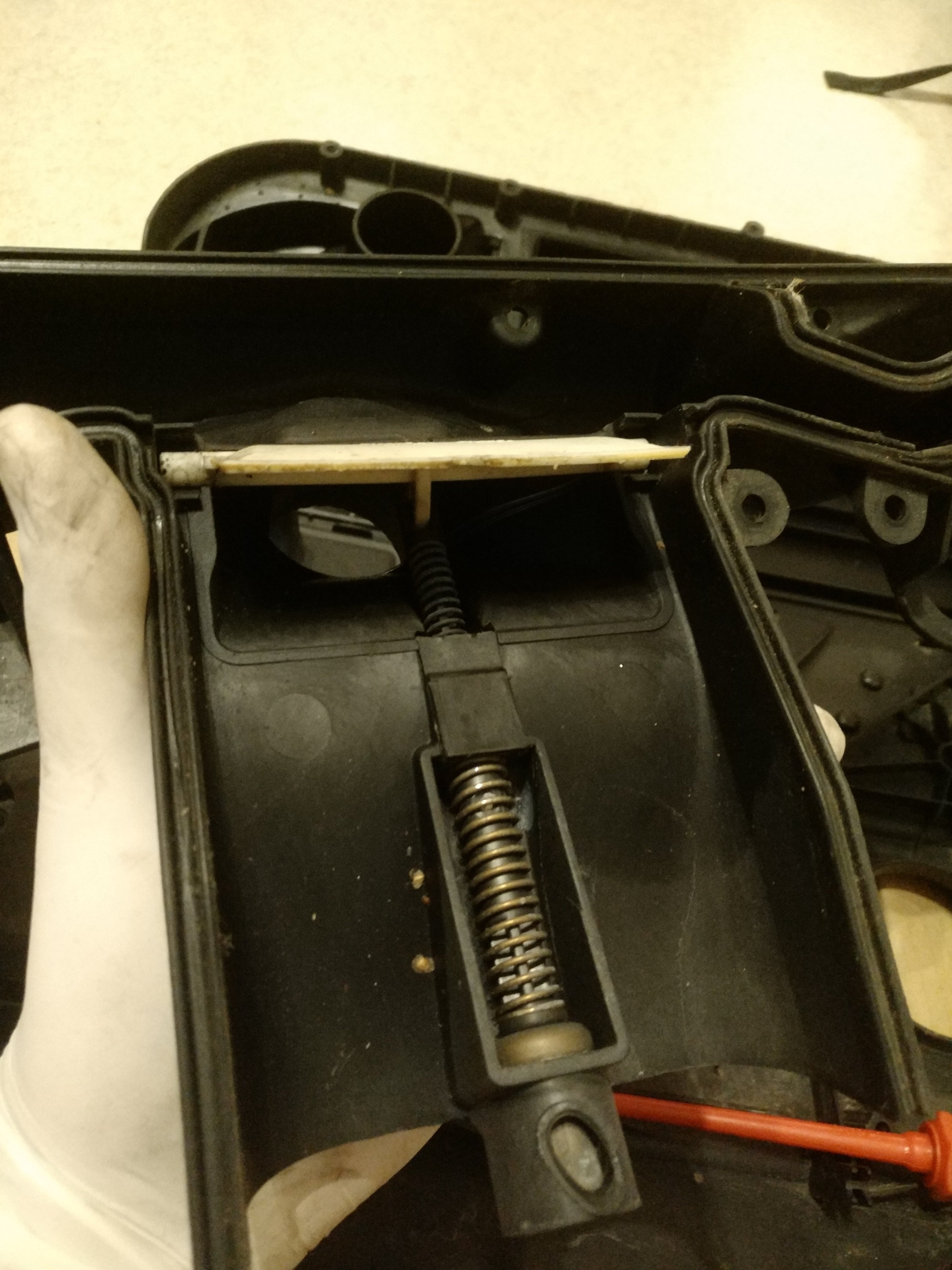

@Wino Yes it is possible if one removes the black cover piece in the middle. Then it is possible to remove the flap first. It needs to stand perpendicular to be able to pull out. It is connected to a shaft which is flat at certain location.
The plastic piece in the middle is just glued down there, it can be pried broken carefully or cut open perhaps. If it is not removed, the only way to extract the flap is by pulling the arm with smaller spring back with some sort of tool so you can open the flap perpendicularly. The arm with smaller spring goes inside the arm with larger spring. I bet VW has a tool for it at factory...
After that if the thermostat pin is completely inside the thermostat, it is possible to push it out carefully. If the pin is out, then you can freeze the part to get it back in. But also it is possible to dislodge the screw piece to go behind the pin and then push out thermostat. Much more difficult that way. But I managed to also get it back in.
Actually I could just pull out the pin from the thermostat and filled it with molykote 111 compound and it somewhat works now. It is able to push the spring about 5.5mm when I heat it with hair dryer. I shall experiment with it a little bit more :)
... makes me realise how much effort I've saved shutting the flap in the cold position. Also why would Škoda send cars to subtropical climates with such airbox design. Contemporary Mk4 Golfs with the BAH engine had the same airbox without the flap.

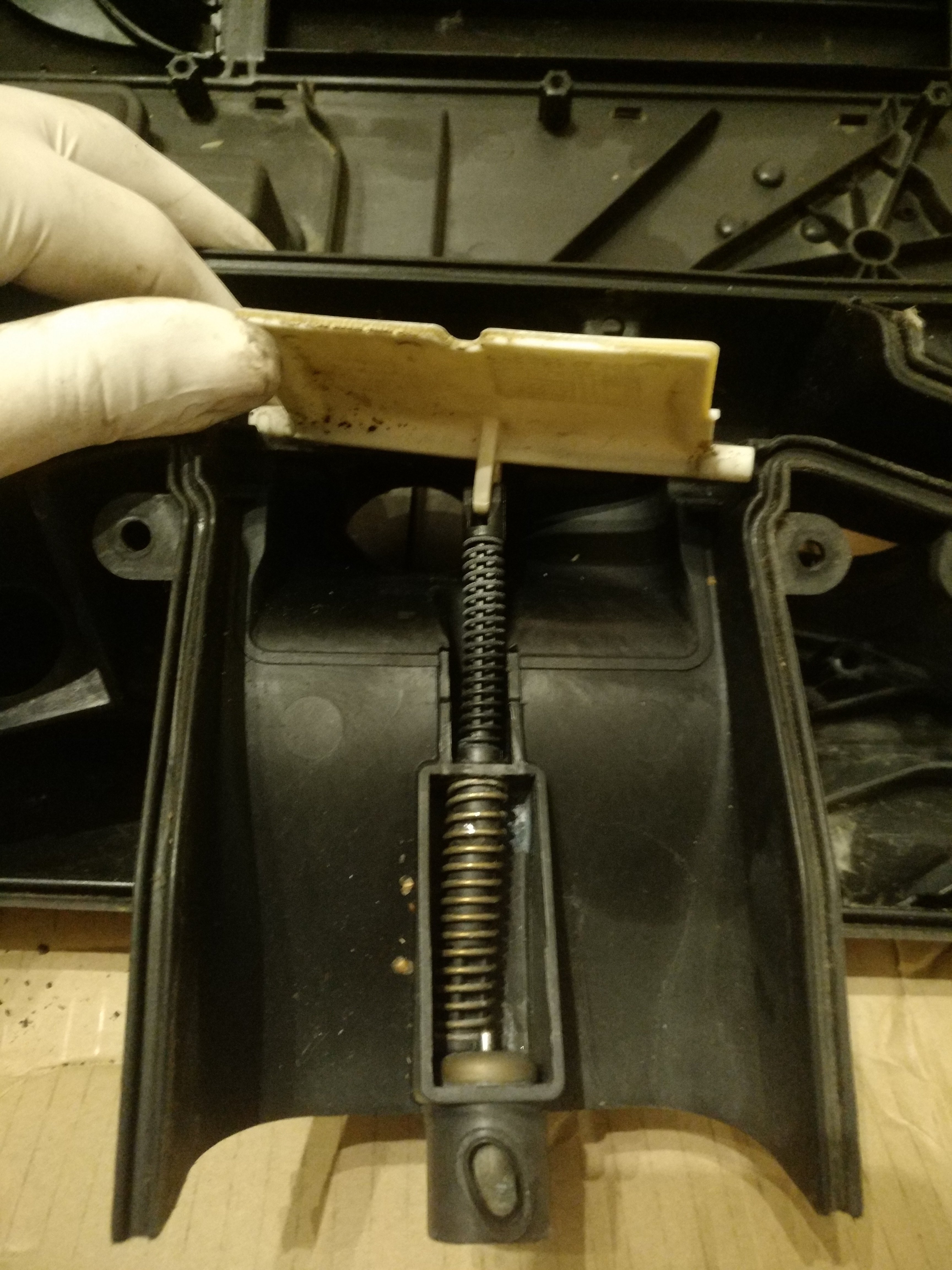

@Wino I managed to remove and insert the thermostat. There are 2 things which help it.
1- Remove the small plastic cover in the middle.
2- It is much easier if thermostat is totally retracted (eg. cold)
My thermostat was moving about 5mm between cold and hot. But it is not enough, I put some o-rings and a heat-shrink collar around them to lift the thermostat slightly. Although this makes inserting things back slightly more difficult but not impossible.
Now from 45C-50C, the temps went down to ~30C. Not sure if it can go any lower as housing takes air from right lower corner, next to battery. I should perhaps put a wireless thermometer there and measure the intake temps next to that hole :)

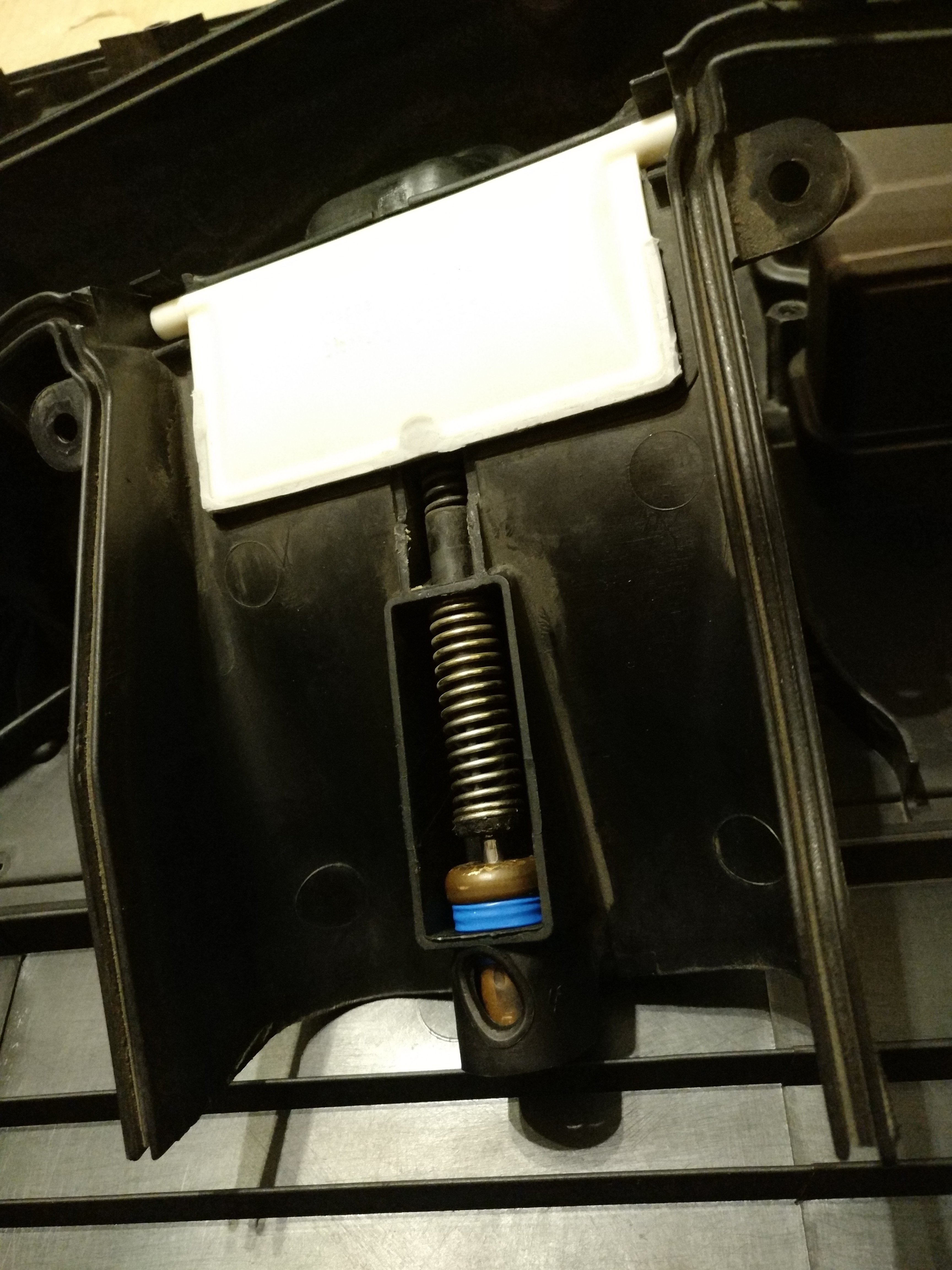

Some good work there my friend, I don't know which other cars may use a similar arrangement, but I suppose there must be some.

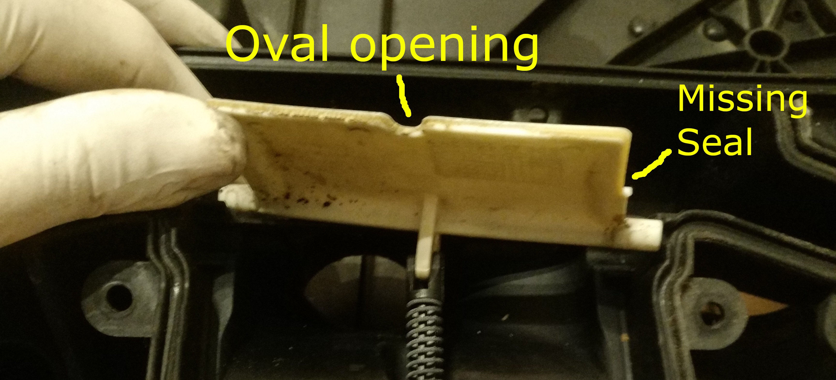

@Wino your flap seem to have this red lip around the flap which I did not have. Although it looked like there was something but it crumbled away...(see attached picture) :)   I made a silicone border, but I like your flap more... I guess your cover part number is 036129607CS ? http://www.oemepc.com/vw/part_single/catalog/vw/markt/RDW/modell/PO/year/2009/drive_standart/253/hg_ug/129/subcategory/129015/part_id/0/lang/e#sec_1
I have 036129607CN but it was discontinued in end of 2003 and new model is 036129607DP :) I wonder if it has the nicer looking flap like yours. That is just an expensive part due to a small thermostat, so annoying... These boxes seem to range from 100euro to 300euro from vw/seat/skoda. If I buy Volvo thermostat it costs 50euro with shipping... :D
Apparently there are many vehicles using similar thermostat but none has thermostat as a replaceable part. Even in some cases thermostat is outside the air filter housing. Like 1.2 engines with cover 03D129607K... it is a huge oversight to not make the thermostat a replaceable part I think....
