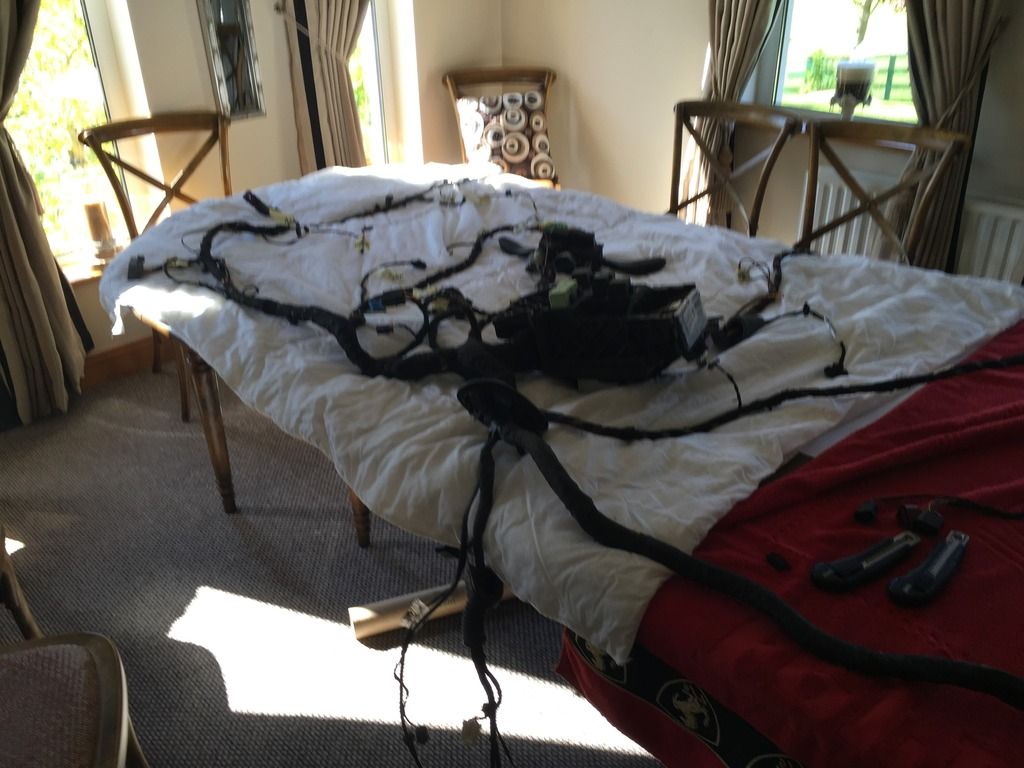

been awhile the guy doing the cage broke his arm going up on wed to get seat position and steering wheel position sorted will have some photos  started stripping the wiring loom 5.1kg out of it already .

workshop on the dinning room table needed room to keep the wiring loom all together when i untaped it .

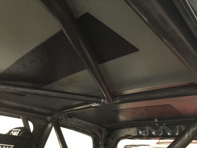

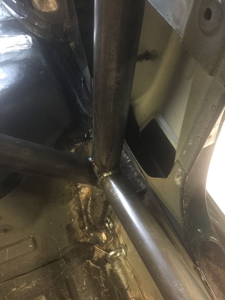

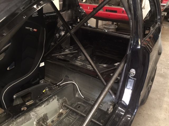

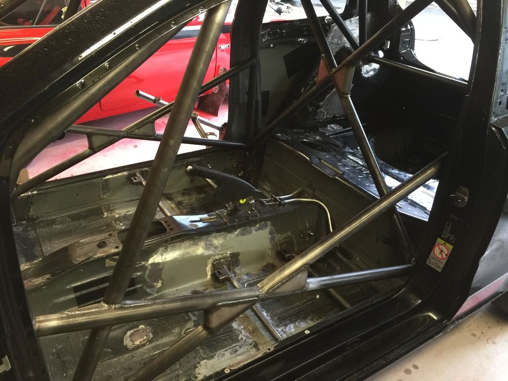

Hi roll cage finished excellent job by wishart engineering  t45 full international spec cage with axel stand points strengthened suspension points steering column support seat rails . Next job prep for paint and removing underseal from the arches and the floor heat gun and scrapper not looking forward to this .
