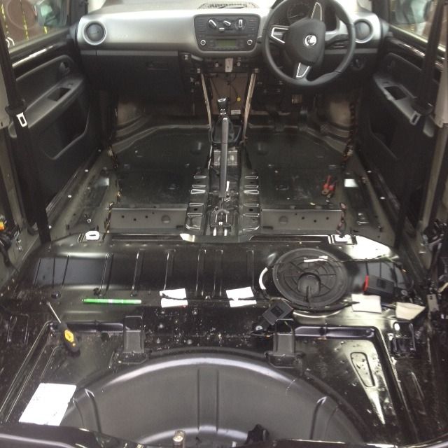

hi iam  starting building a citigosport junior rally car form a damaged citigo sport will update as the work progress. A few pictures of the car first job i have started is to strip the car for the weld in t45 weld in roll cage to be fitted . The car will go to the jig next week to the passengers rear corner pulled . I started falling last year in july when i got my junior rally lic on my 14 th birthday i have done a few rallies in my citroen c1 and Liam competing this year in the full championship.

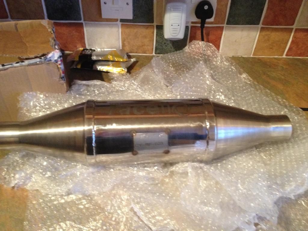

Our regulations are very strict the engine must remain standard ecu standard exhaust can be changed we will fit a vortex the inlet sid can be changed we will fit an airbag in the bumper ,  suspension can be changed we will fit  3 way reiger coilovers . weight is big problem our minimum weight is 950kg inc driver and codriver so a lot of weight reduction.

started stripping inside out today
shows the crease at the back that needs pulling going in the morning to the jig

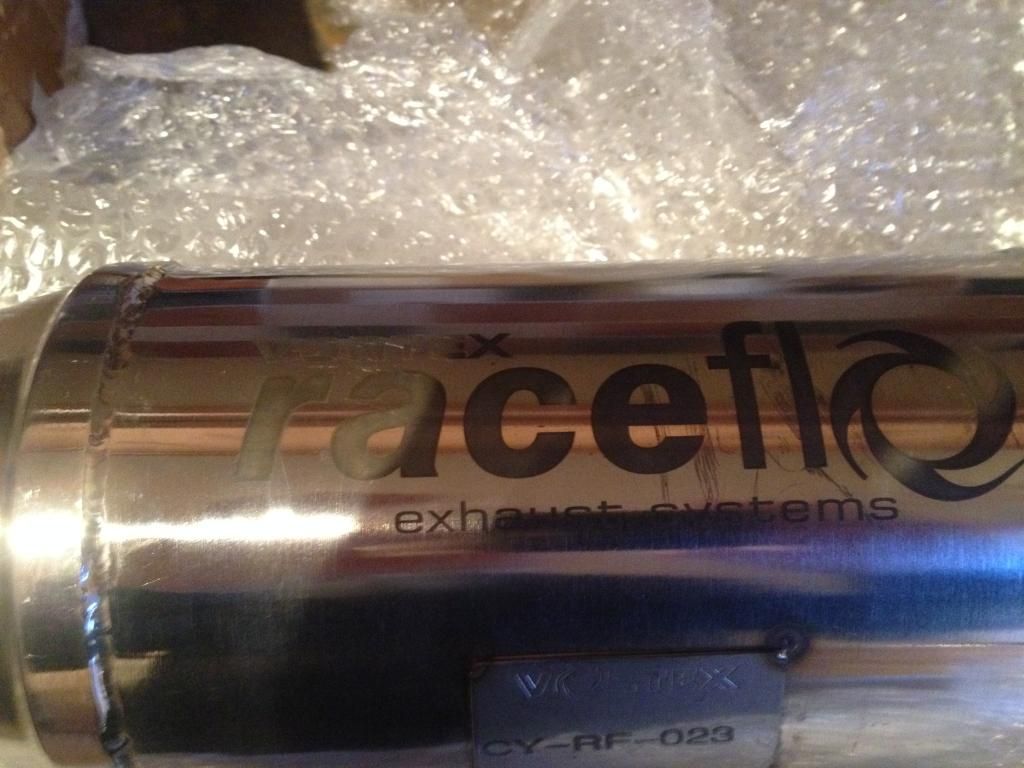

2" vortex exhaust system  with sports cat  and induction setup  head skimmed slightly  and fuel pressure regulator with increased fuel pressure.

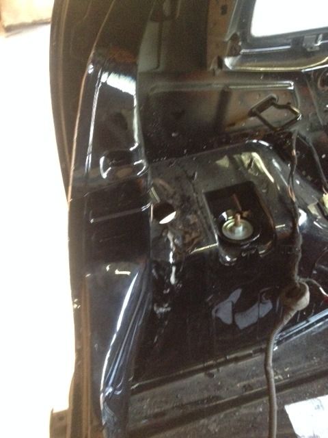

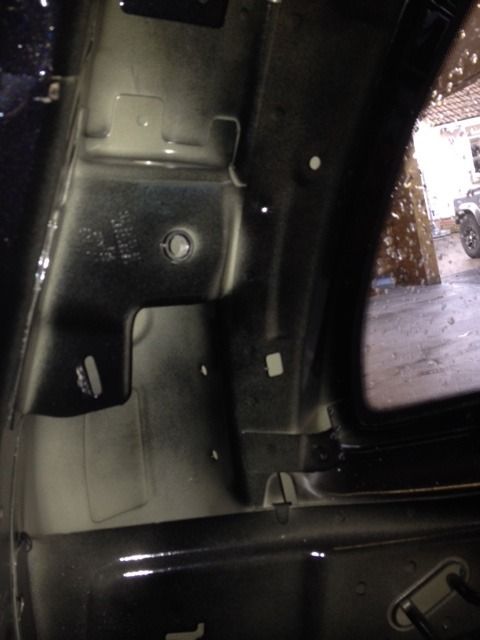

Hi pben123
Is it possible you can take a photo of the inside section where the rear seatbelt mounts to on the offside?
I need to see if I can gain access to a small dent I have on the outside that I can push out from the inside.
Thanks [emoji106]
Hi pben123
Thanks [emoji106]
hi will do on thursday car away to the body shop to get the corner pulled
Thanks I appreciate that [emoji106]

car back from the jig pulled out really well  these are strong cars guy at jig said it wasn't a easy pull took a lot of force  ready for a small bit fillers and paint

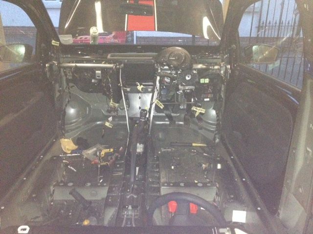

need to keep stripping parts
Dash removed making slow progress

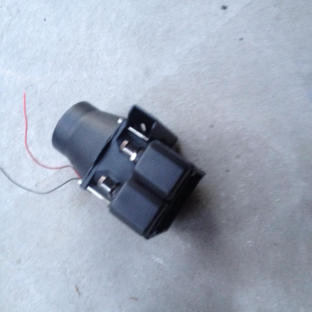

new light weight heater our regs say we can chnage the heater but must have hot air blowing on screen through orginal vents. this weights 1.2kg the one in the car weights 13kg more weight saving
Edited by pben123
Flipping nora! 13kilo's? That's a lot
