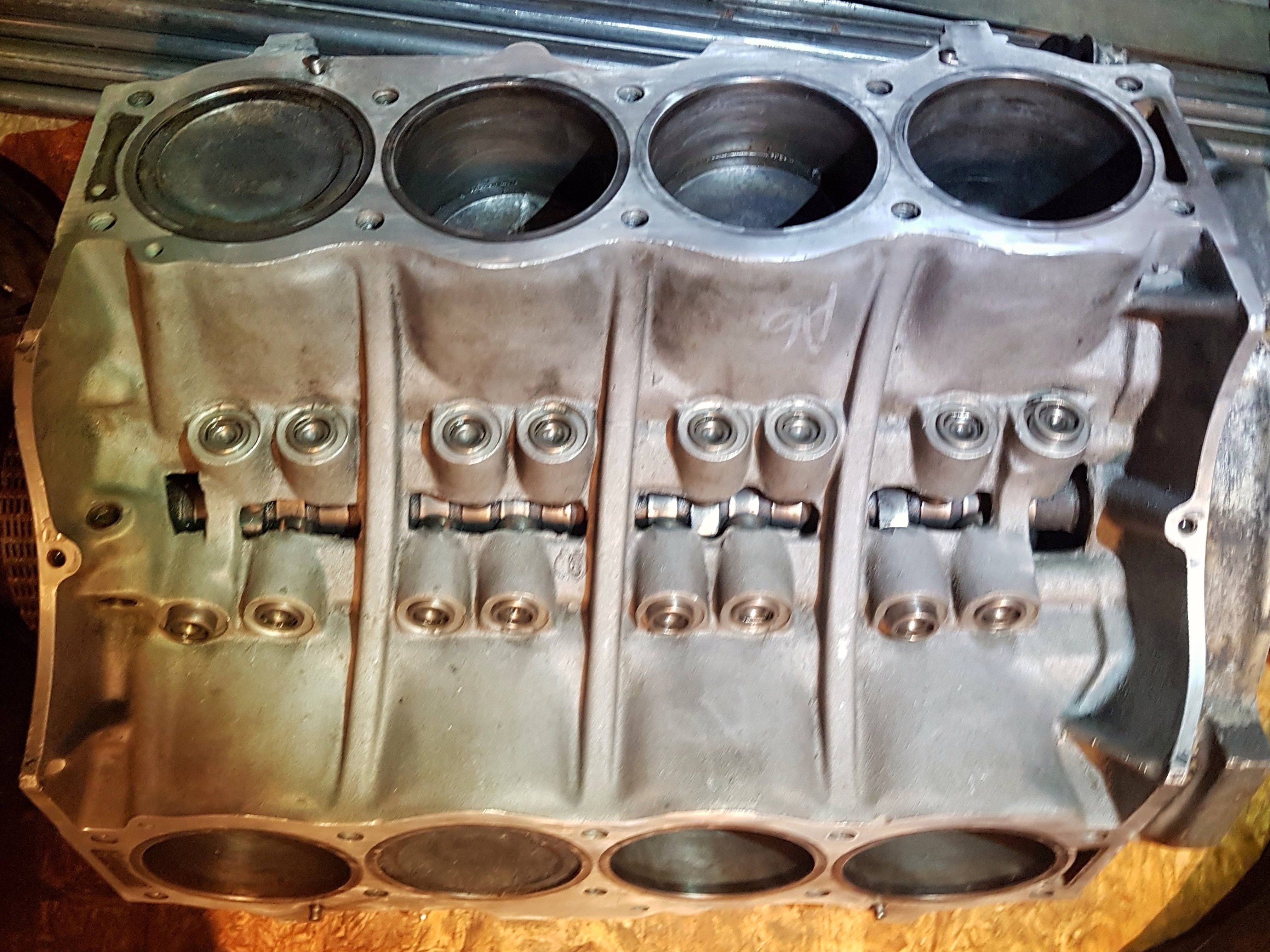

'Fraid not Wardy, the cooling system is pressurising, spitting out the water, even when it hasn't fully warmed up. Thought it was the header tank cap, but nope. Picked up some more heads for it from a 4.2 engine (£50) and had them refurbished as I couldn't be arsed to do them myself. As long as the block is straight and no liner issues, should take a day to swap the heads and get going again. Just awaiting a free bay at the garage and some time to do it. If the block is shot, then it'll have to wait for the new engine.

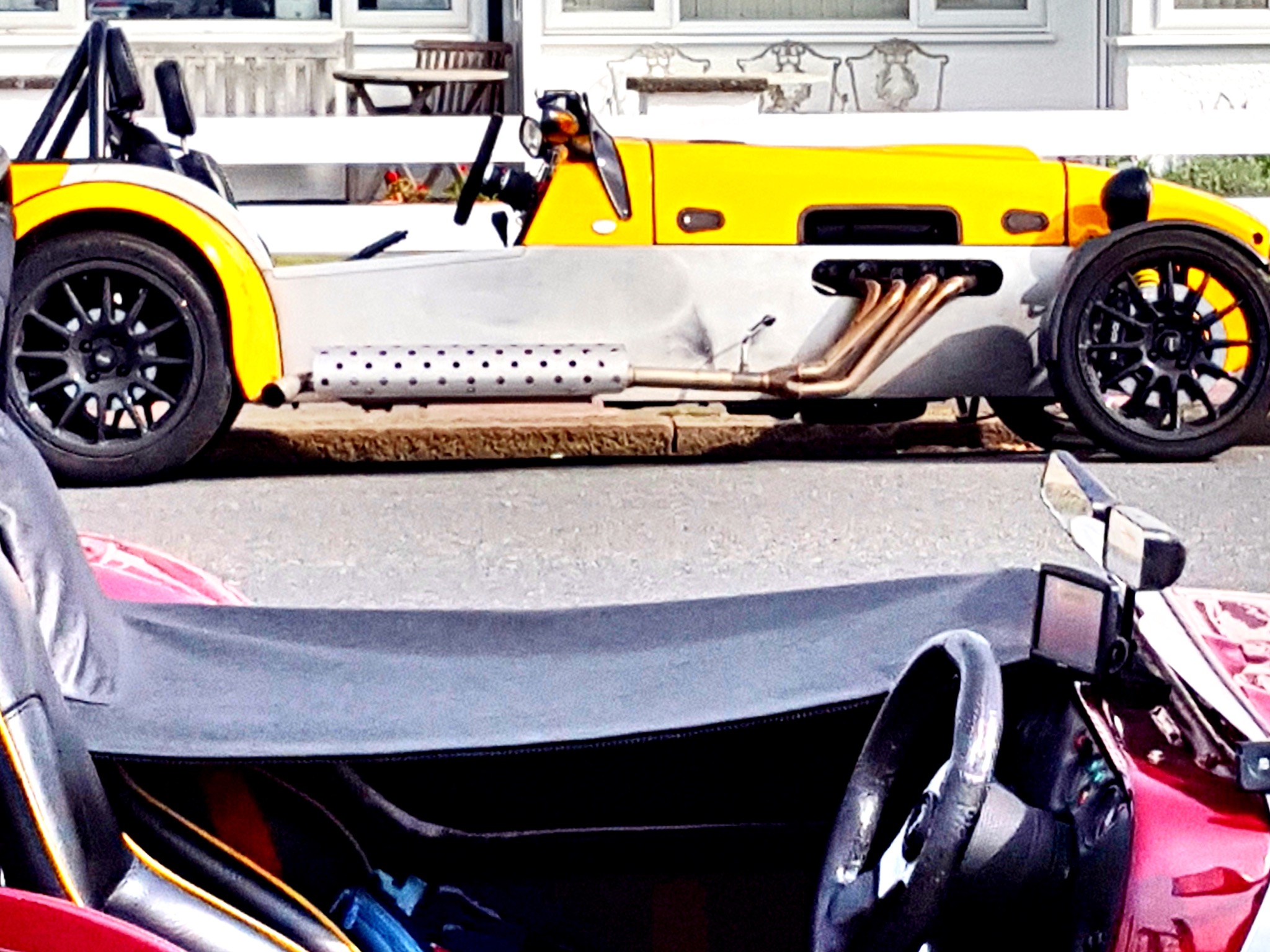

Here's an image from the last blat over the North Downs with Kenton and Weathers. K's got the same as me with a Rover 4.6 V8 running about 270bhp. his other car is a Westfield V8 running a 4.6 with over 320bhp. Weathers car is squashed between ours.. a dinky Westfield with a 170bhp Zetec engine.

Chasing another 4.6 block which has already been top hatted with modified liners, saves a bit on the cost and I don't have to wait for the machine shop to sort, so I could start putting the new engine together pretty soon. Still awaiting the new diff and new induction system. Will need to order a set of cometic gaskets for the new engine which take a little while.

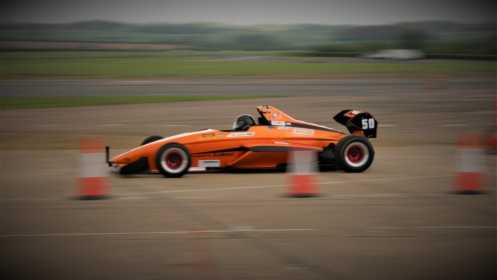

Popped up to North Weald yesterday to watch some sprinting and cheer on Jeff, one of the SKCC guys. He runs a supercharged Phoenix with 400bhp weighing around 600kg. 1000bhp per tonne. It's evolved away from its kit car roots it's almost unrecognisable. Jay (pictured with Jeff below) and the team at Snodhurst look after it, as well as giving me a bit of space very now and again. Latest additions are a wide arch kit and slicks. Second overall with the winner being the orange ecoboost formula Ford, below. A good day was had by all.

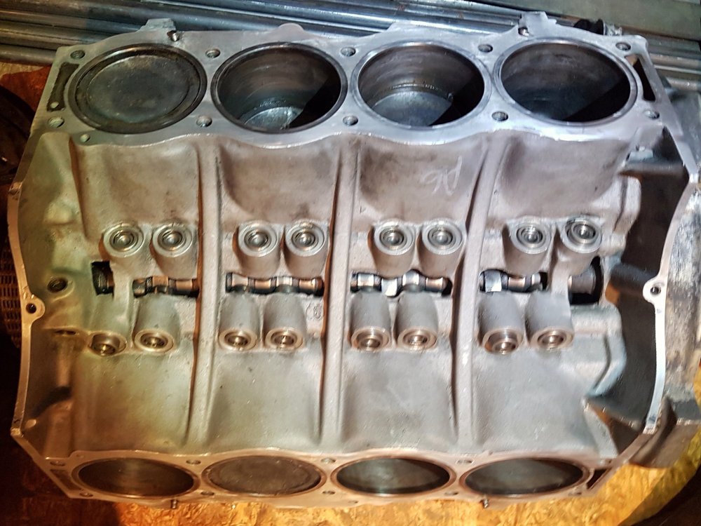

New 4.6 top hatted engine turned up, had a quick look over it, looks like a Land Rover approved replacement engine. Bores look spot on, and finished to standard size. Gulley looks really clean, usually goes brown then black with sludge as the miles build up. No camshaft or follower wear so looks promising. blocks been decked as the serial number which is stamped on the block face has been machined off in the process, probably enough to raise the compression a little to suit the Merlin heads. Need to crack on and get it built. Ball park bhp should give anywhere between 400-500bhp a tonne depending on final build spec.

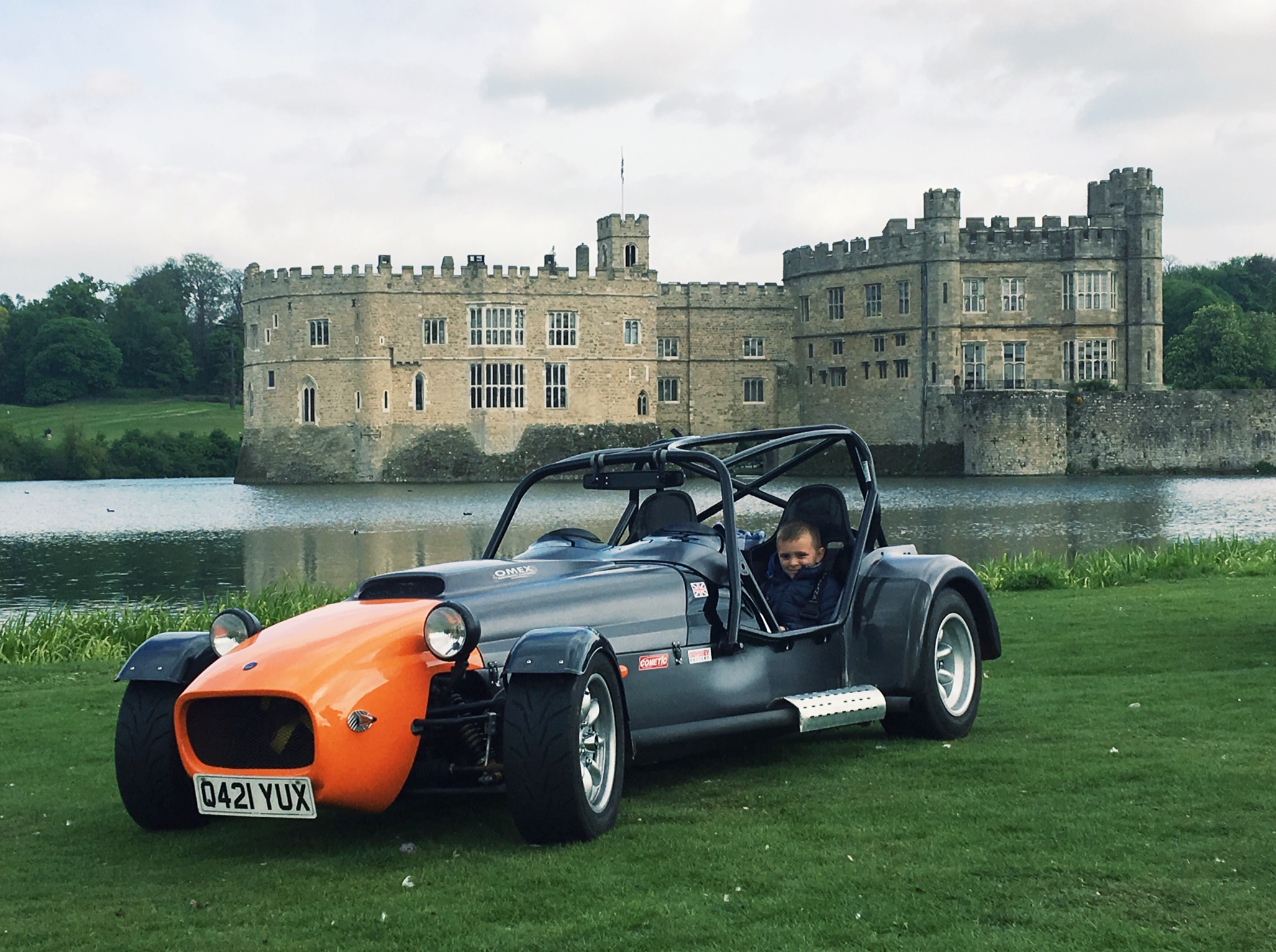

Good day at Leeds Castle, worth going to. One image below taken by Richard of his car, a great shot.

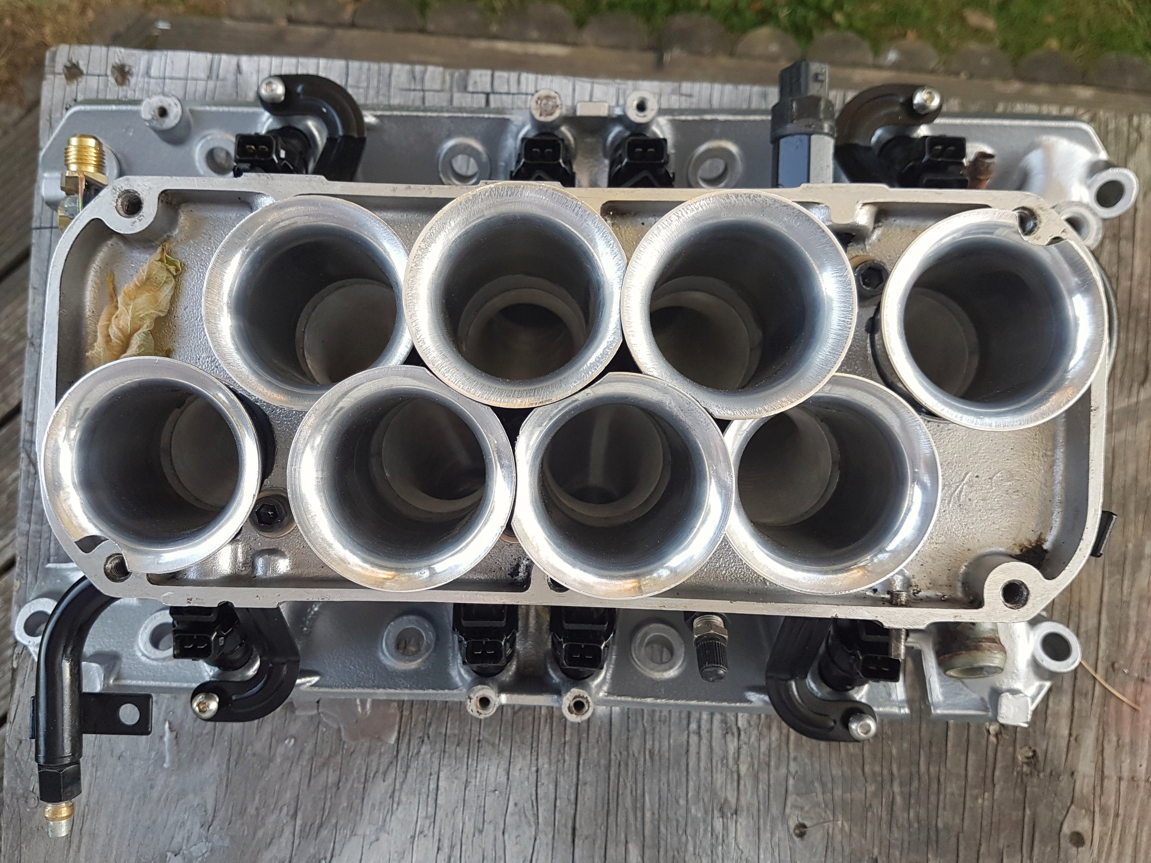

Grabbed the plenum base and manifold back from ACT so I can clean it all up a bit and reassemble the fuel rail etc. with some new injectors (440cc ford motorsport injectors) Be one less job to to when the throttle body eventually turns up. Only been 4 months..

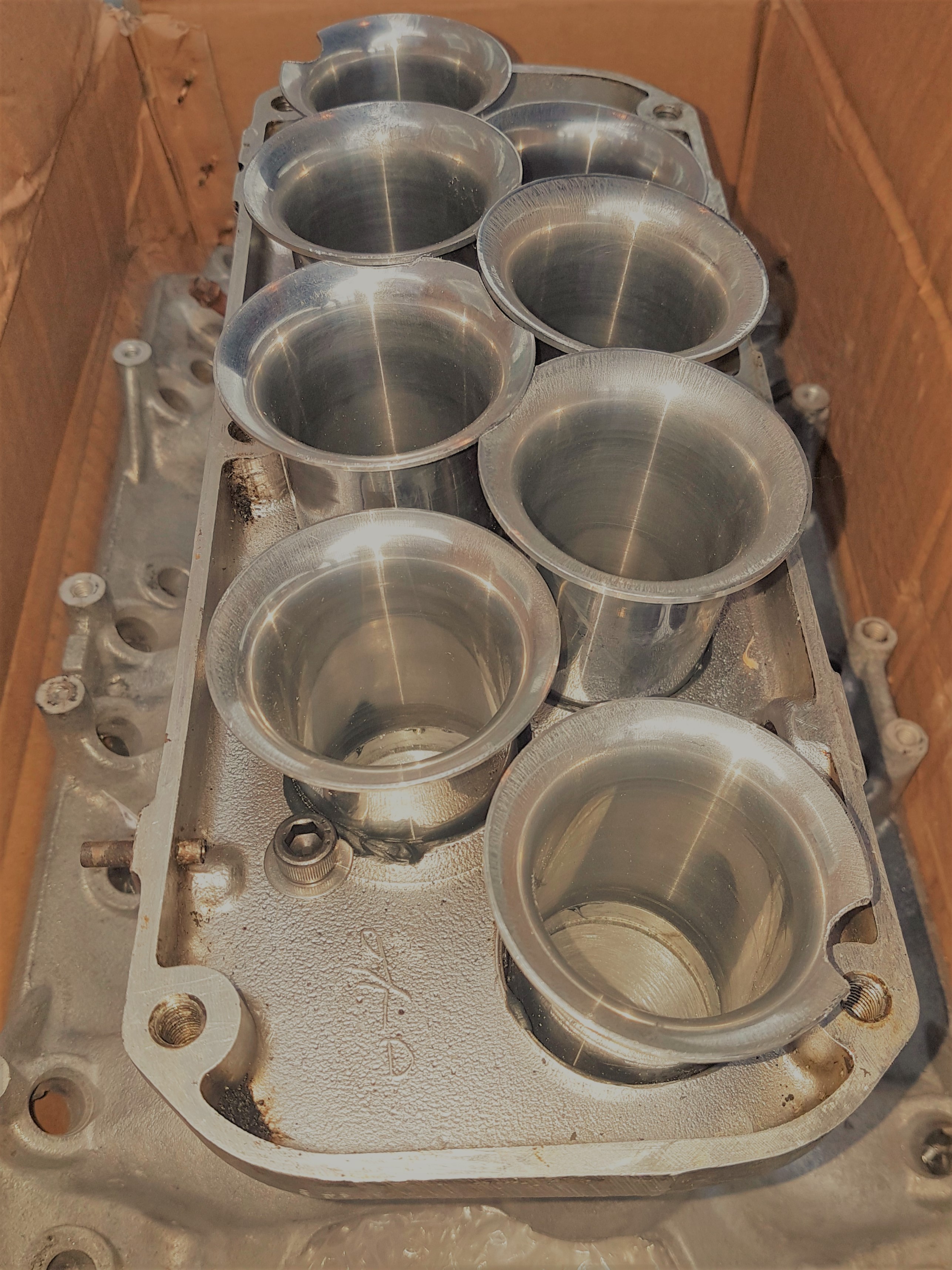

The manifold and plenum base has been ported to 45mm from 38mm with new aluminium trumpets to match, more air means more fuel which gives more pppoooowwweeerrr!! and no doubt a few more stoppages for refuelling :D

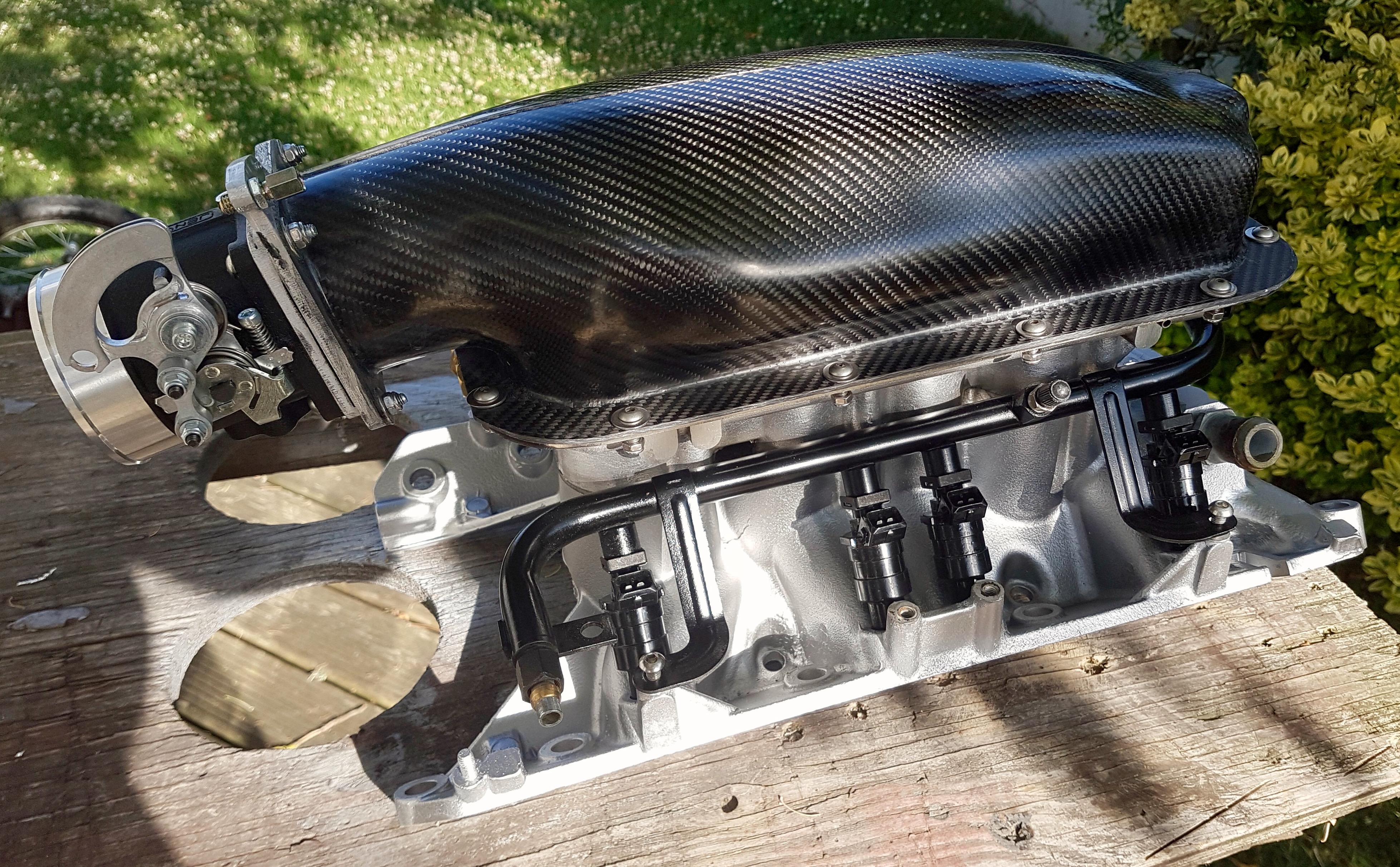

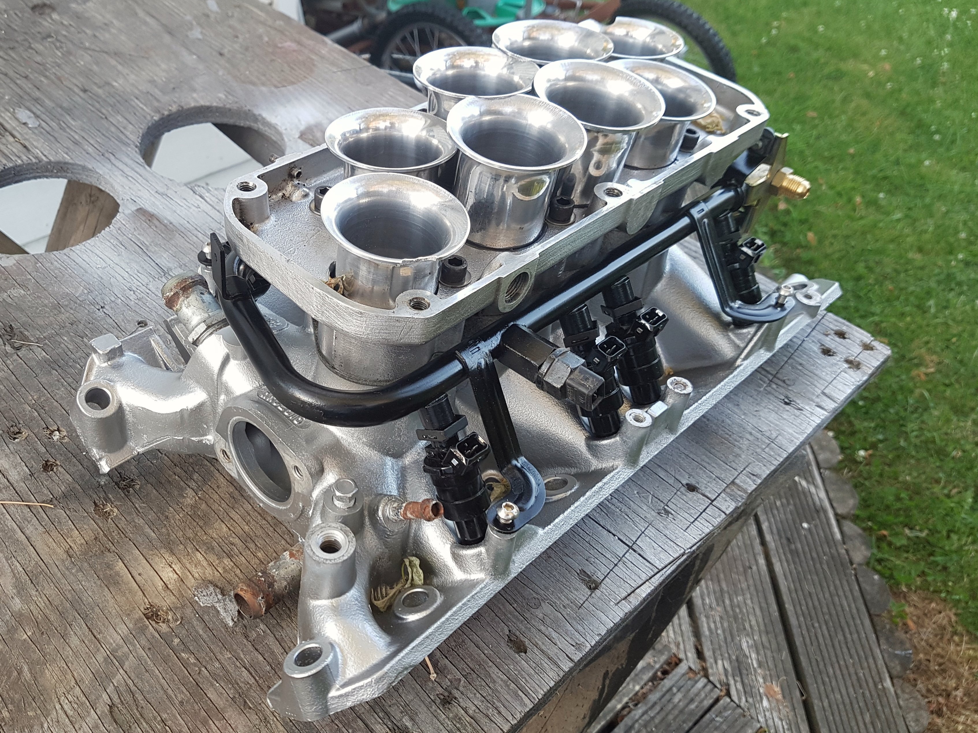

Injectors turned up from the states, so painted and assembled the intake/plenum/fuel rail, one less job to do.
