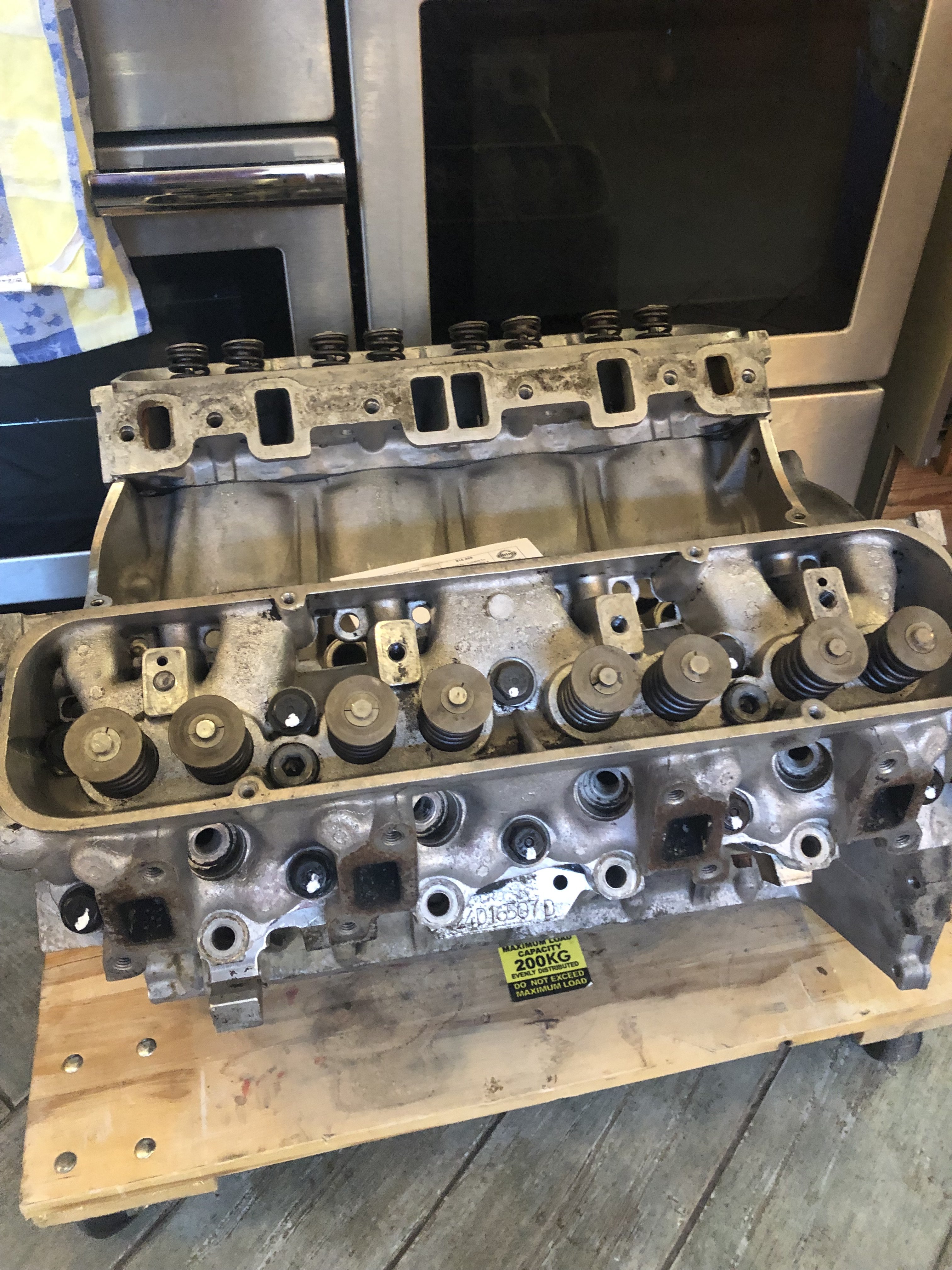

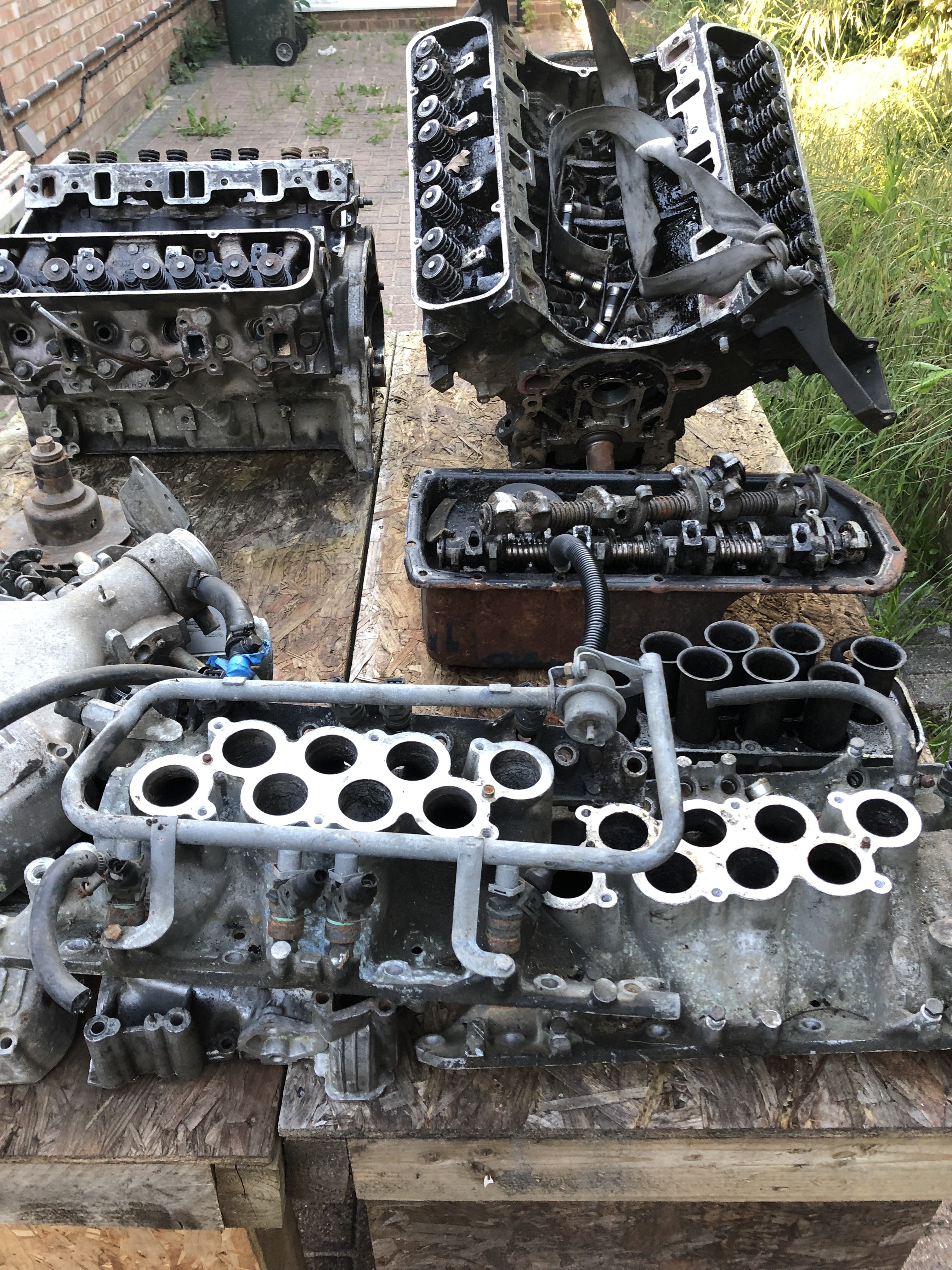

Bought a job lot of Rover 3.9 lumps at the right price. Going to make a good one out of three and throw it in the kit to get back on the road for summer. The 4.6 is a major ball ache to transplant at the moment, this way gets the car mobile again quickly for not a lot of money.

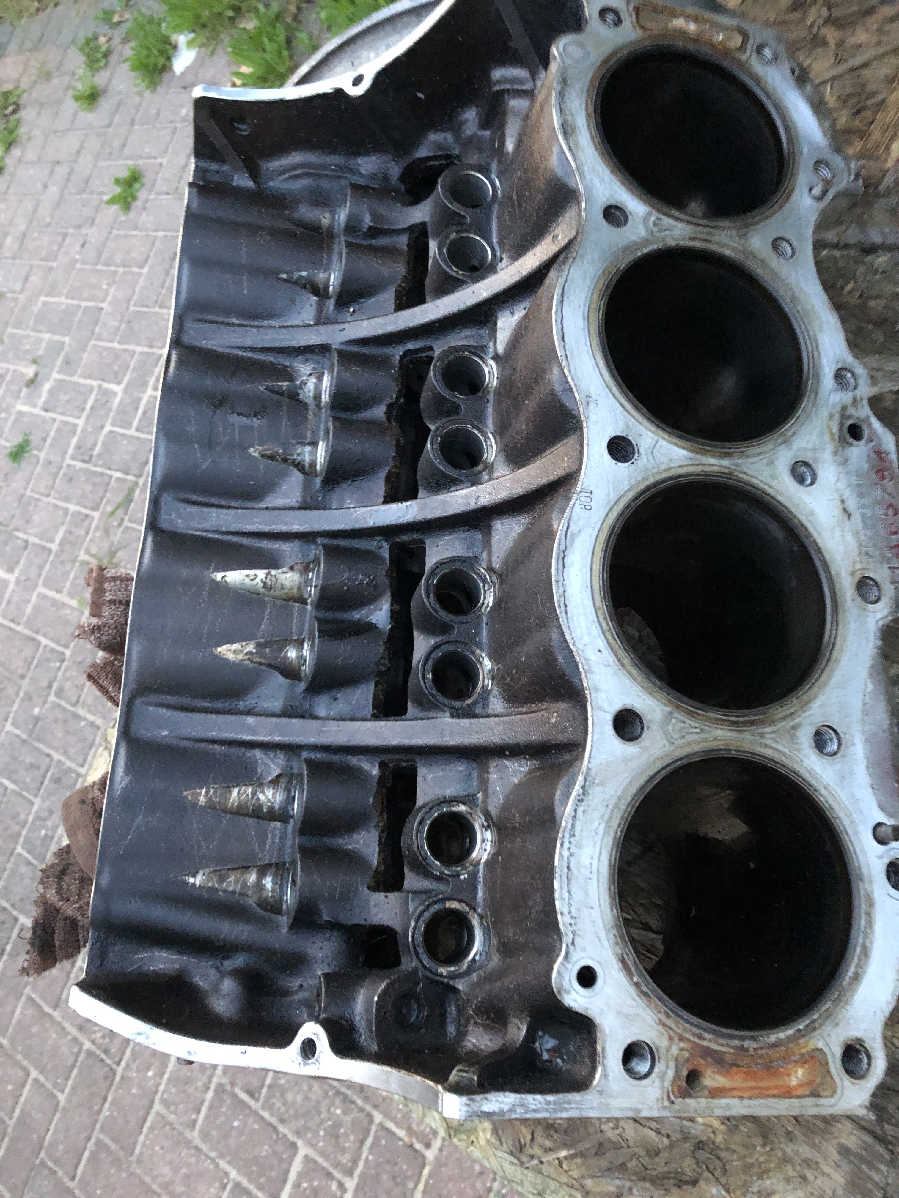

All parts ordered, engines picked up, one stripped down. Crank is shot though block is usable. Fingers crossed for a usable crank in the other engine.
Pieced together an engine, new shells, rings etc. The engines are 3.5l units, a bit down on power but not going to split hairs over a few horsepower. Should be ok for 190 - 200 bhp.

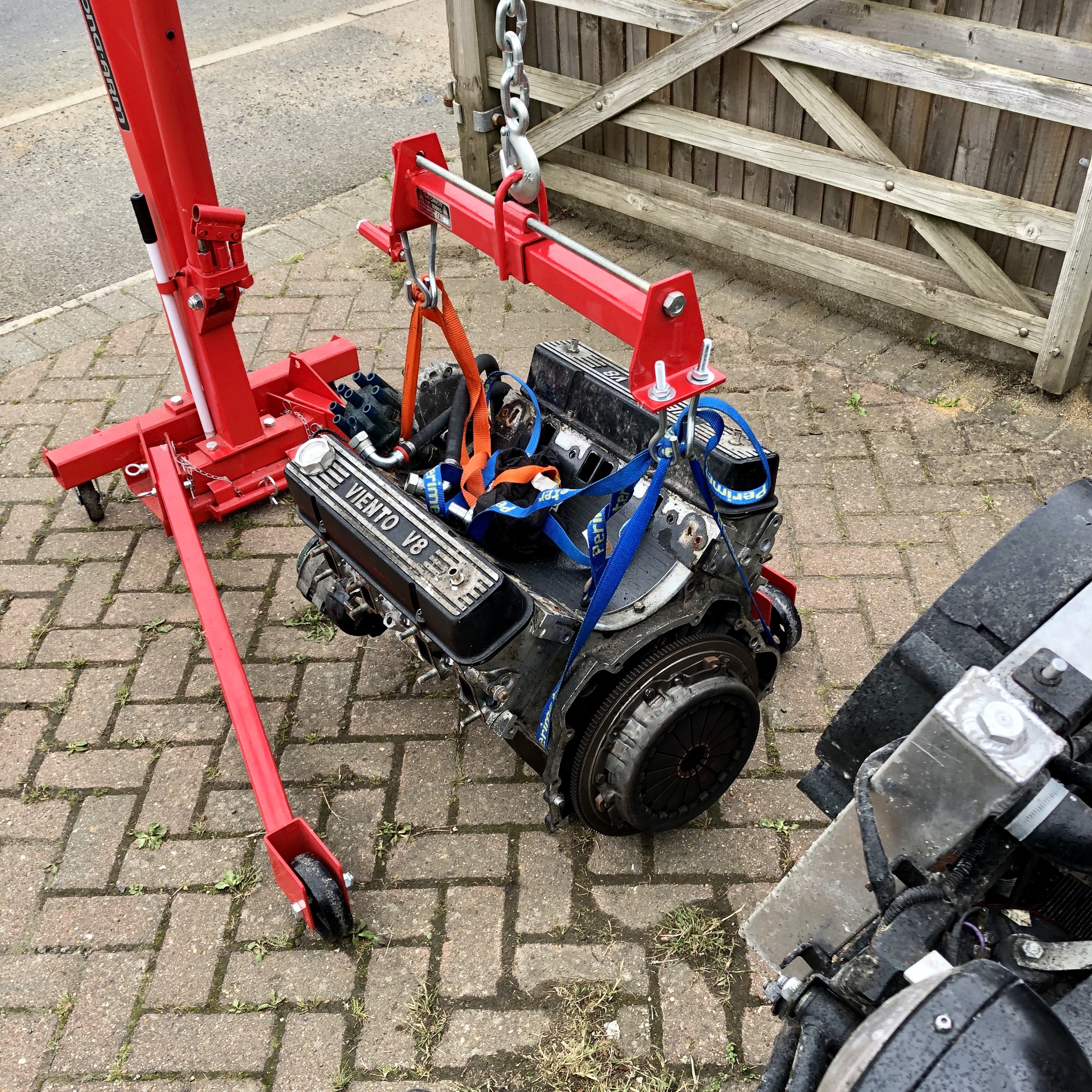

Engine is out swapping a few bits today then in with the new one..
gotta love the style with this - "old engine is buggered - ah well I'll just buy three others and piece together one decent one out of the three"...   ☺️

Not worth the hassle trying to sort the old engine, You can get them up for next to nothing and refresh using Britparts for less than £300 though not the best quality parts. I go upmarket and spend a bit more.

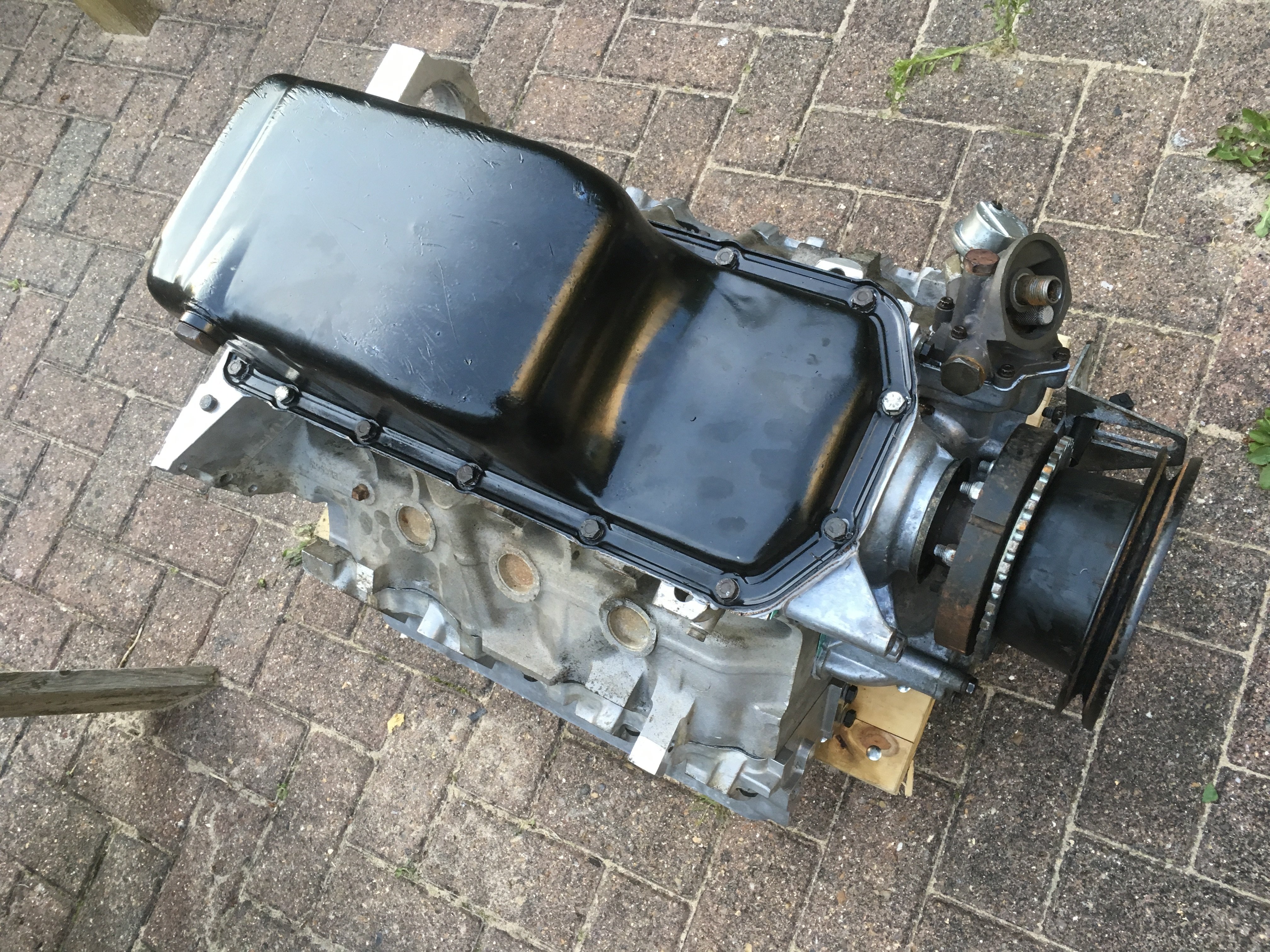

Didn’t notice a sheared rocker gear bolt in one of the cylinder heads. Sorted out another head, another set of stretch bolts and head gasket later, all sorted. Put a few more bits on the engine, valve gear and clutch left to do then hopefully get it in the hole today. Engine is upside down to let the sump gasket silicon go off.

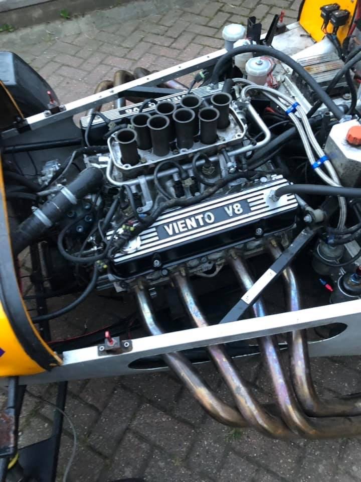

Engine is back in the hole, not without its challenges stripped threads, wrong spigot bearings already fitted etc etc. A few more connections to make then give it a whirl..

Ive an idea how my missus would feel about having 3 or 4 engines down the side of the house..
I have a definite idea about the reaction to a half built one in front if the oven :D

All connected, and making a noise. No oil pressure despite priming the pump. Not sure what the issue is at present. Picking up an oil extractor tomorrow to have a go at sucking some oil through.
Not much time to look at the car, though sump needs to come off to take a look at the pickup and see what’s going on. A bolt has stripped holding the slave cylinder on so I can sort that at the same time.
