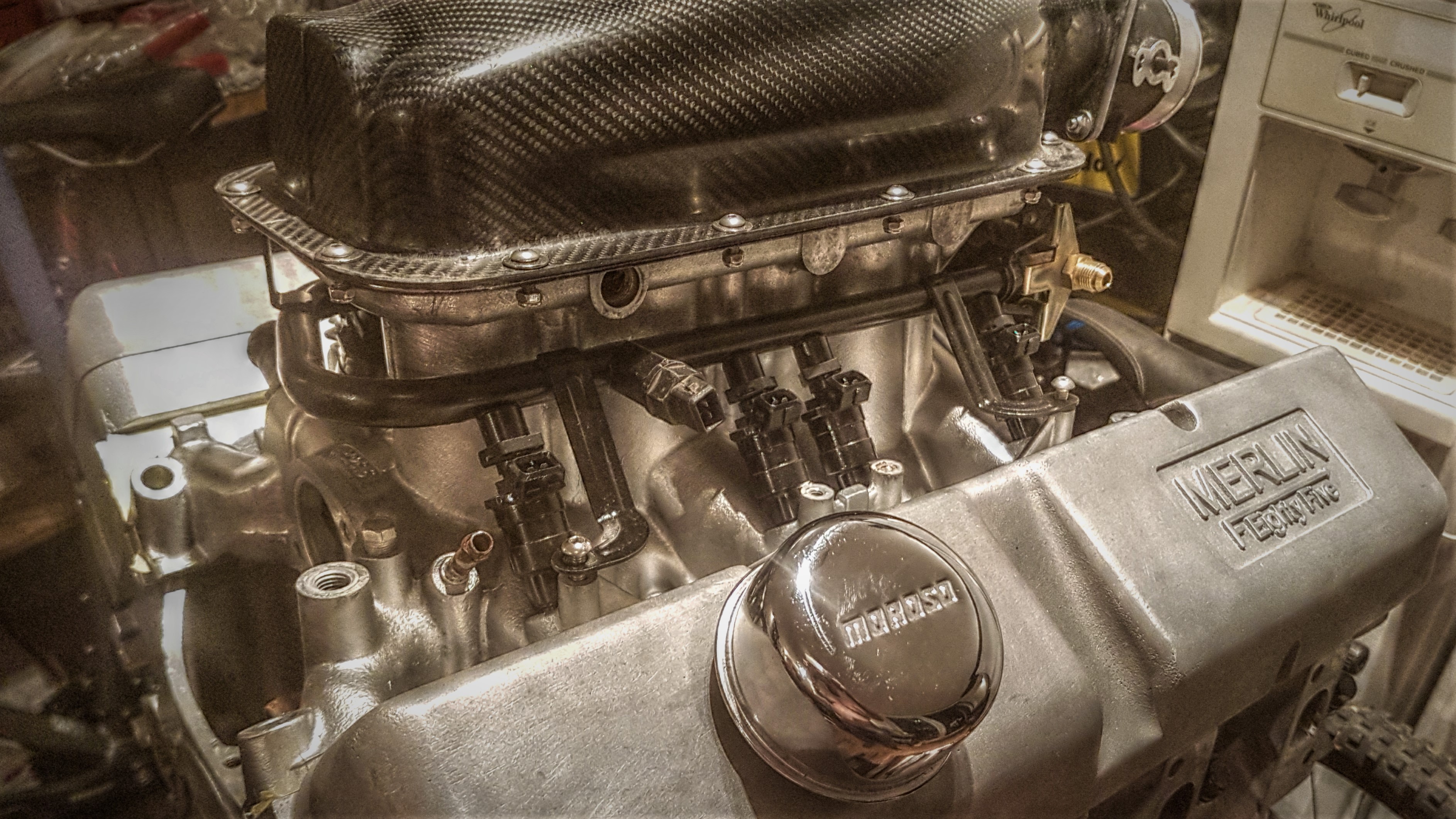

Need more power so managed to create some room in the workshop so I can get on and build my new engine. Finally got it on the engine stand and started doing some measurements.
Needed to know if I had enough valve to piston clearance as the heads are aftermarket, designed and made by Merlin. This valve sizes, clearance etc. are all different to the rover heads. Took a couple of valve springs off and bolted the head on with a new gasket, which unfortunately is now consigned to the bin.  Set the engine at TDC and checked the clearance. Good news, loads of clearance 6.5mm on inlet valve only needed 2mm or so.
Next Job was to work out the compression ratio as the heads have a larger size combustion chamber to the rover heads lowering the Compression ratio. Measured the head and the dimensions of the bore at TDC allowing for the piston, head gasket thickness and various other factors. Works out around 9:1 could do with a bit more so have decided to replace the pistons with 4.0litre ones which have a smaller bowl, 13cc instead of 22cc. This brings the compression up to 10.5:1 which will be ok. Because of the smaller bowl I’ll need to measure the piston/valve clearance again though should have enough.
Stripped the rest of the bits out of the block. Condition of the camshaft, main and big end bearings indicate very low mileage, except cylinder 1 big end, which was absolutely cooked. Not sure why this occurred maybe blocked oil way at some point, I’ll take a close look at the block and crank oil ways when I clean it. Luckily the crank is ok, maybe benefiting from a light polish.

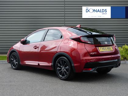

Anyhow, a deal is done, got a gem of a car on its way, a Honda Civic SR diseasal. Clocked the advert late last night, e-mailed the garage which was near Peterborough, return phone call first thing this morning, deal done and dusted in less than 9 minutes.. proper job. The price was great though managed a another £150 off to sweeten the deal. that'll pay for my fuel for Richards track day :).  SWMBO will be picking it up on her way to Scotland next week. Car is low mileage and totally loaded. I'd be happy to smoke about in it and SWMBO can use mine lol. A few advert images below,, just ripe for a few Type R bits for the Ricer Look.  :)
FV65NSE_8_1498292234.jpg.bc4c1b064972c88fa4b6a1a1b9d0cdbd.jpgFV65NSE_9_1498292234.jpg.3af10d30613fe8c90eaa15bb4e298c18.jpg
FV65NSE_1_1498291936.jpg.980b748c82dc173d3fb483dbd34f11c4.jpgFV65NSE_2_1498292234.jpg.6669d468e24b996cd31f973a5fa1620d.jpgFV65NSE_5_1498292234.jpg.9158263f3ca9f89e6bce06151065e50a.jpgFV65NSE_7_1498292234.jpg.e3c90f13d2d46746c209dd93ee509e17.jpg
