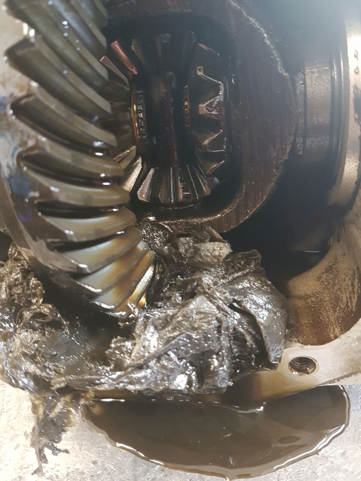

The diff turned out to be a pup, wrong ratio and not a lsd in sight, instead a tightly packed wad of paper rammed into the planetary gears to give the right impression when turning by hand. Shoved a borrowed one in for now until I can work out a plan. Took it for a hoon, the borrowed diff is a bit low geared, which means acceleration is good and I only really need 5th gear. So called tran-x diff below..
Edited by B33fy
Dodgy! :(
Diff is bad news...   Surprised it didn't show up on the run out the other day!
Hope you are having words with wherever it came from....

The suspension has made such a difference it was difficult to tell in such a short run. The seller was as good as gold, full refund and I get to keep the diff. Will probably get it rebuilt with a Quaife ATB at Road and Race.
