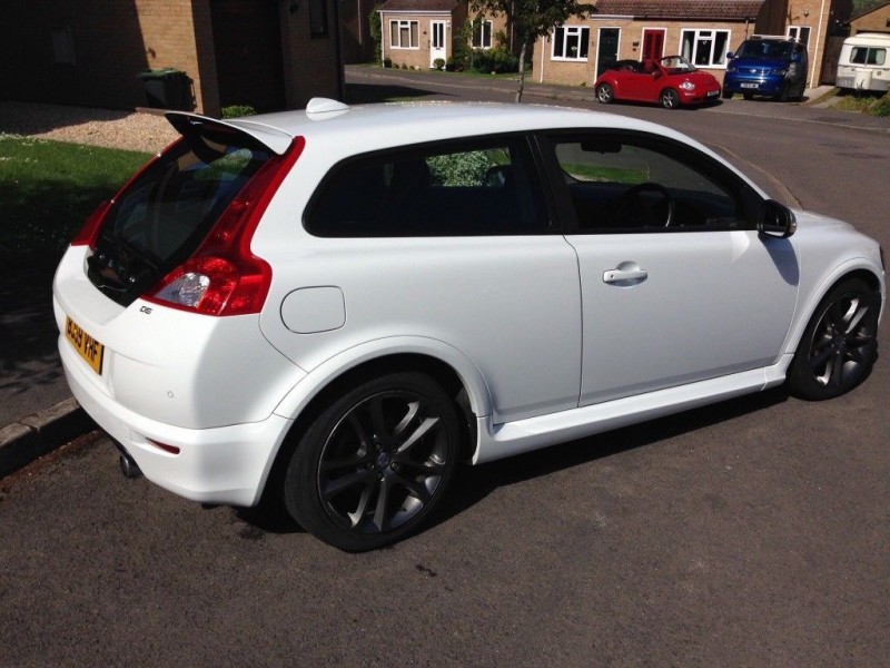

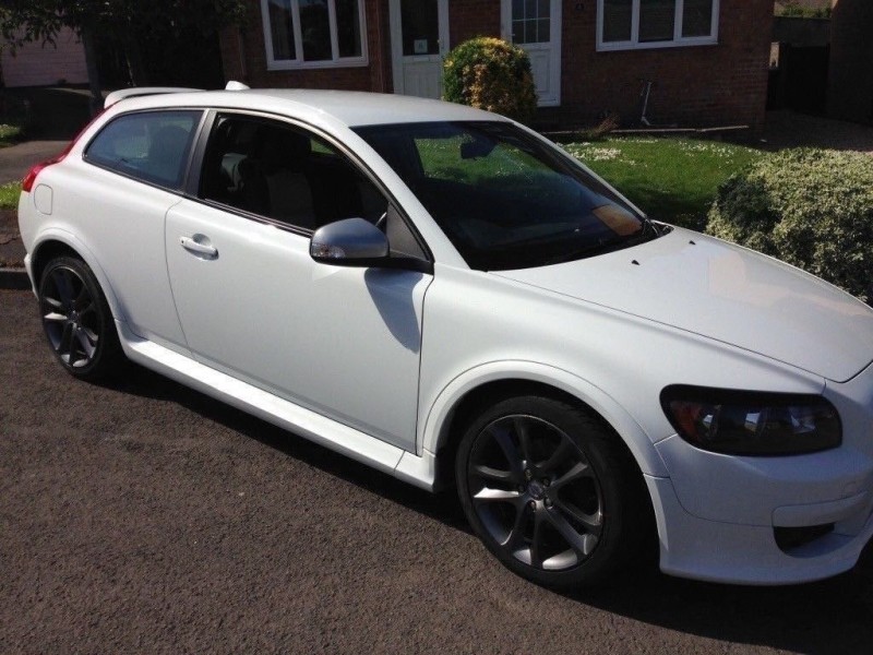

Lol no chance they look horrible..  deposit paid advert pulled, so be amazed.. here it is C30 D5 manual R Design., bargain!
He he - the Soarer was the only thing I could think of quickly that was rare (for a good reason) and didn't usually come as a manual!
C30 looks good - I always liked the old 480's as well (I remember test driving one back in 1990...   but then discounted it because of the insurance costs)
Nice! D5 is rare in the manual -the slushbox was rubbish - Pre-facelift just looked so much betterthan the later ones. Enjoy!

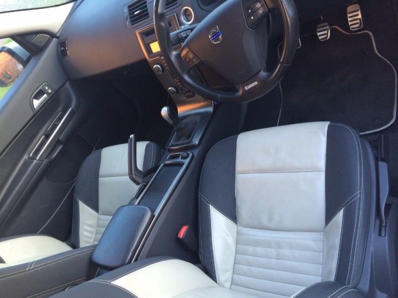

Still love the c30s, and a manual d5 is a rarity indeed. A remap will see that keep up with most things on the road worth much more. Never liked the grey and white seats, so much so I had my old ones in my c30 changed to black. Look forward to seeing what you do to it.
Thanks Mattie, not planning going on doing much to be homest. I’ve gotta get that V8 in the viento and smarten it up a bit. Got a road trip in mind which might happen sooner rather than later, depending on work  There’s a bit of a bucket list of places including the transfagarasan pass I want to hit if I can.
Swmbos gone all sentimental on her late fathers vanity plate,  so I might throw that on the car and depending on the state of the wheels might get a set of black BBS rims, Polestar style for it. I agree with the light seat panels, a bit pants, might look at some options. I’m not envisaging keeping it for long so just want to keep it serviced and tidy and get a fair price for it when I move it on.
