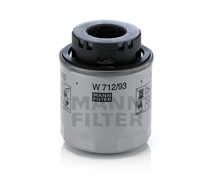

xman,do you know if it's a good idea to use the w712/94 oil filter on a vrs? thanks.
What kind of vRS a Mk1 Fabia or Mk2?
For a Mk2 1.4TSI i highly Recommend a Mahle OC295.
( But what you want to ensure is the correct Oil Filter and you might want to use a OEM VW/Audi Silver one.)

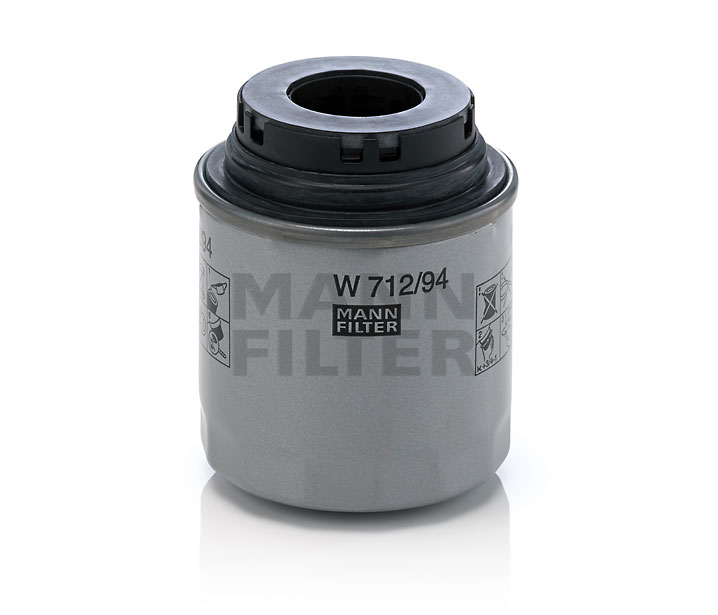

The short answer is best get a part no. from your dealer and check it using cross reference on Mann hummel or Mahle online catalogs.
Mann Hummel only list the 1.4 RS CAVE engine (w712/93) but you may have a CTHE engine.
Long (winded) answer:
My dealer still uses a VAG filter 03C115561J which is a w712/93 both on our 2011 1.2tsi Octavia and our 2013 1.2tsi Fabia when it should be a w712/94 03C115561H according to Mann in both cases. The filter changed for 1.2tsi in 2010 but not for 1.4tsi which remains a w712/93. The filters only differ in the sealing ring arrangement. I use the 94 variant and it appears to be the correct variant.
So another problem area with my dealer!!!!
Mann Hummel make and supply VAG with oe oil filters for these cars, the significance of the silver colour is the use of synthetic filter material which guarantee long life and other benefits.
https://www.mann-hummel.com/pt/corp/news/news/newsdetail/?tx_ttnews%5Btt_news%5D=701&cHash=d45ad9cc92456d62a38daef82c09d81e
