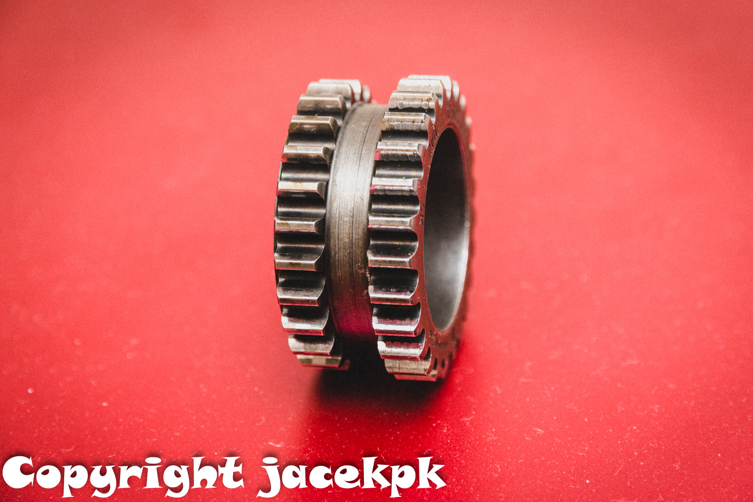

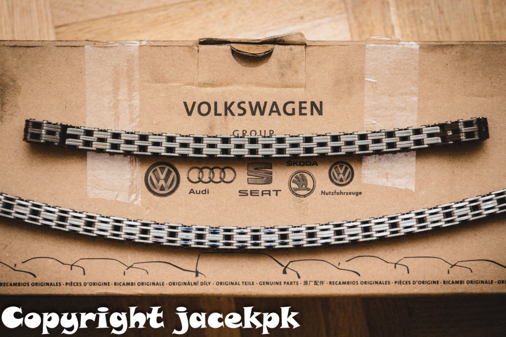

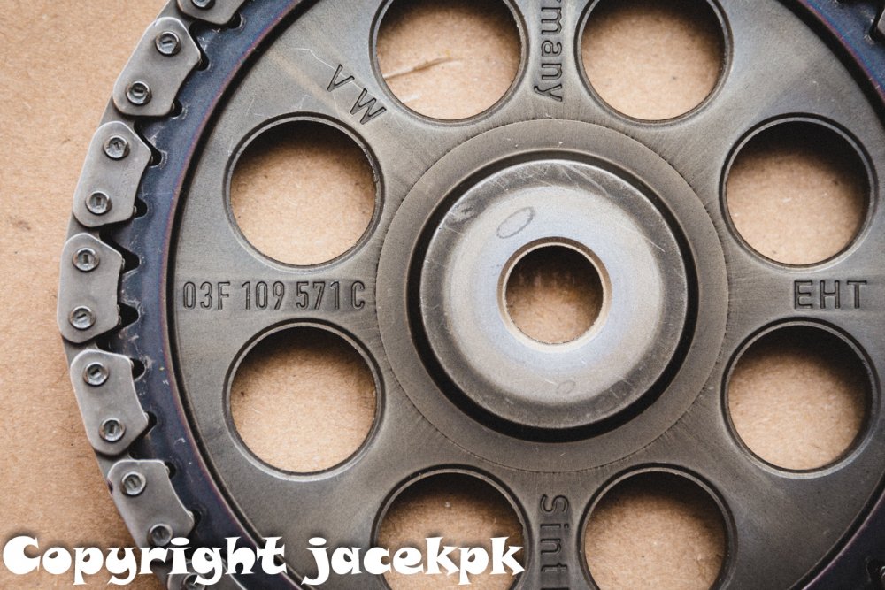

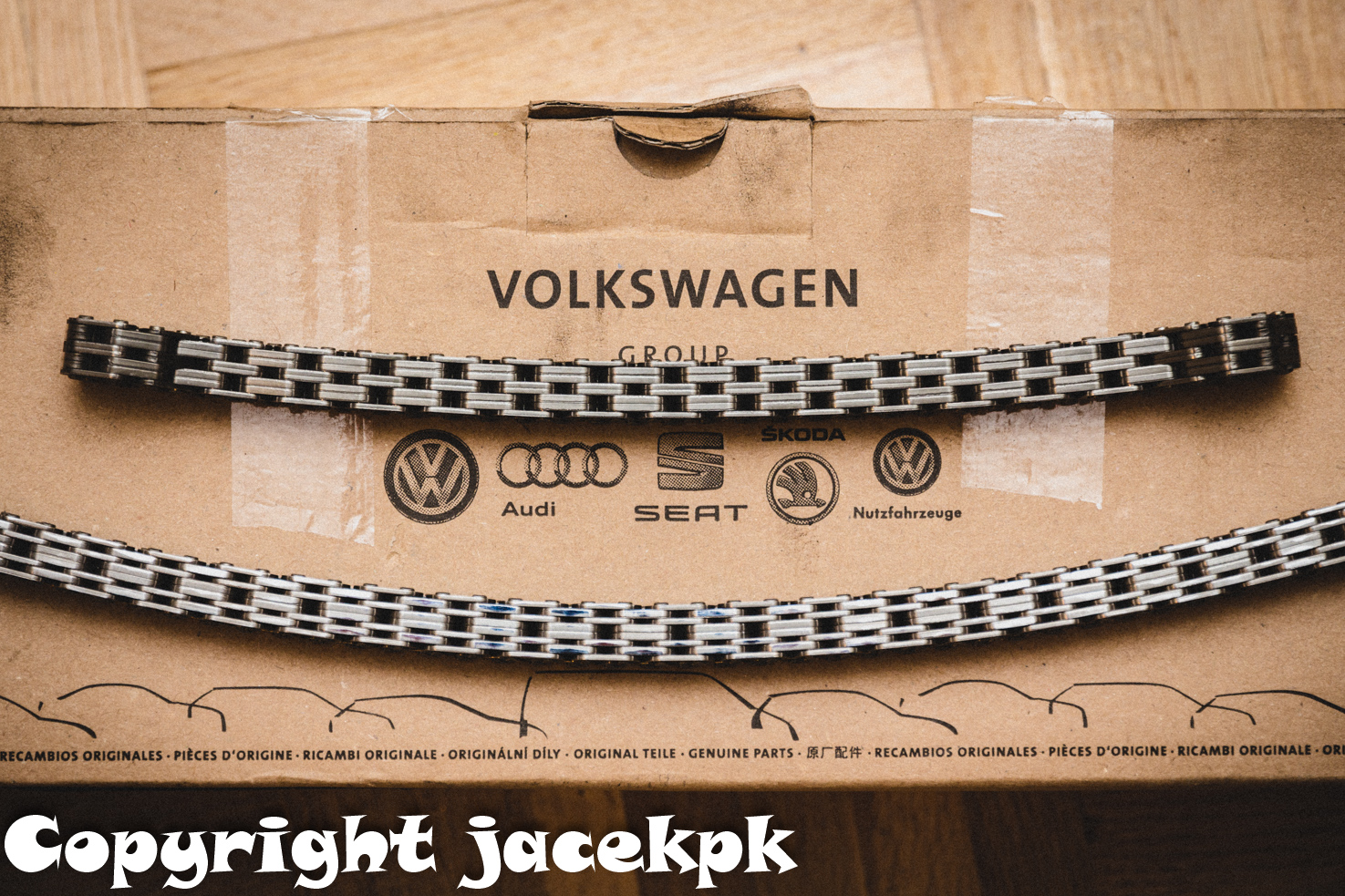

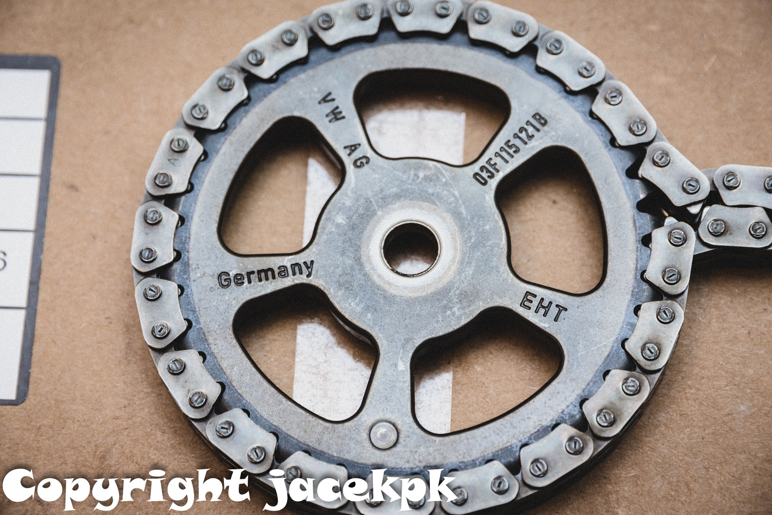

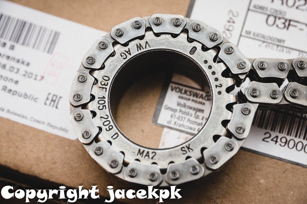

Below I show how looks my factory timing chain and his parts after 90k km. There wasn't tragedy, but I think it was good time to replacing both chains and guide rails, tensioner, sprockets.
Camshaft sprocket and elongation of timing chain:
Oil pump sprocket and chain elongation:
Crankshaft sprocket and timing chain:
Crankshaft sprocket damages:
Both chains:
Regards!
