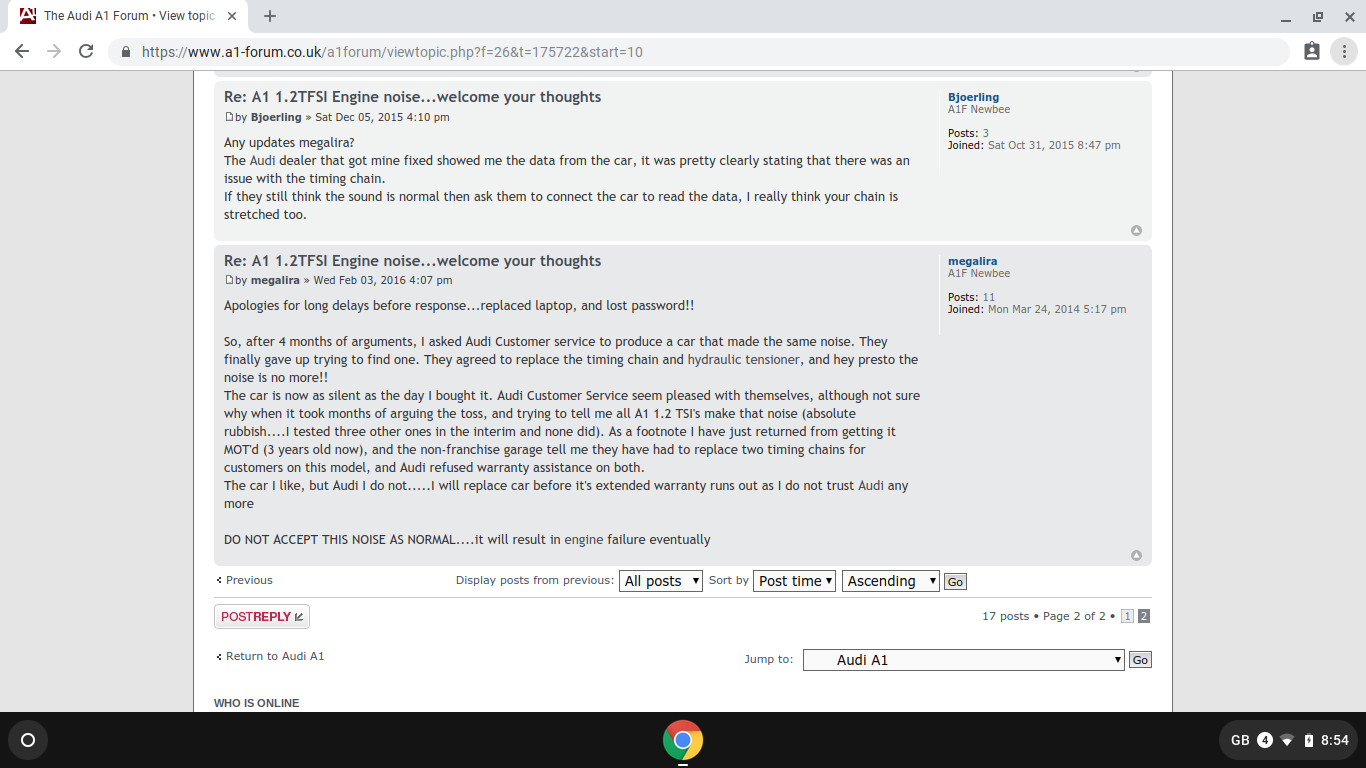

Yes Audi knew.  They had the TPI, they had been doing warranty work and fitting the upgrade kit.
