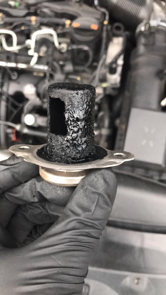

Have a look at my pictures, ive done this before and its a bit of a pain in the backside to remove due to one bolt well obscured by the metal EGR pipe coming out to the side...  you will find various threads on here by searching though or check my galary pages and you will see various stages of me cleaning mine..
I used Wynns carb cleaner and lots of it, tooth picks, tooth brush, lots of gloves etc etc and eye protection as you dont want the stuff in your eyes... plenty of time (3 hours as its bloody impossible to remove)
Patience!!
Patience!!

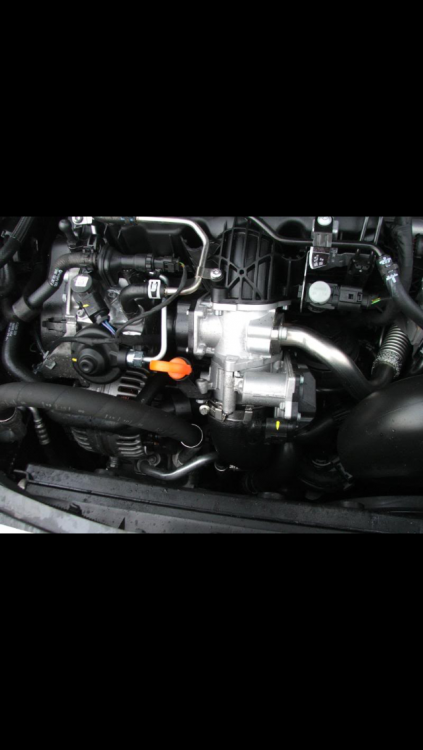

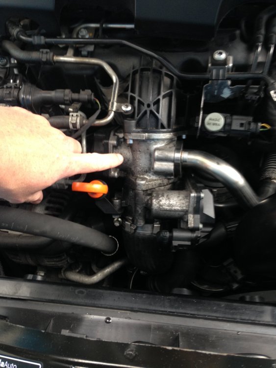

Whats that on top of my anti shudder valve then with egr pipe coming from it?

Looks like mine is on front and is a cr.

The egr delete kit goes there to.

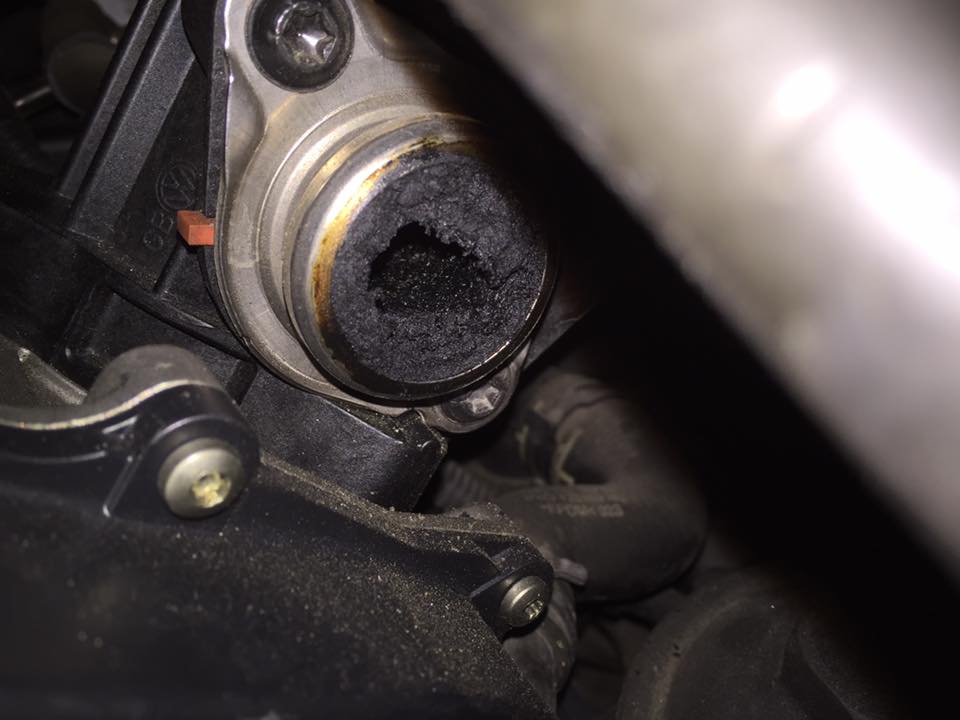

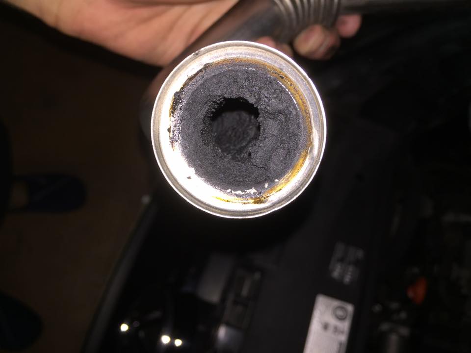

i got a 1.6 CR and it's at the back as well. I got the same egr pipe going through but I suspect it goes back to the intake manifold. I pulled the pipe out and cleaned it but that's about it. Pictures attached are not mine but it's from the same engine and it looked identical when i cleaned it. Used a whole can of Carburetor cleaner. Hope it helps

yes it's a just a egr system pipe that goes from the engine back in to the intake. I don't know if it made a difference cleaning it but i can only presume all that black soot out of my engine was a good thing.
also this is what the egr looks on 1.6  and 2.0 CR
