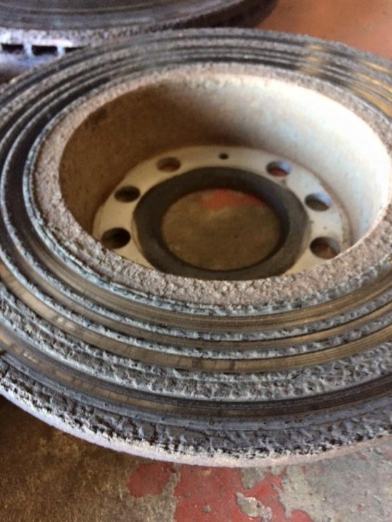

What a truly dreadful experience. That brake disc is absolutely the worst I've ever seen in my life.
Personally I wouldn't have bought it with such low tread depths on the tyres and would have insisted on replacements, but thanks for the heads up on this outfit.
I would take the car to a fully qualified independent engineer,  approved by the Institute of Motor manufacturers and traders, pay them for a full detailed report on the overall condition of this vehicle, (which I suspect wouldn't be good)  and then take them to court. No messing about.
22 hours ago, Redboy said:
The tyres were factored into the selling price I assume, if you did not ask for replacements on purchase. Those discs look in terrible condition. Was it not driven often or was it low mileage?  How did you not feel/ hear their poor condition when test driving, the noise should have alerted you, although the corrosion would have been hidden on the reverse side. Despite whatever deal you initially did, I would have thought that the dealer would have made an attempt to rectify.  Finally when is the MoT due or did it come with a new MoT and why didn't you get a 3 month warranty or similar, it couldn't have covered severely worn/ineffective brake discs.
The tyres could have been seen by the him before picking it up. However the pic looks like the inside of the discs which you cannot see without removing a wheel, (stone guards may prevent looking from underneath). If you can see the discs through the wheel, you will only see the outer surface which may be OK, you can't see the inner.  Also I believe, modern MOTs only measure brake performance and not the conditions of disk and pads, so may have passed.
Yes I realised that and covered it by writing " the corrosion would have been hidden on the reverse side..." As for MoT condition from recent experience on my wifes car, the discs inner sides were corroded and braking performance was poor and crucially very noisy, which is why I can't understand why the OP didn't hear the grinding or scraping noise which must have been evident.
I think i mentioned but new brake pads had been fitted very recently hence there was no scraping , but the fact the pads were flat and the disks pitted resulted in less surface area again , where as pads that wear with the discs trough and groove with them so still keep stopping power.. and it was only a couple of weeks into ownership and not that many journies either - i had noticed the brakes werent as good on slower runs but questioned myself as to wether it was because the car was a 170 and my last yeti was a 110 so thought it was just me and my driving style, that is until i had to use the brakes for real.
Well for one i would be questioning your tyre guy if thoses discs were in such poor state..
And two how could you not feel or hear that something was seriously wrong??
I have had some cars in very poor condition maintenance wise ad only when a disc is as bad as that the caliper has been siezed too...

After over twenty year in the motor trade them discs are the result of exstreme neglect or a siezed caliper and do not in any way tally with the story so far.......

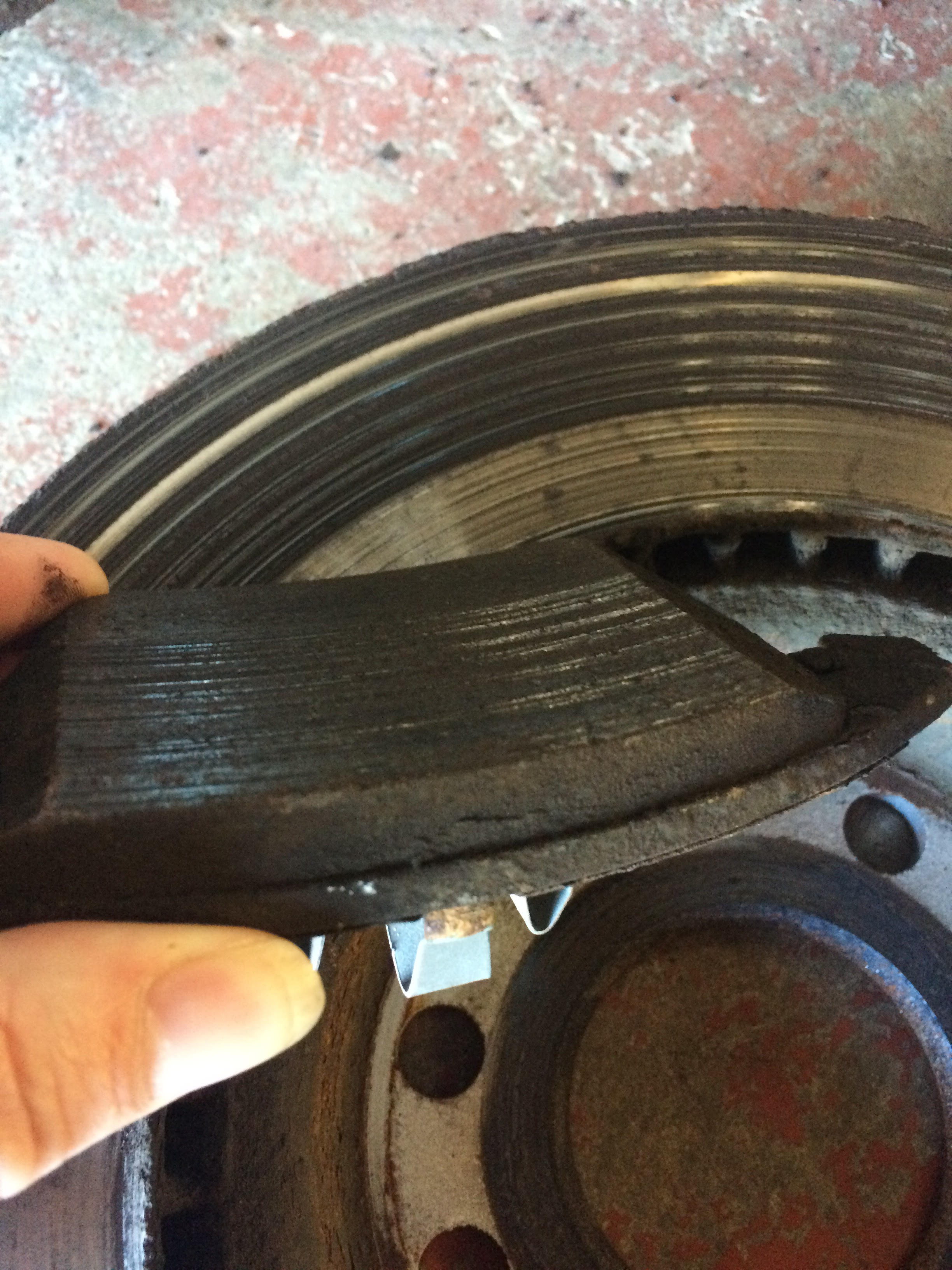

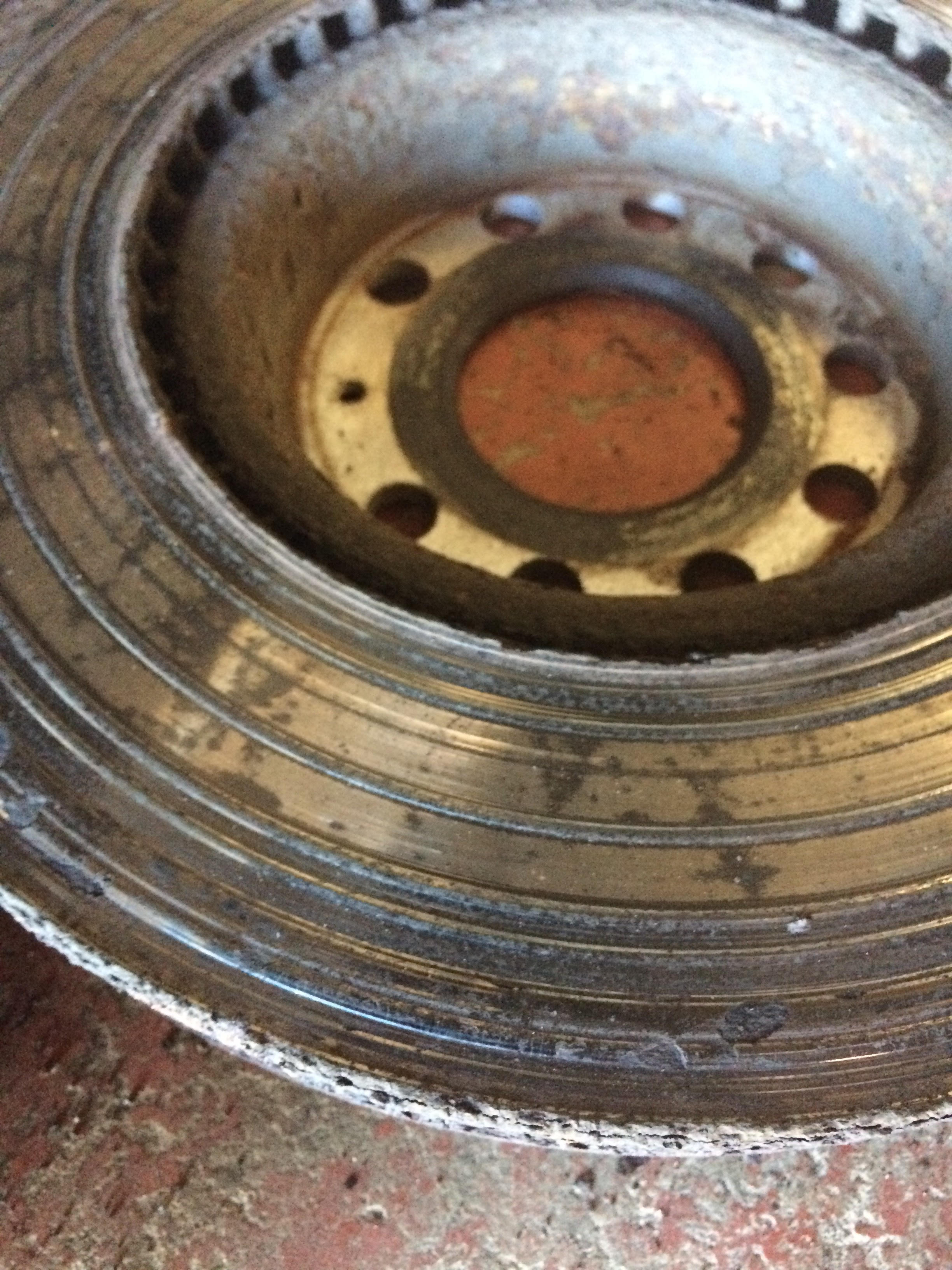

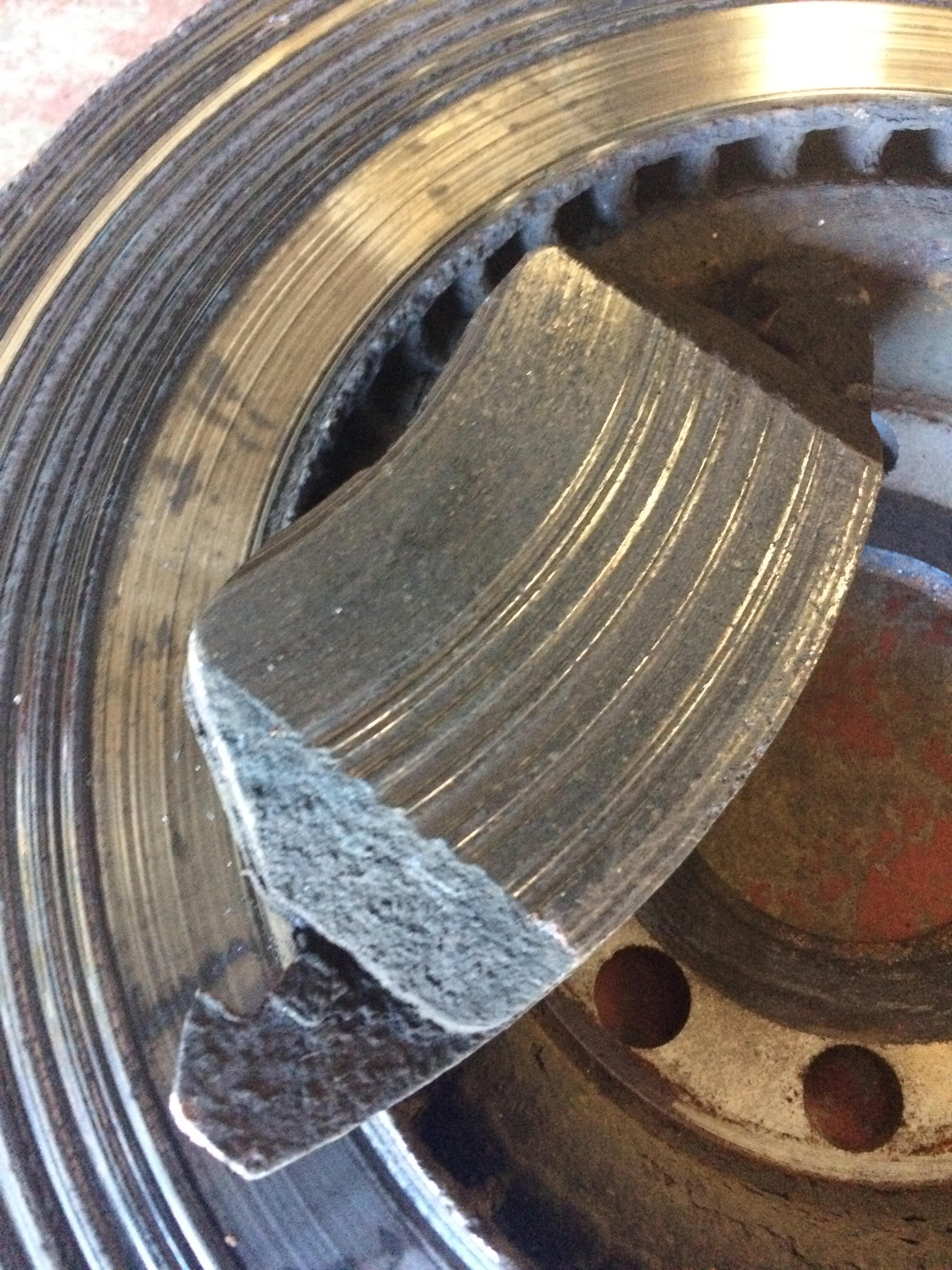

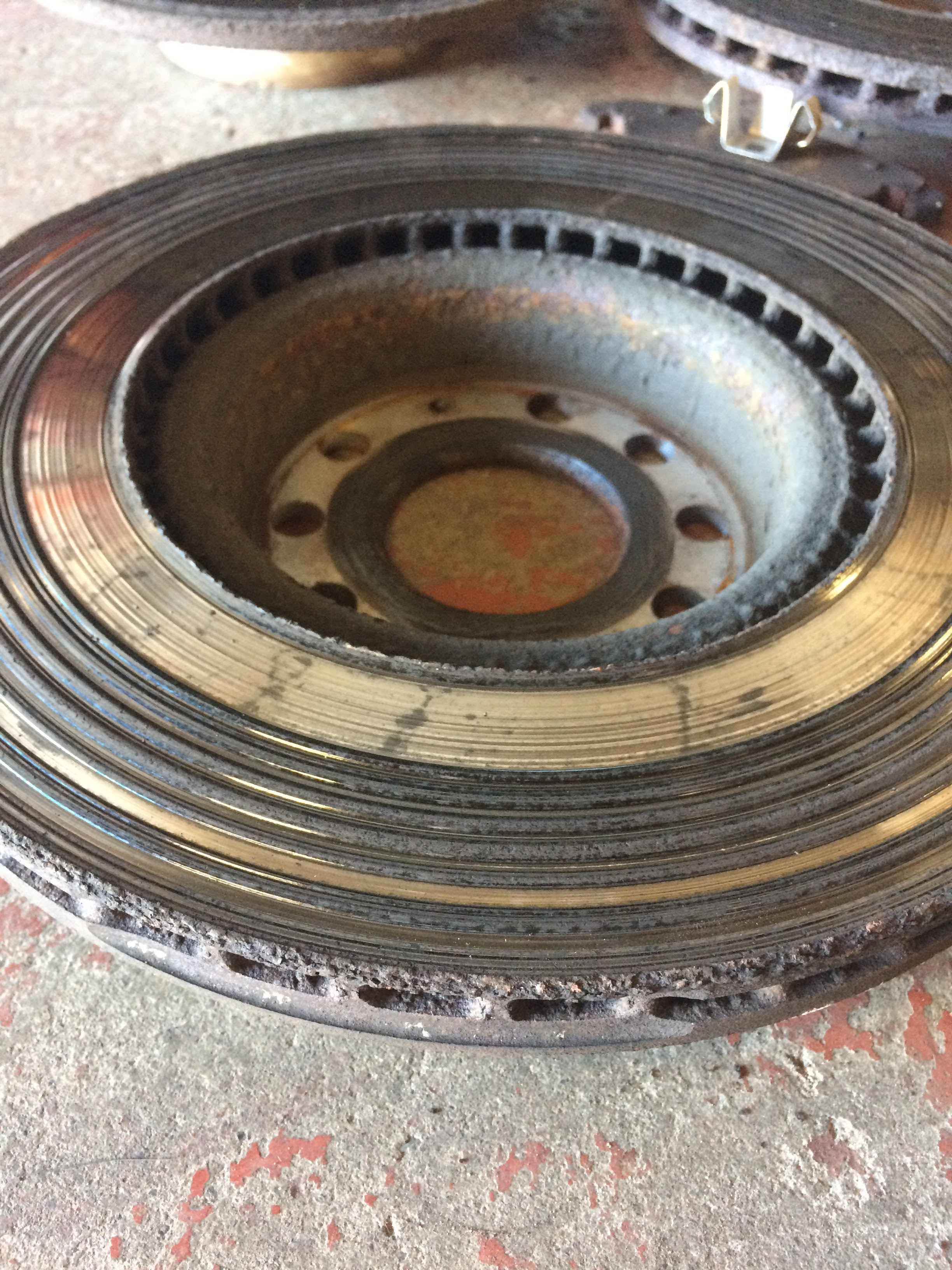

Here are some more photos of the disks and pads
Tally with the story so far ? There is no story. Its fact  - i  bought this car and these are the disks that were on it . Maybe there was neglect by the previous owner or the garage but thats none of my business , when i buy a car which has as part of the deal been inspected then i dont expect to end up risking my life. Isnt that the whole point of buying an Approved used car from an Approved dealer ?
