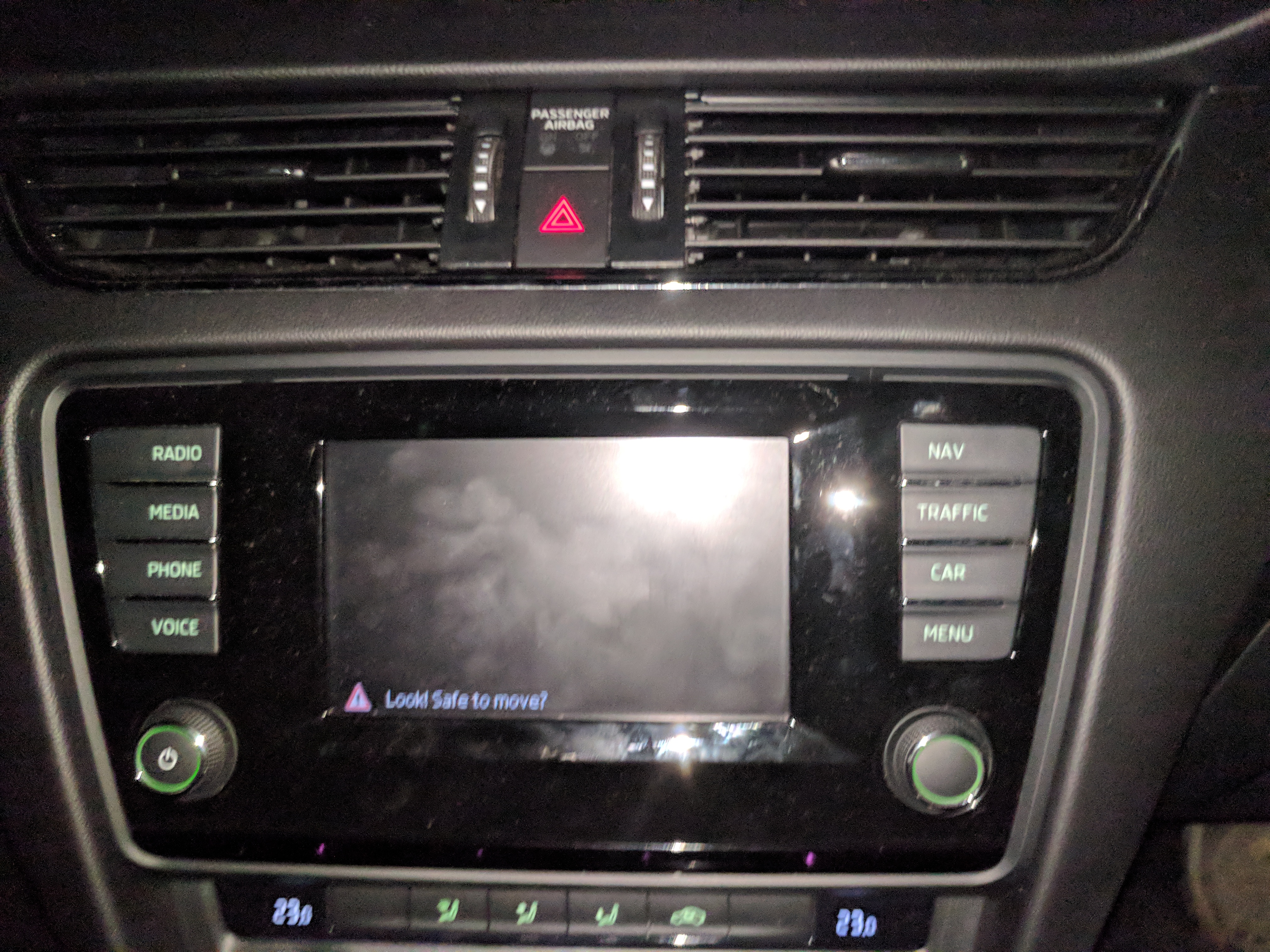

Look! Safe to move?
Last week after setting off on my journey the Amundsen display was not it's normal self.
It was completely black except for the message "Look! Safe to move?" in the bottom left corner.
This is normally the parking sensor warning you see when reverse is selected (I was moving forward).
Neither the touch screen or any of the surrounding buttons had any effect.  It was like this for my five mile journey.
I tired tuning it off (the car) and on again and it was still 'stuck'.
At the end of the day I returned to the car and started it, and thankfully all was as normal.
I'm glad it fixed itself and trust it does not do it again.

So happened today for the third time.  First time was at 3220 miles then second time at 6900, on both occasions long time mileage (only) was reset.  Today (day 157 from new) 8060 miles on the odometer it happened again.  From start up, display stuck on "Look! Safe to Move?".  After a few miles and getting bored as no radio so tried tuning off engine, locked, waited then unlocked, but exactly the same when I restarted.
Selected reverse and parking sensors came on and display changed as normal.  Popped out of reverse and all was well again and long term trip not reset.  So perhaps the cure is to drive to work backwards!

Have exactly the same problem with my 2014 octavia estate, it started first with the drivers side parking sensor staying on for three days which seemed to resolve itself, then i got a lane drift warning which should not have come on, then the problem mentioned above which remained for the 150 mile journey. Next day everything was normal.
i phoned the dealership who advised me to take a video of the problem because if they could not find a fault Skoda UK wouldn't pay for the work under warranty. Since I don't have the means of taking a video I thank you for raising the topic, it's what I was looking for on the site.

I have had the "Look! Safe to move?"-issue several times on my 2014 Octavia Estate, Bolero unit.
Recorded the issue and asked Skoda to have a look. The first exchanged the Bolero unit - didn't help. This summer I was called in to update software in the Bolero - didn't help. I've sort of given up on this, might raise the issue again before warranty runs out.
To fix the issue when it happens - just press and hold power button for about 10 seconds and it will reset itself and problem is gone.

I have just experienced this very same issue, the screen got stuck after being in reverse. After driving a bit, then putting it in reverse then 1st and rolling forward it worked ok again. I got a photo of it but no video. Has anyone had a resolution for this problem, my 3yr warranty runs out in 5 days time!
