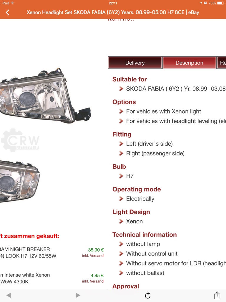

There's some on ebay for £139 for a pair, yes a PAIR of DEPO Xenon headlights.
Trouble is you'll need to move abroad to use them as they're for LHD :D
If they can do that price for LHD lights then why not for RHD. A question I asked only a couple of months back
