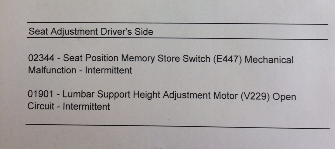

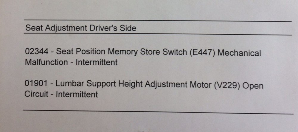

And lets not forget that after a few years the electronics will start failing and you'll lose seat memory and lumbar...... ;o(IMG_8387.thumb.JPG.c12d950a2e6e35311942513336a8c0b8.JPGr lumbar adjustments will work....
