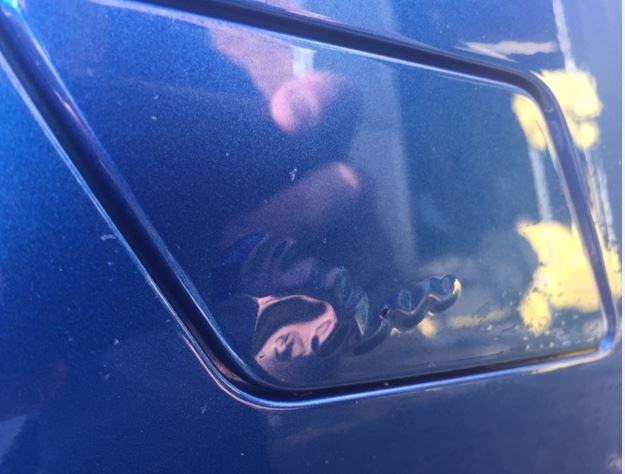

So just finished washing and noticed the paint blistering on the headlight washer cover. Did take a picture but cant work out how to load it off my iphone. Anyway, there is what looks to be a stone chip on it, but i dont think the paint should have blistered despite that damage. The cars not even a year old yet and is always washed carefully with snowfoam the 2 bucket method. Finished by a coat of sonax bsd.
When you say blistering, would I be wrong in thinking its the top coat of laquar actually releasing from the paintwork below that is causing what you call blistering ?
I currently have an ongoing paintwork warranty claim, might help if I upload some pictures later but, I'm currently keeping quiet till unleashing all hell and all its demons on the dealership concerned, slow progress isn't a description I'll be using to SUK when we finally get somewhere near a settlement.
Think its base coat too, looks like its lifting from the plastic. Almost identical to a rust blister on a car from the 70's :)
A break in the paint / lacquer will allow H20 behind, and obviously plastic will not rust, but can blister.
It is really just a case of needing to repair paint damage ASAP, or as soon as you find the damage.
There is an obvious stone chip in the picture and any stone chip is SUK's get out of jail card, so I wouldn't even bother trying a warranty claim. I would just have a body shop remove the part, strip and prime, paint and lacquer.
That shouldn't happen even with a stone chip but as said SUK will use to throw out any claim....
There is a stone chip, no doubt about it. However, should the paint have lifted? I would like to think not. My bumper has quite a few chips in it, most of which i'm going to repair now before the paint washes off. Going to call dealer and see what they say. In the 17yrs of car owner ship, i've had it happen once before, on a citroen saxo. It was bought 2nd and a year old. Citroens response to the lacquer flaking was its was caused by a stone chip, but shouldn't have flaked. As a result they honoured the warrenty claim
Looks like someone has had a heat gun on it!
Yeah I'm kinda expecting something along those lines but, should SUK decide its an acceptable occurance and to be expected, then that'll be the acceptable and expected condition the dealers will receive it back at the end of the PCP term.  Whats good for the goose is good for the gander me thinks. LOVL
The ex paint lab engineer that I am and as the part will have to be repainted, would do a cross hatch on the part not blistered put masking tape on the cross hatch and see what cones off. If it comes off to primer or base than there was contaminant on the part when painted, if not then just get it all repainted
