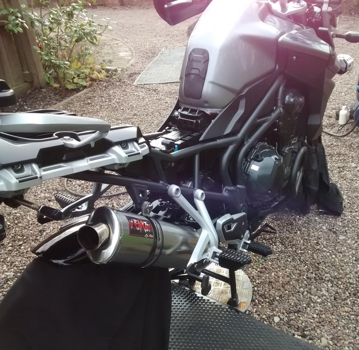

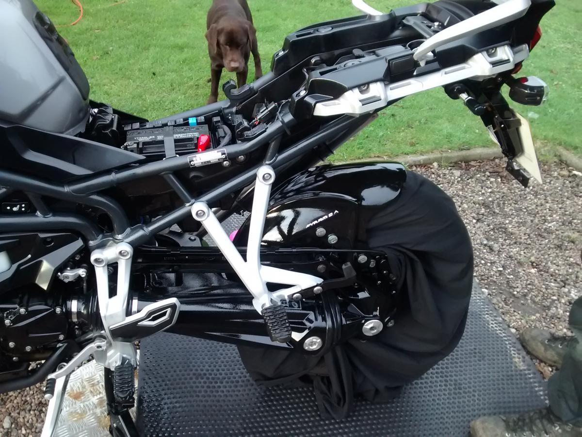

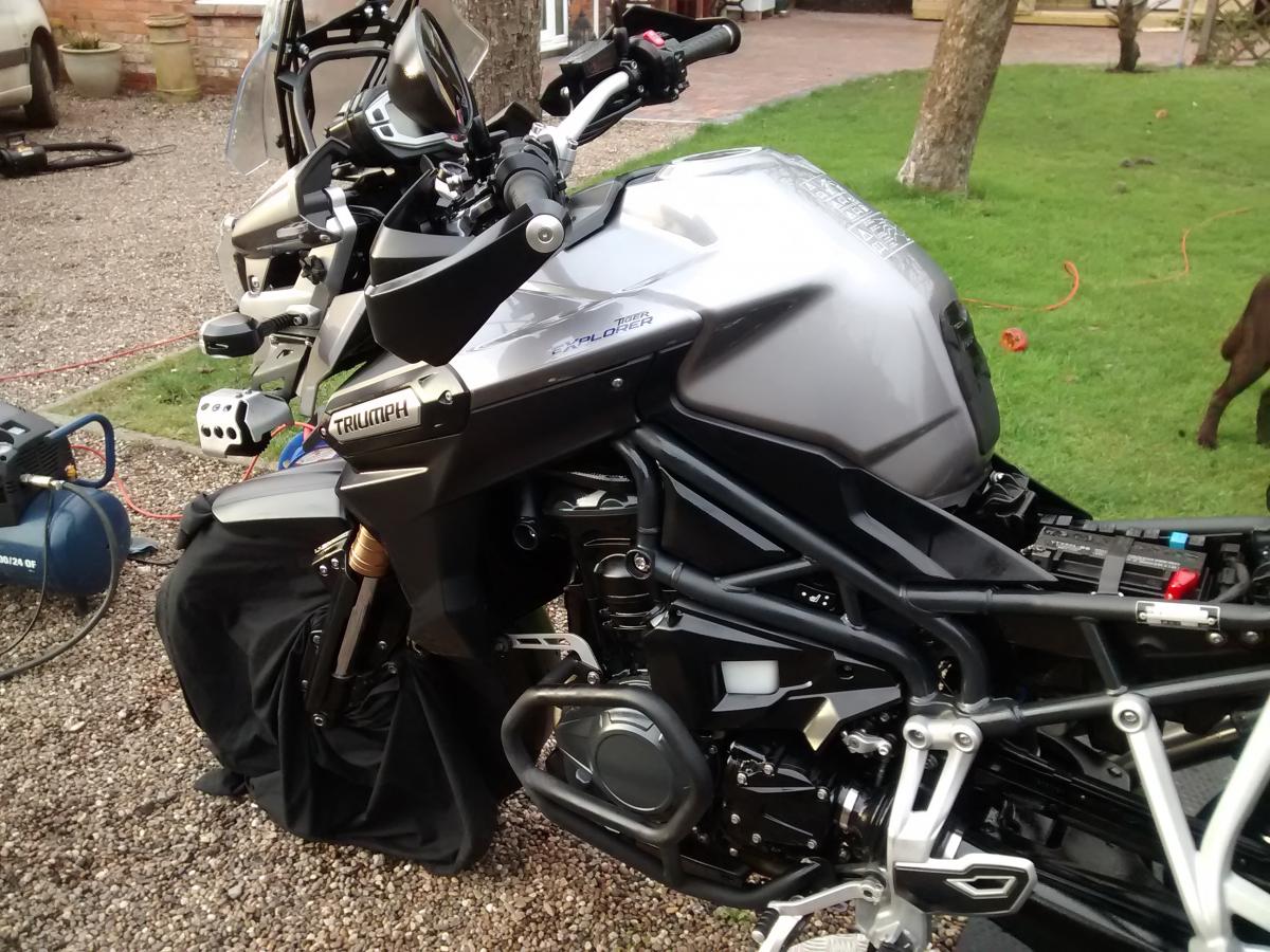

Well today has been the day.  Trevor arrived at 8.30 and is still here!  He has done a mate's bike and is still on with mine at the moment.  Looking pretty good and I know it is well protected for the coming months and whatever is thrown at it.  To clean it now no matter how filthy it gets will only be a hose down and rub dry, it is that easy.  For me the main thing is because the ACF50 is sprayed on by high pressure it creeps and seeps into all the nooks and crannies that you just cannot reach and that is the parts where the crap and salt go as well.
T'other side.
Fantastic.
I do quite like the look of that!
Well worth the money the way he does it but of course it is a franchise so not everyone will have the same standards.

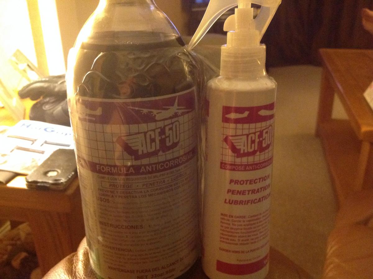

Just bought this from the show today.
Have a compressor and sprayer and interested what sort of pressure you applied the ACF50 at. My bike is 8 yrs old but has less than 4K on the clock with almost all dry riding ( only had it myself 5 months) but want to protect as much as possible from salt corrosion on the few days when I venture out in winter.post-75867-0-33798900-1449346691_thumb.jpegpost-75867-0-33798900-1449346691_thumb.jpeg
Edited by jerbear
Depends on your spray gun. You need to adjust the nozzle so it's spraying as a fine mist with enough pressure to stop it spitting. If you sit the canister of the spray gun in a bowl of hot water it will spray much more evenly. If your spray gun as a hopper instead just put the bottle in some hot water before you fill the hopper up. As the ACF50 cools you will find you need to open the nozzle up slightly to maintain the spray pattern.
