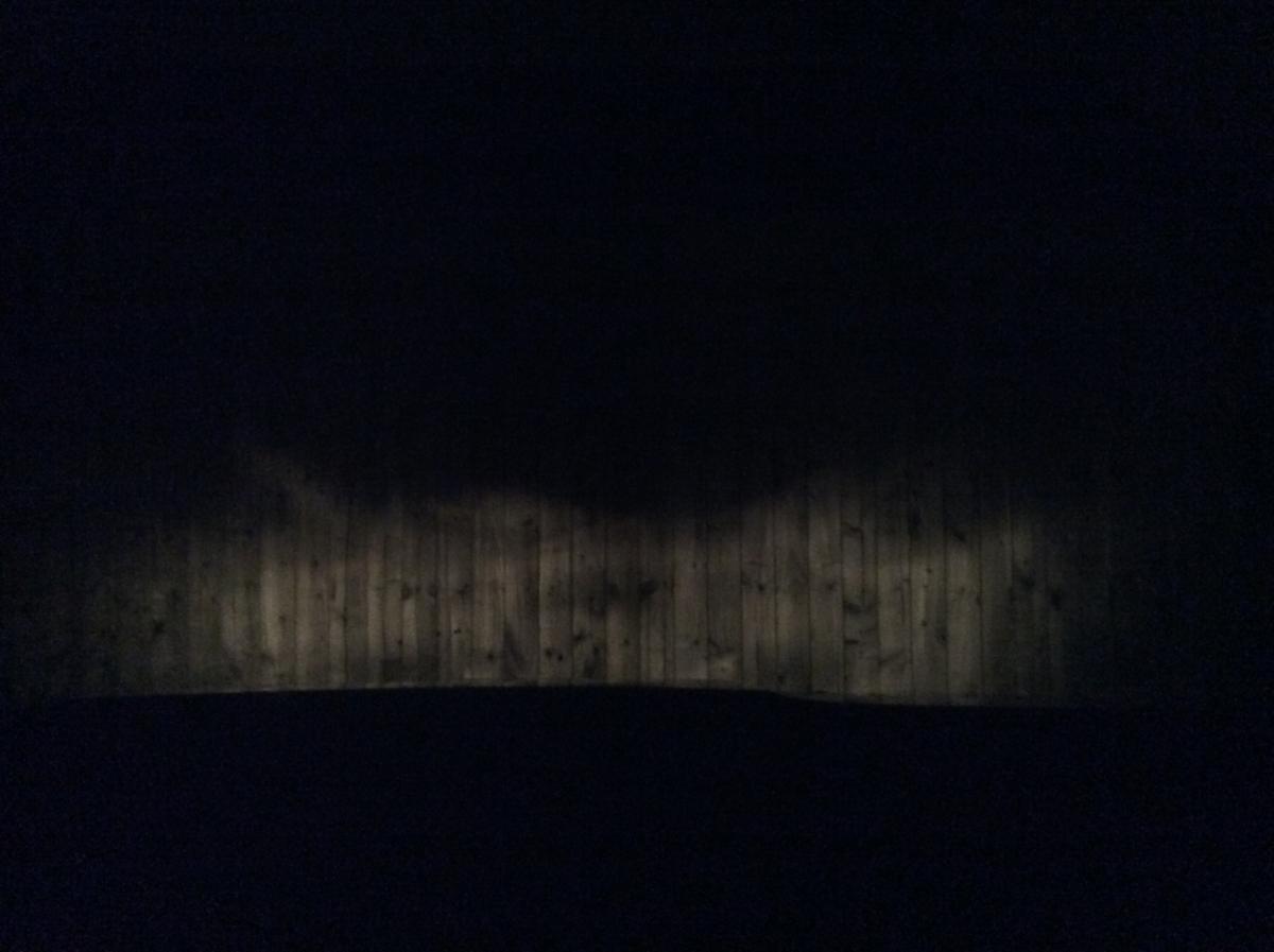

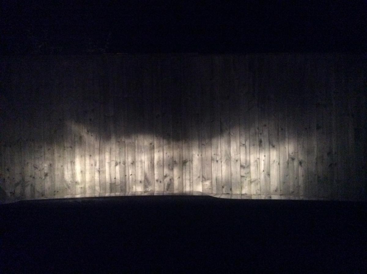

DRLs are 15 W, normal sidelights are 5 W, which I assume is what the DRLs dim to when the headlights are turned on. If used in the dark DRLs will dazzle oncoming traffic.
15W isn't enough to drive by in the dark, therefore It would only dazzle drivers if the light was significantly brighter than the light 'spill' from the dipped beam. I'm not convinced this is the case.
post-129718-0-79550400-1448828937_thumb.jpeg DRL
post-129718-0-15002500-1448828976_thumb.jpeg Side light

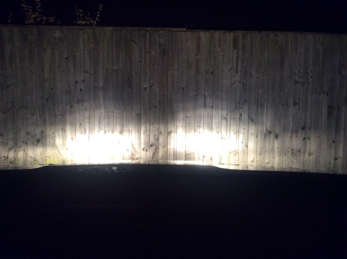

post-129718-0-70959100-1448829017_thumb.jpeg Dipped beam

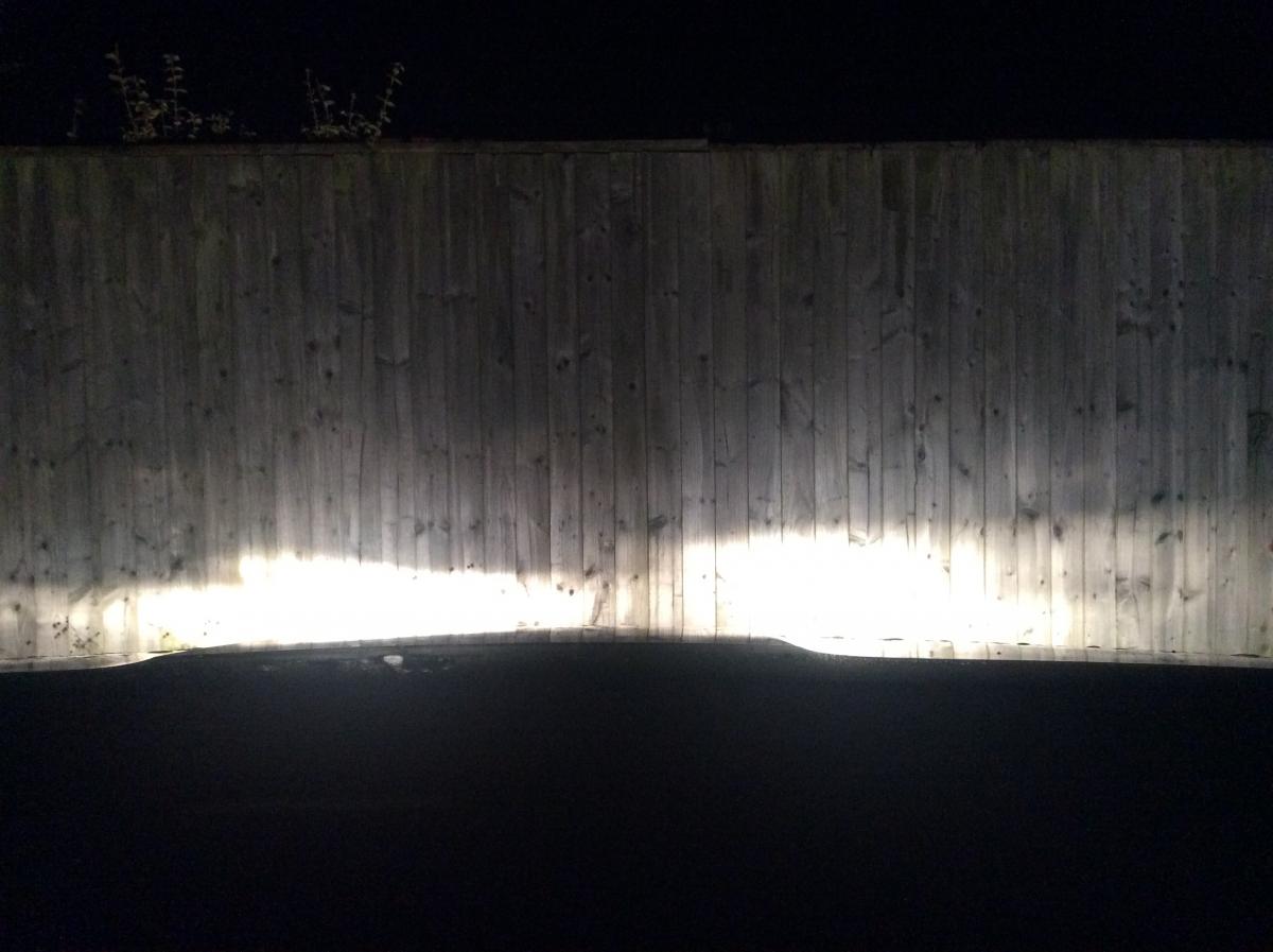

post-129718-0-88144000-1448829067_thumb.jpeg Full beam
