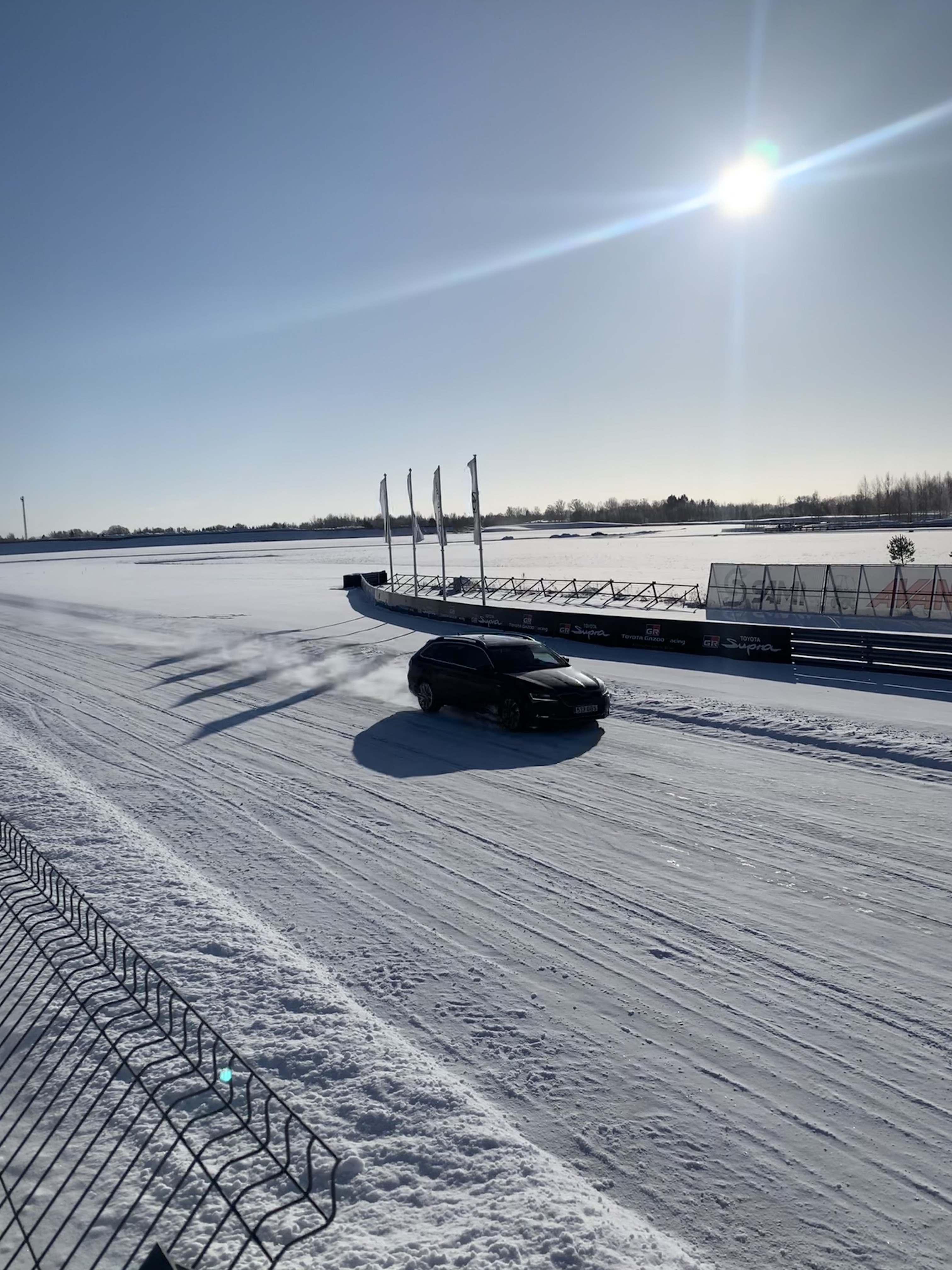

Glad to join the forum as a new owner of a 280. Dark brown with light beige (or whatever the correct color is) interior. Had to get an estate coming from a Kia Stinger hatchback/sedan and getting something with the EA888 engine was a no brainer as I absolutely love the engine and the DSG gearbox, so I went with the Superb as it is the most spacious out of them, which at 198cm is a big plus.
Can't wait for the spring to get it modded to stage 1, fitted with the H&R front & rear sway bars that are due to arrive soon and more beautiful 19" wheels. Maybe get it lowered aswell but not completely decided yet.
The only picture I have of it, at a ice track event last weekend, moved like an absolute train on studded tires.

Sweet! Stinger is an interesting choice for sure - how was that?
Best bang for buck at its' price point by far as it was very slightly used but -30% below RSP while having more than 6 years of warranty when I bought it as well as all the performance.
I was also strongly considering the Cupra Ateca (did not want to wait the 4-6 months for production) at that point while other options with similar performance and interior level were just so much more expensive.
Now moving on to the Superb its' an absolutely wonderful car for its price point when used and the fact that it can fit my soon-to-arrive landseer puppy when she grows up.
