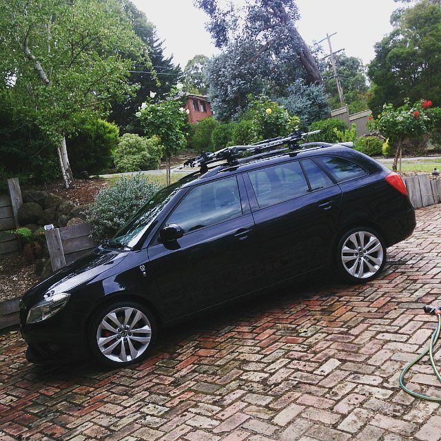

An update of sorts.. I really should take a photo since its slightly changed now.
Tinted the windows, and now running thule roof racks and bike carriers so we could take the bikes away with us over Christmas.

Photo from this morning, all shiny after her visit to the dealer.
Consider black headlights - it will really suit the rest of the car.
Yes that is on the wishlist with the grille after seeing your build thread... trying to justify the $$ spend to the other half when it could be better spent on the kids is another story :)
