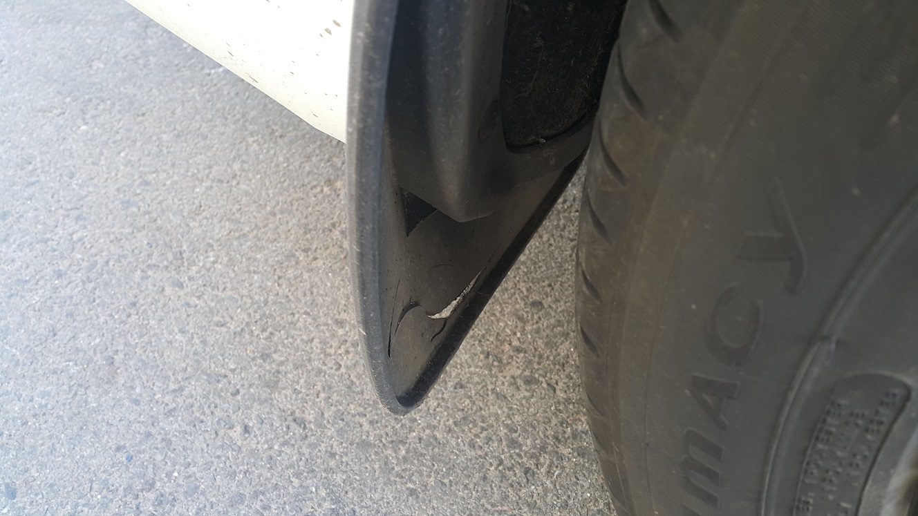

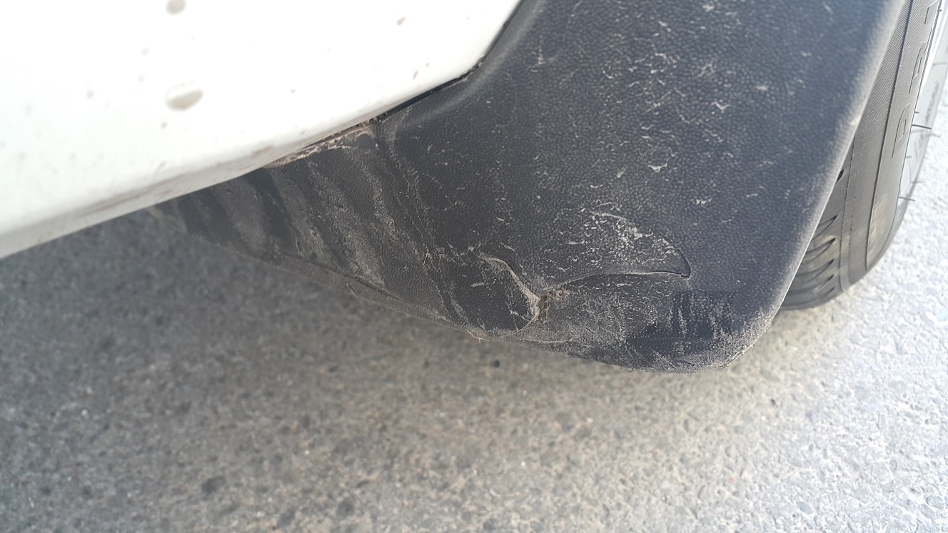

original plastic isn't enough elastic for winter season, one broke down after 20 months :(

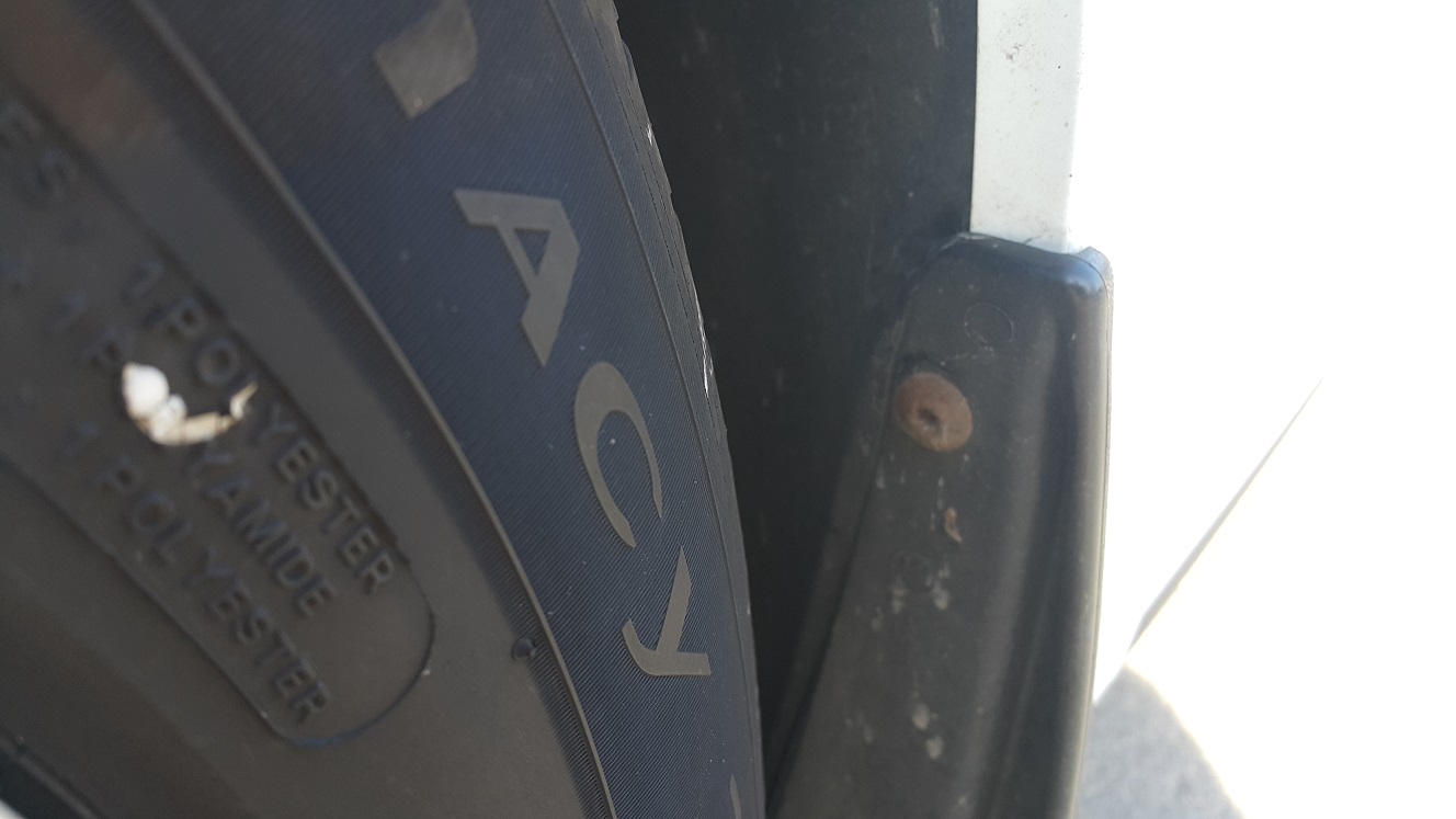

and hello first rust :(

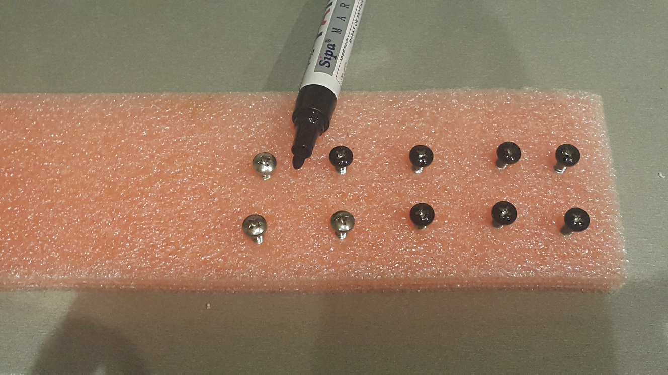

find stainless steal screws were mission impossible,
there are offered diameters 4.2; 4.8 and 5.5mm, but originals are 5.0mm
took 4.8 and painted heads
Has anyone tried a blob of silicone on the thread and over the head?
That is what I normally do when fixing on metal roofs for buildings :unsure:
Ferdinand
