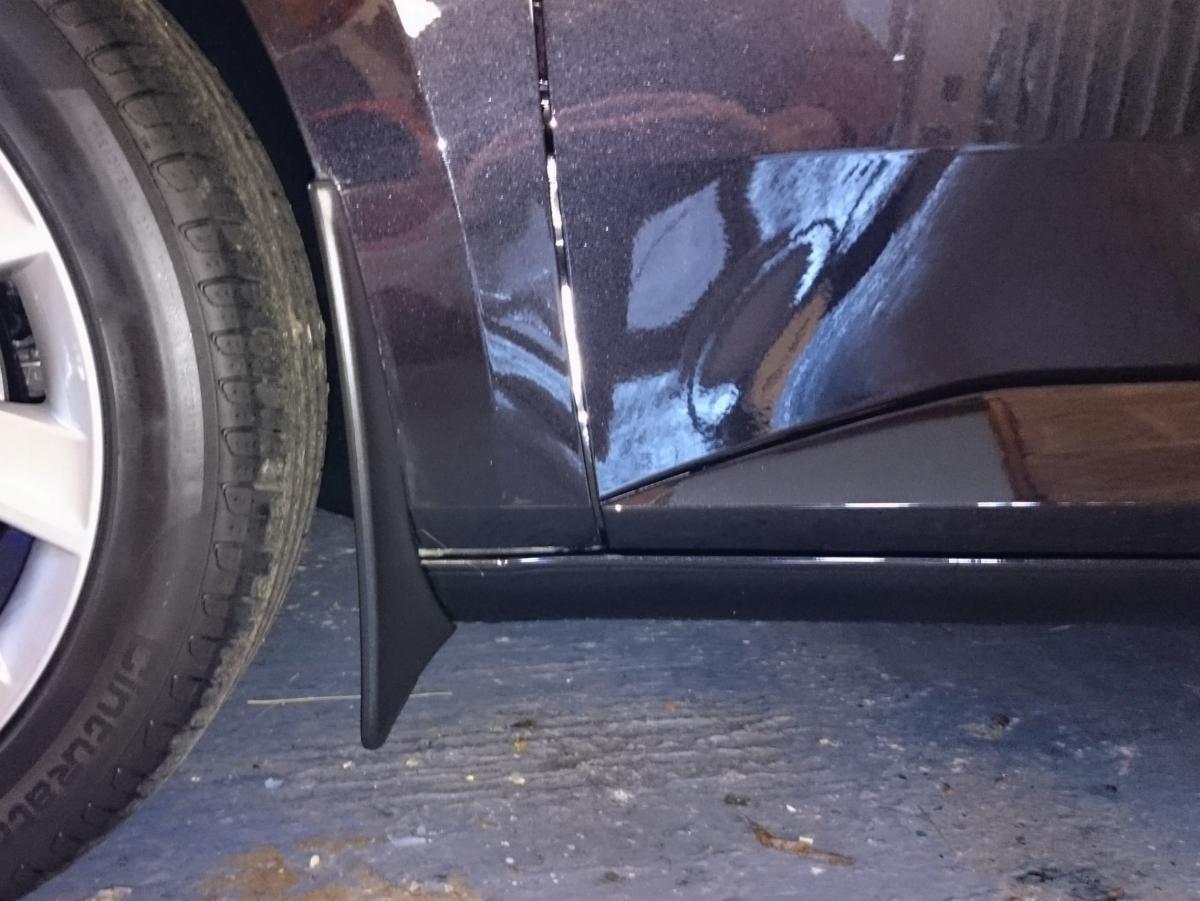

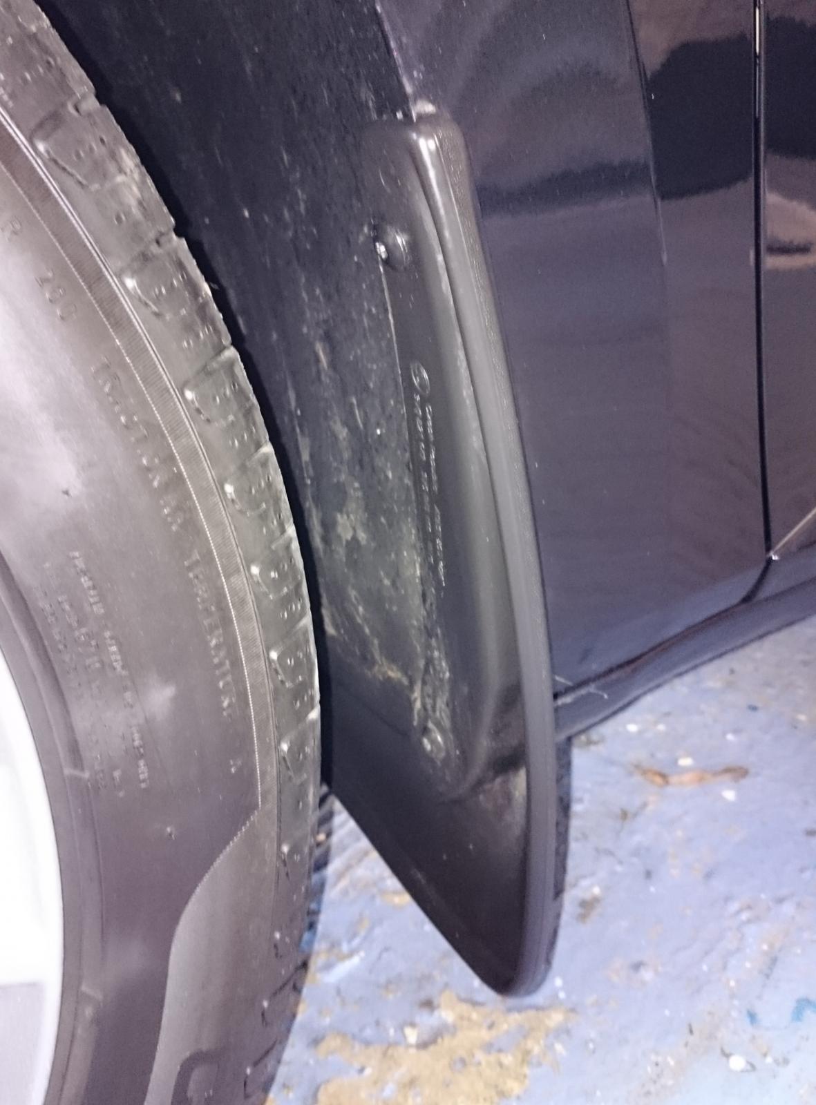

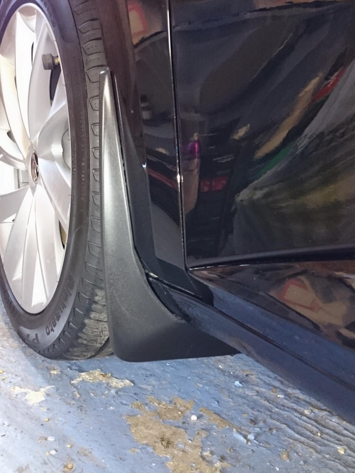

Here are the mudflaps I got from Superskoda and I had my dealer fit them for £20
post-136052-0-51825200-1453988955_thumb.jpgpost-136052-0-76286000-1453988964_thumb.jpgpost-136052-0-67066600-1453988975_thumb.jpgpost-136052-0-98037300-1453989097_thumb.jpg

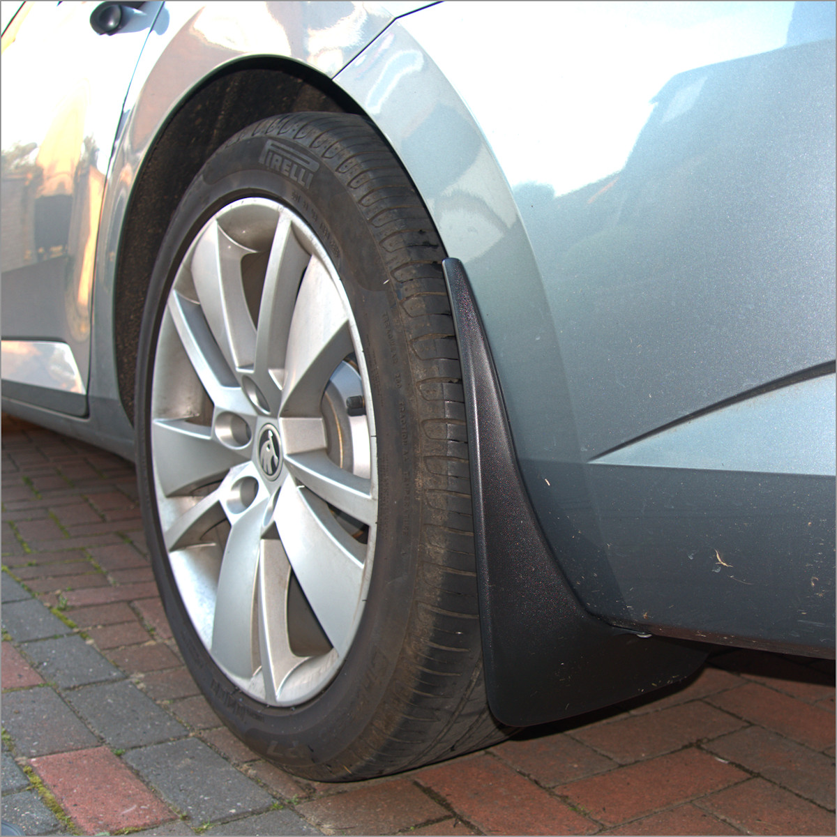

  • I've got this picture. It isn't perfect but gives you an idea of what they are like from a distance. Petrol Blue as well

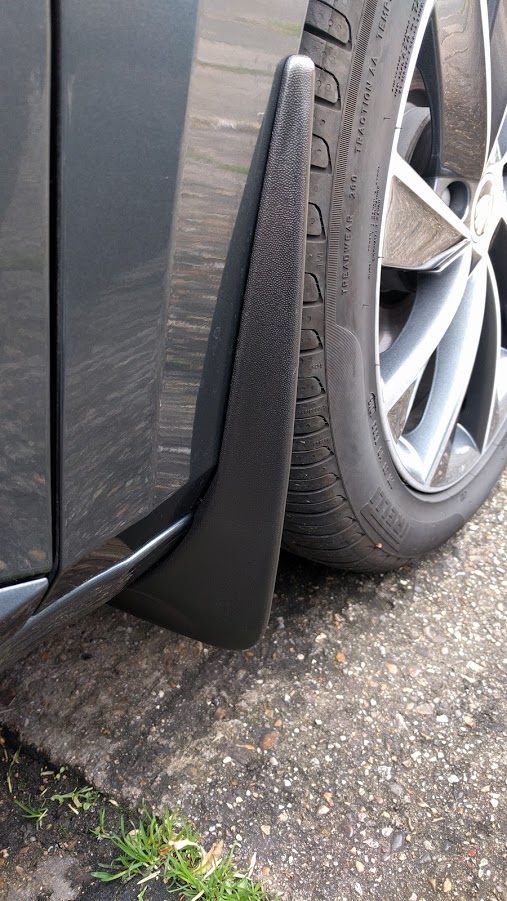

Reviving an old thread here... It seems that mud flaps would be a practical addition to the S3.
Does anyone have photos of what the car looks like as a whole with the mud flaps installed?
I'm pondering the thought of installing mud flaps on a Petrol Blue S3 hatch with 18-inch Anthracite Pegasus rims.
Thanks!
I've got this picture. It isn't perfect but gives you an idea of what they are like from a distance. Petrol Blue as well  :)
I have them on my black S2 and they blend in fine but they will stick out like a sore thumb on my S3 business grey so I'll give them a miss this time round. Down to personal choice nothing more.

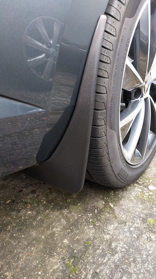

Personally I don’t think they do,
Before:
After:
Reconsidering Martin
Thank so much for the quick uploads dstev2000 and Gizmo68! I actually think the mud flaps complete the looks of the cars on 19-inch rims. Hopefully they'll have a similar effect complementing 18-inch rims too.
philpix I think the mud flaps blend in rather well with Petrol Blue and Business Grey alike!
... they will stick out like a sore thumb on my S3 business grey
Another view on a business grey S3 - I think they are pretty discreet.

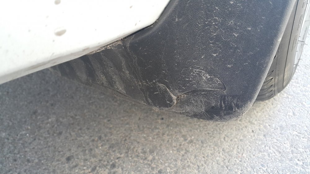

Put the rears on my estate today in sub-zero temperatures (maybe a slight exaggeration there, but it was bloody cold)
Couldn't persuade the upper plastic 'clip' to go over the bumper, and ended up snapping it off
Having said that it doesn't bring a great deal to the party, and is still very secure with the four screws
Edited by Brimma

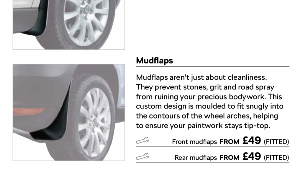

Doesn't the Škoda price include fitting or did you buy the elsewhere?
Edited by Bud
Bought from Superskoda for less than £30 for both front and rear
