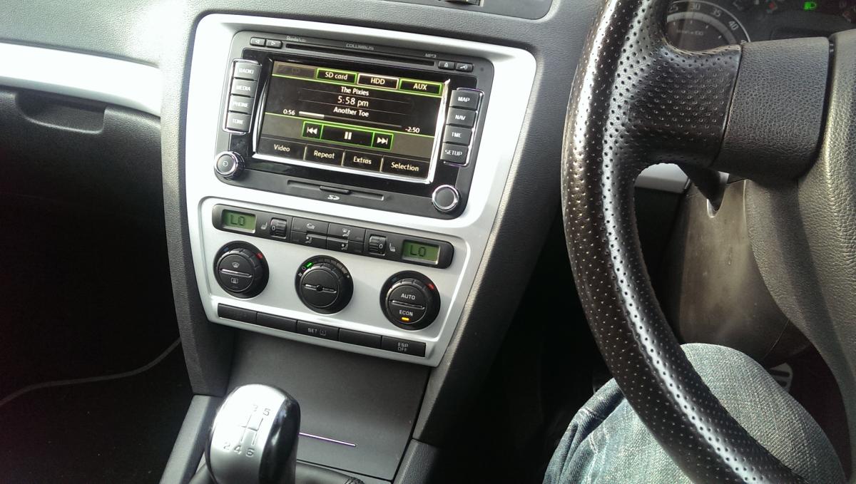

Hi after getting a Columbus head unit to replace the stream mp3 i went to skoda to get a new fascia .The standard black one was 15 euro but the silver vrs one was over 60 notes!!!!.
Taking a tip from another briskodian (cant remember who ,sorry.) i got myself a halfords can of vw satin silver paint (9€) and bought the black fascia.
/have to say im delighted with results.
standard black , a bit bland

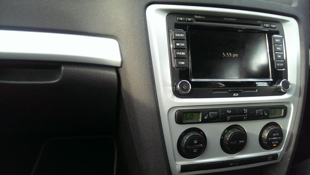

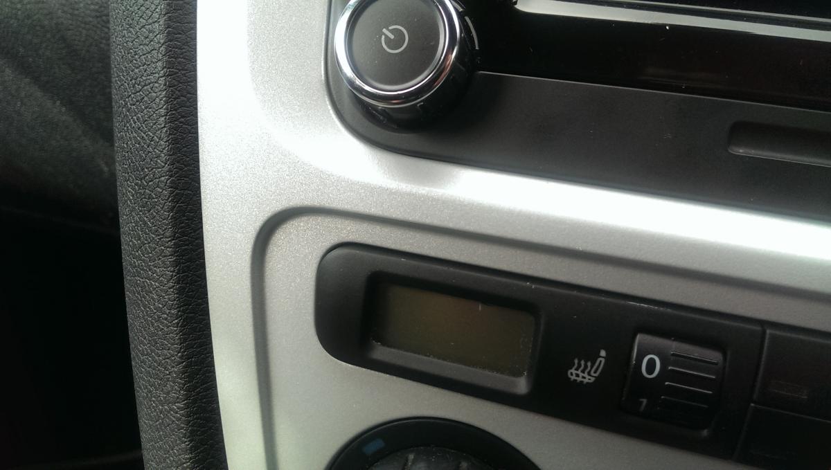

post-113846-0-85864600-1441574831_thumb.jpgpost-113846-0-11085600-1441574834_thumb.jpgpost-113846-0-12156800-1441574836_thumb.jpg
after about 4 or 5 coats

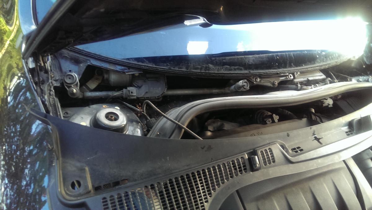

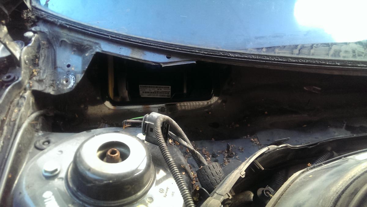

Gateway easy to change if you go in through panel here:
post-113846-0-24505400-1441575259_thumb.jpgpost-113846-0-85668300-1441576290_thumb.jpg
dont know how any one does it from under the dash.
