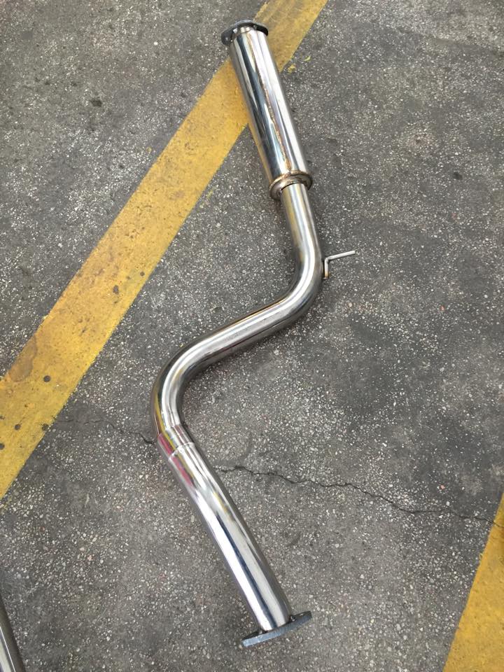

I appreciate all that, and I also got a middle resonator from the beginning (although it might not be ideally blocking the sound as it's rather a direct free-flow tube). I don't worry so much about noise when on full throttle, that's normal and actually it is not so loud at that point. What I don't stand is the drone when I am just setting off traffic lights with the throttle half-fully depressed (not racing) or normal overtaking at 80mph from 2- 2.5K rpm in 6th/7th gear. When the car builds power inside that rev range between 2 and 3K rpm, it only takes 1/3 - 1/2 of the gas pedal travel to sound overly loud. You sound like you're racing when you are clearly aren't and that's just silly. I will not say my exhaust is the best one ever built but it pretty much sounds as every other custom exhaust I have heard on 1.4 twinchargers.
From flexi pipe
Thanks geo! answered like a boss :)
