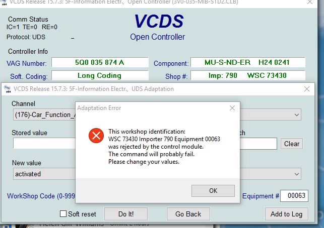

Trying to turn on drive green again with 1.5.7.3 and it's coming u with adaption error of some sort :(
here's the error message we get
Log with Ross Tech for advice, don't go changing WSC values without good reason
Sent from my HTC One_M8 using Tapatalk
Don't worry we left it alone. Too cold dark and snowy tonight. We'll reconvene at some stage when it's warmer and note the errors, grab logs etc
Sent from my Nexus 9 using Tapatalk
Thanks again to Domhnall for his help. With a couple of turn car on and off again we eventually managed to overcome the wierd error and get my drive green page back up.

So going through the "activate" in check list (posted by flybynite) we managed to get the mirror options back with no issues but then started to get the error in the screens hot when trying to turn the convenience consumer menu back on.
We changed tact and turned on the lap timer in a different channel then went back, after a couple of on/offs we successfully turned on drive green menu but then started getting the same errors and "sporadic connection" errors on the adaption screen. Everything we had turned on seemed to be working so treated what we had done as "success" and called it a night.
Be interesting what you think about the issues though.
What cable? If it is a HEX-CAN you will get communication errors, that was the root cause of the issue.
Nothing you can do but keep trying.
The Micro-CAN is a newer chipset and doesn't suffer from the connection issues.
