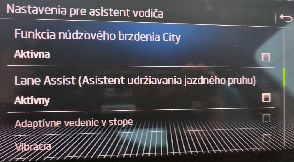

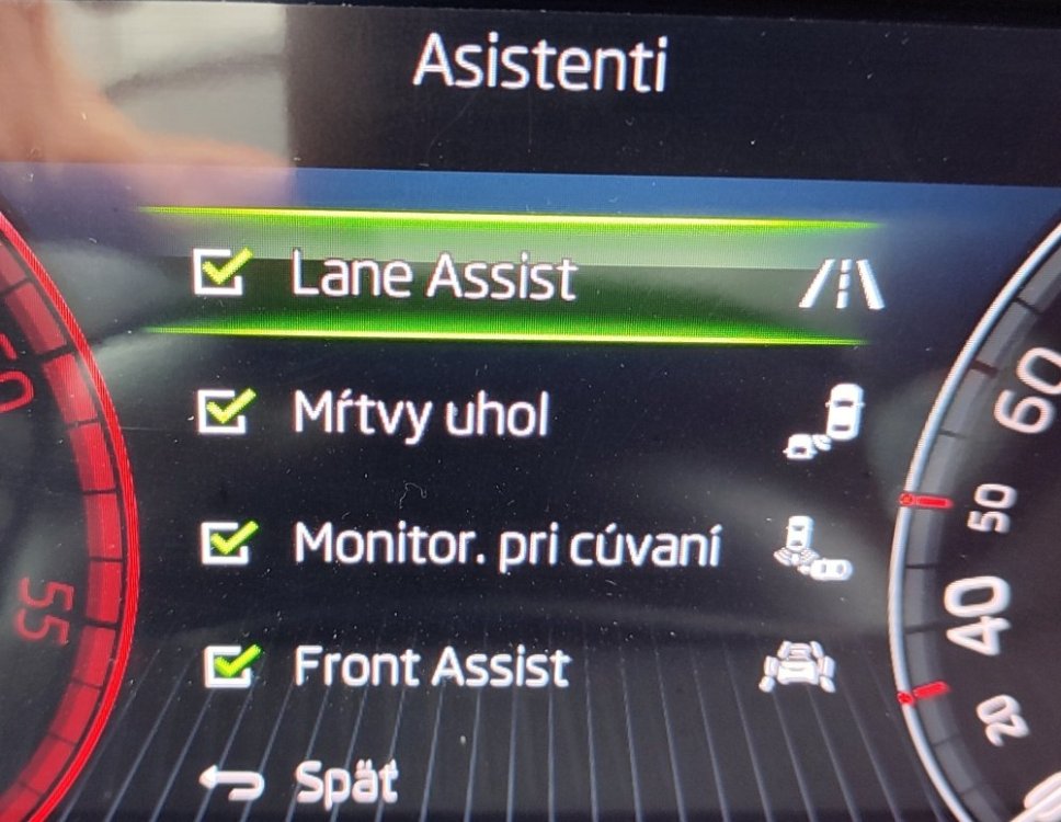

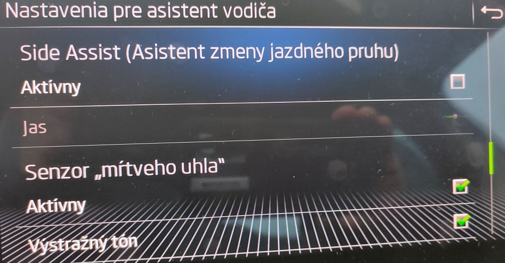

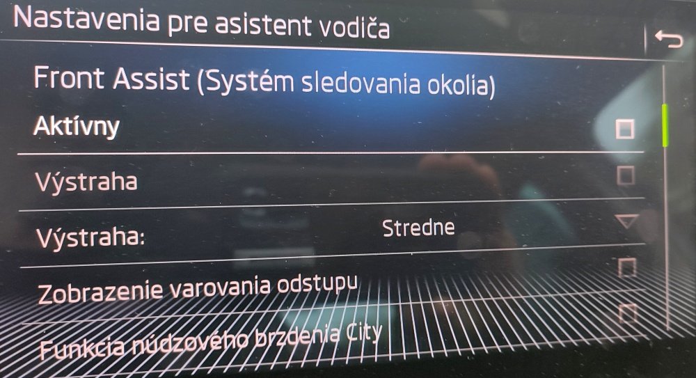

Hi guys,
I'm glad to see someone got the ball rolling, unfortunately I'm in the same boat with this issue..
I've got a MY2016 Superb 3 With columbus and DAB.
Tried to enable traffic signs with VCDS. - Getting the coding was accepted message, but no changes to it.
Since then my menu's:
Driver assistance
Drive Green View
Are gone. Everything is working though. I can enable/disable driver assistance features on the maxidot, but no parameters in the columbus, just the message access restricted when I press on Driver assistance menu
