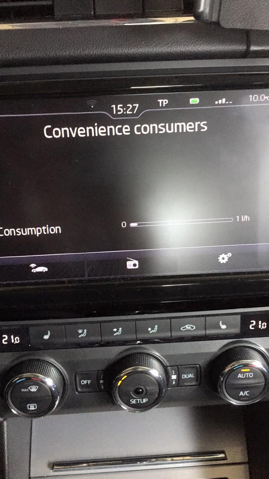

Hallo I have mounted a MIB2 columbus i my MY14 Octavia.
My Convenience consumers menu is emty. Anyone now where to code it.
​I cant find it.
I have the menu but no consumers. In my old Bolero it was. But not here.
This should solve your problem:
(181)-Car_Function_Adaptations_Gen2-menu_display_BCmE, activated
(183)-Car_Function_Adaptations_Gen2-menu_display_BCmE_over_threshold_high, activated
(67)-Car_Function_List_BAP_Gen2-BCmE_0x23), activated
(68)-Car_Function_List_BAP_Gen2-BCmE_0x23_msg_bus), Databus Infotainment
My coding is like you say.
​But no con​sumers on the list.

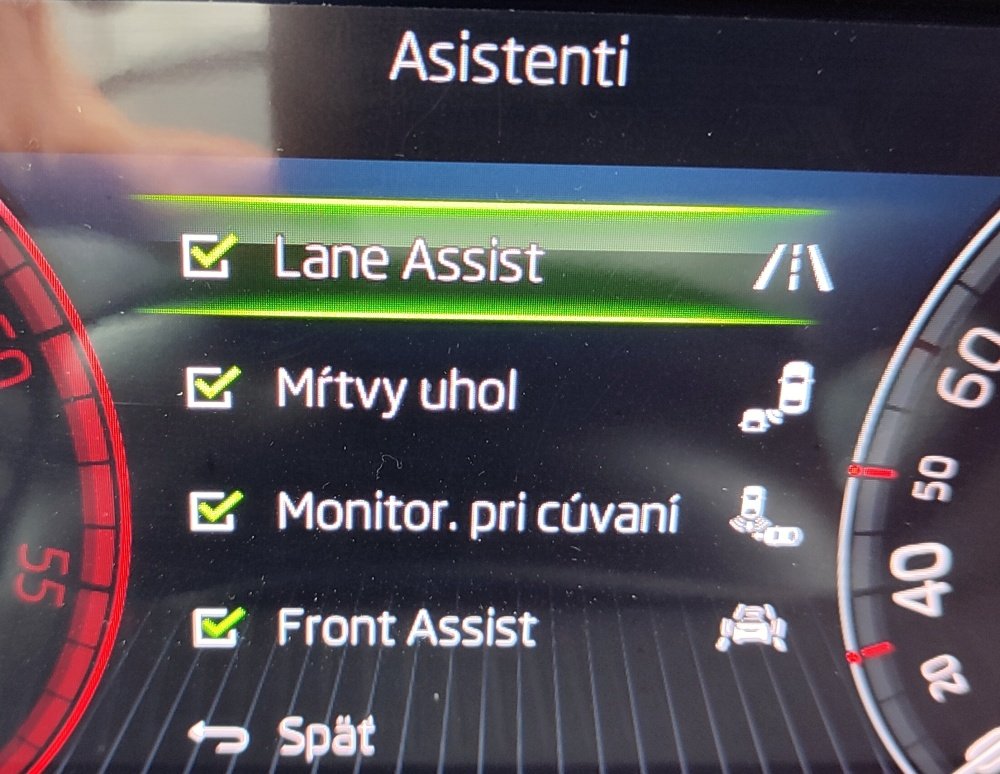

Hello, I'm opening this almost 10 year old topic. Through my ignorance, I caused problems in the Columbus infotainment in the Skoda Superb 3 model 2018.
I have a problem with displaying assistants, Line, Front and Side assist. The assistants are functional. They are displayed correctly on the virtualcockpit, but not on Columbus. After clicking on the assistant in Columbus, the voice Function not available. Can you help me how to fix it?
I probably caused it with an older version of VCDS with a HEX-CAN cable.IMG_20250507_062831.jpgIMG_20250507_062814.jpgIMG_20250507_062846.jpg

I know what change I made, I can also revert it back but it doesn't help. The error is caused by an older version of VCDS SW in combination with the HEX+CAN cable, when some adaptation channels were overwritten unintentionally. This thread was dealing with it, so I wrote here asking for help.
Has this been reported to Ross-Tech, and if so has it been confirmed that this is a VCDS HEX-CAN problem?
If it is indeed caused by this method then surely Ross-Tech are the people to ask for help as their support is excellent?
