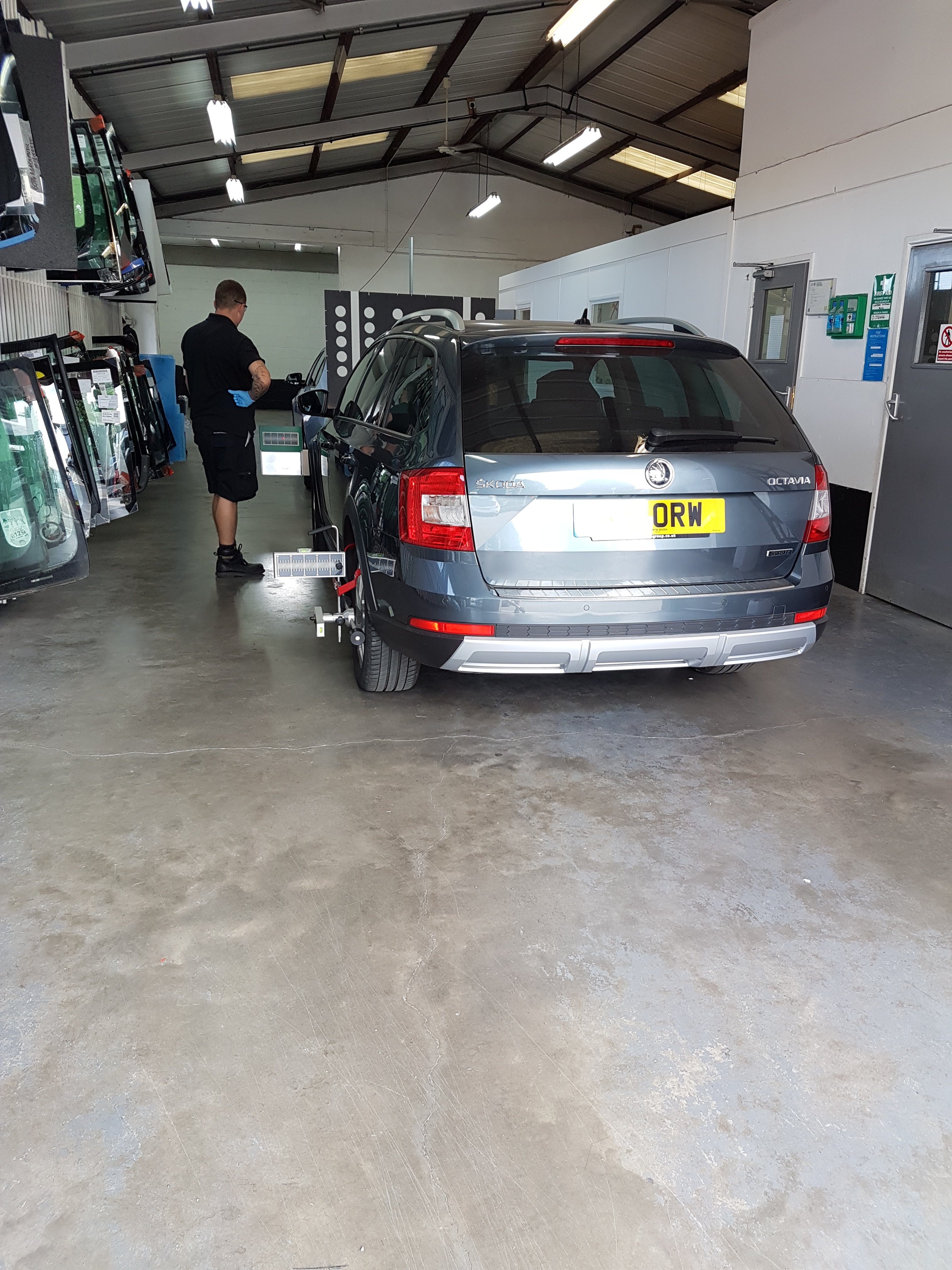

So noticed a crack this morning. Those who have had replacement and recalibration how does it work? Presumably the recalibration is beyond Autoglass and the like has to be done at a dealer. Is that correct?
Mine was done at Autoglass but it requires a visit to their workshop to carry out the calibration. It goes something like the pic below and takes a couple of hours
I was in and out of the Nottingham Autoglass Centre in 1.5 hours.

You’re wrong.  Autoglass  has the correct technology and experience and it’s done within your normal excess. The only additional expense is the cost of time and fuel to reach your nominated Autoglass repair centre. If you have it repaired at your home or place of work, a recalibration will cost you at least £125 at a Skoda dealers, as that was the cost 2 years ago. Once it’s done, drive into a decent stretch of A road or dual carriageway with clearly marked lines and Lane Assist should then work.
Did they recalibrate it there? I had to go to past Nottingham in my way to Derby.
Ah good, excellent news. I shall get it booked in.

Yes, there Centre is in Bulwell I think. Replacement and Recal done without spending too long in the Cesspit.
