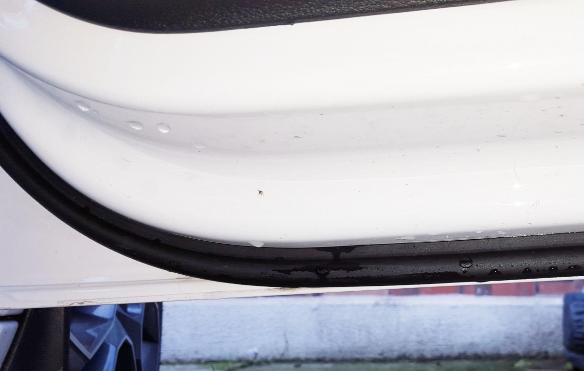

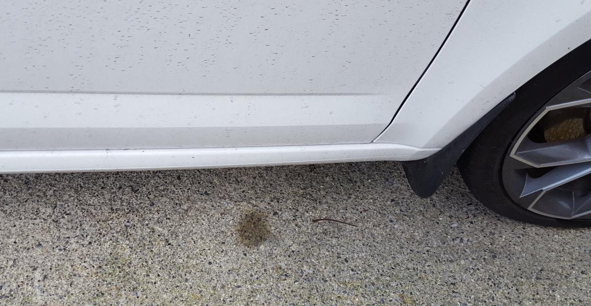

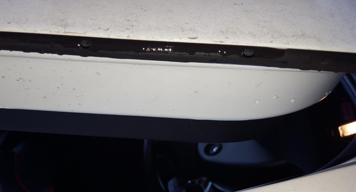

Water collecting under door
Any chance of an actual picture?
See x3 files attached
1 Outside of car showing the water run off
2 Outside of seal, note the holes are located near to the bottom of the seal (@ approx 5 O'Clock)
3 Inside of seal, note the holes are not as far apart when compared to the outside holes, also they are located at approx 9 O'Clock on the seal

  • Looking at mine Original seals: no holes on outside of seal ---*---*--- ----------- Modified seals: the holes front and back line up ---*---*--- ---*---*--- New seals: the holes are offset. Tha
  • See x3 files attached 1 Outside of car showing the water run off 2 Outside of seal, note the holes are located near to the bottom of the seal (@ approx 5 O'Clock) 3 Inside of seal, note the holes a

There is a difference between the modified and New Seals.
The mod puts a hole through each side of seal. Whereas the new seals have offset holes like my diagram above.
The fact that Skoda have reverted to New Seals must mean the Mod seals dont fully resolve the issue.
