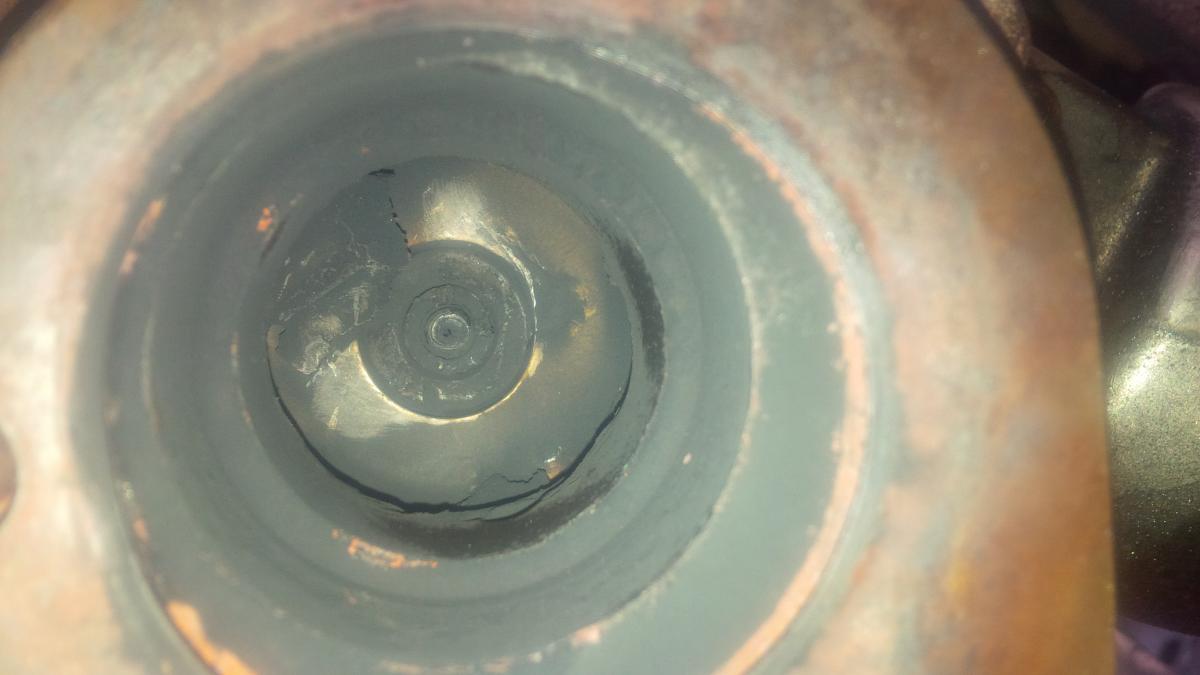

Couple photos of the old turbo...
...another KKK turbo bites the dust lol.

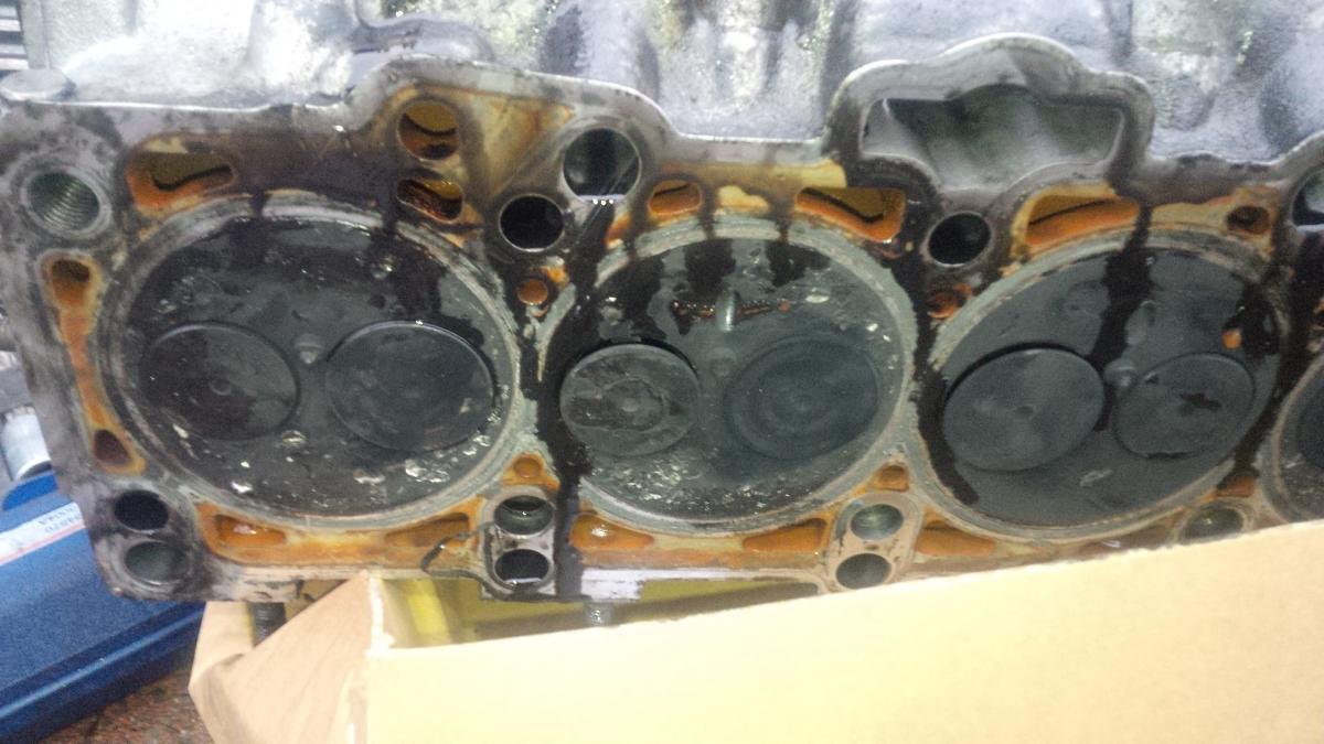

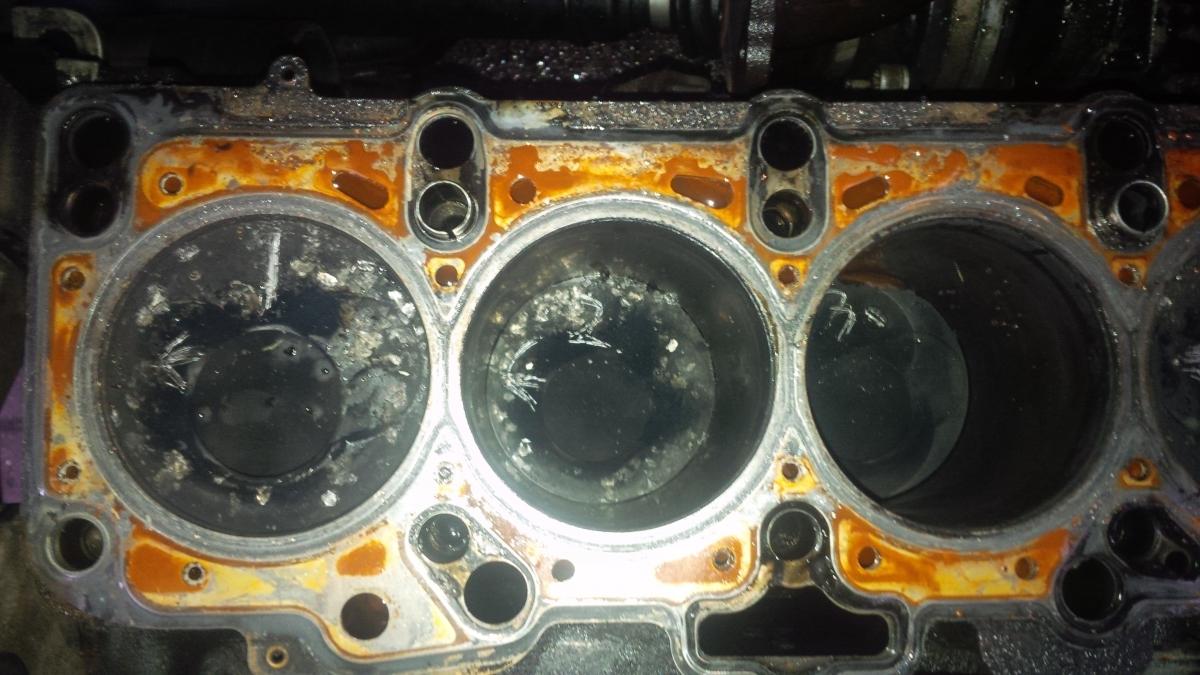

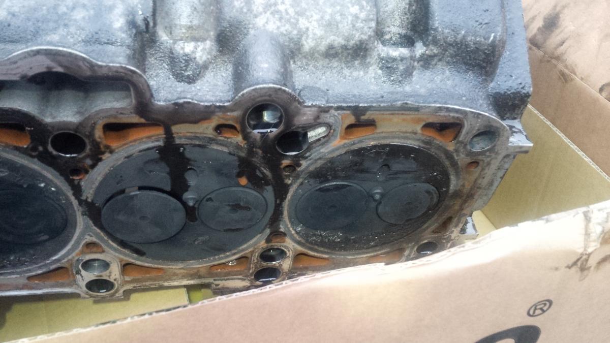

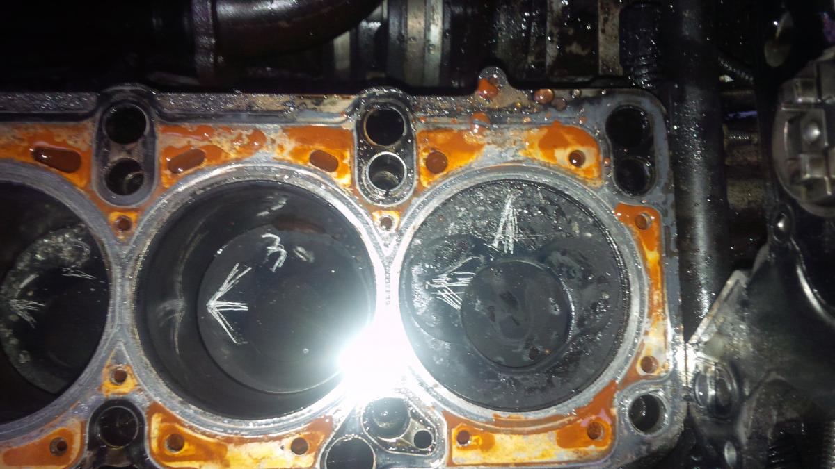

Interesting...(if that's the word) development this weekend...checked the big ends and they look as near as dammit new, so was pleasantly surprised on that front...
...lifted the head this afternoon and...well...its not good lol.
Appears that shrapnel has embedded its self in each of the pistons and in the head :S
Not from my turbo (which had its exhaust side only fail) - so presumably from the cars previous previous turbo... :S
Minor alarm bells started ringing when I was replacing the turbo and found a few different sizes of nuts on the exhaust studs...so im guessing when the previous turbo was replaced on the cheap / quick - no one lifted the head to check the state of things...
I'm now presuming that when I was driving a bit of shrapnel decided to leave the engine, damaged a valve and most definitely destroyed my old turbo :(
Absolutely amazing to think that even with a home made map the car made 175 horses on a dyno and drove in that state of tune for approx. 15k miles...
Question is...what do you think gents?
Ive not taken the pistons out yet (next weekend as I was running out of daylight lifting the head :( ), so will have a look at the bores when I do - but if they look ok, then new head (or skim old one), new pistons and rings then jobs a good un?
Will also check all the intercooler pipework and intercooler its self...find it hard to believe the engine could have ran in that state for so long...but seeing as its lots of small bits all spread across each cylinder im presuming whatever it was, was broken before it got into the engine -  hence my thinking it may have been a previously burst inlet side of a turbo....
Wow, that's a MESS.
Bad luck, there is a strong argument to just replace the entire engine and turbo with a good guaranteed secondhand unit.
You won't get a good ring seal without glaze busting the block and running in the new rings which means engine out anyway so you might as well just swap the whole lump and scrap the old unit.
