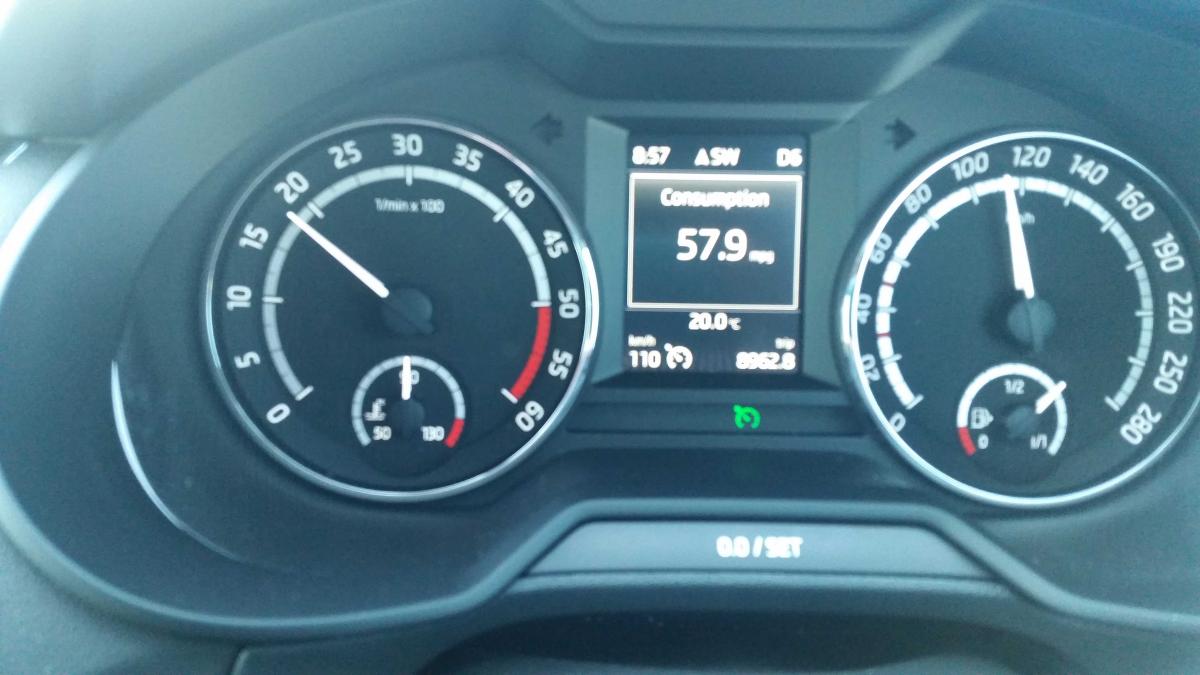

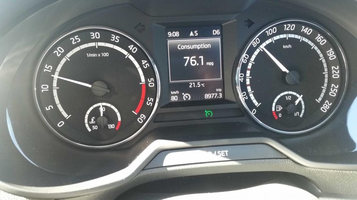

on my way to work today i switched the consumption from l/100km to mpg and attached photos are a couple of the readings at different speeds, these were on flat roads and no wind.
my average is around the 48mpg when factored in all the stop start driving and traffic holdups on my way home each night. I don't try to hyper mile or drive like "driving miss Daisy" just normal driving with the stop start function turned off, AC on when needed.
and yes this is a VRS TDI Wagon (Estate) MY 15.5 WITH 10K(ish) km.
for me to get an average in the 30's i would have to be doing the traffic light grand prix all of the time.
